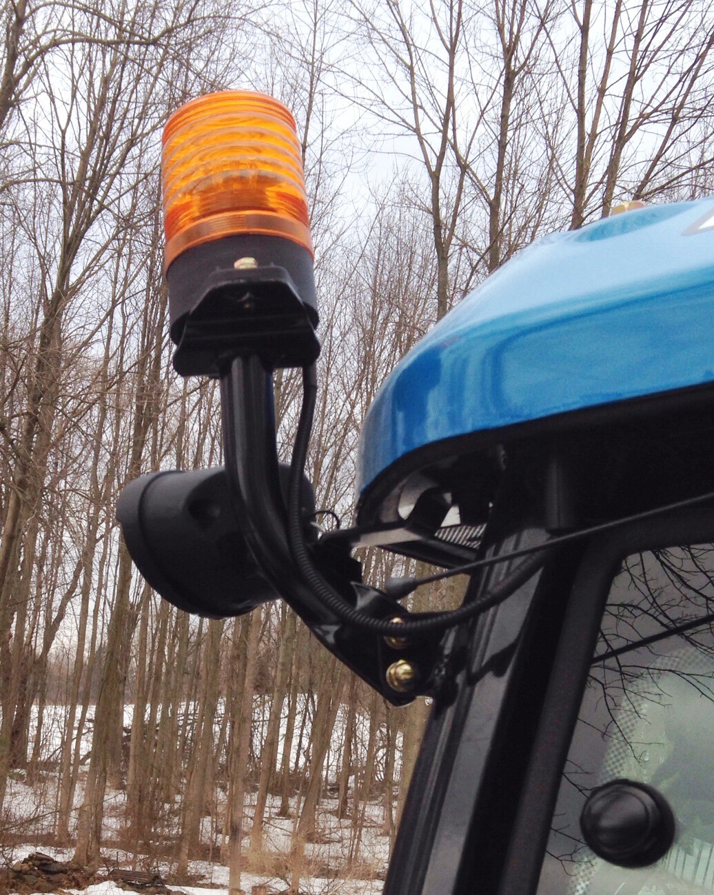

This is mine using the Hella plug:

The cover just flips and you insert plug.
BTW, CNH or NH part 86508819 12v male plug
