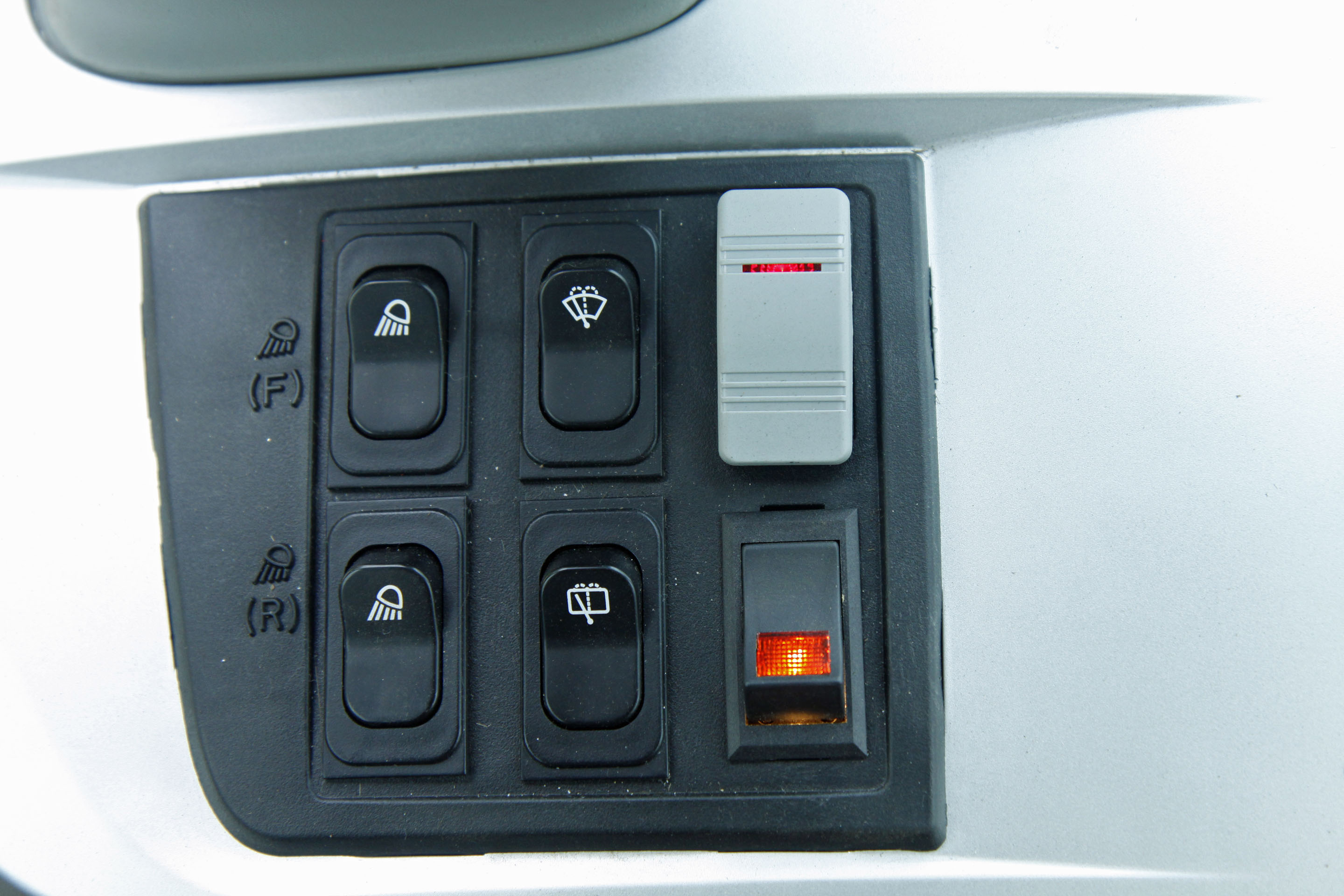

I assume coiled cord just gets plugged into cig lighter socket, but would like to have factory kubota lighted rocker switch in one of the blank spaces.

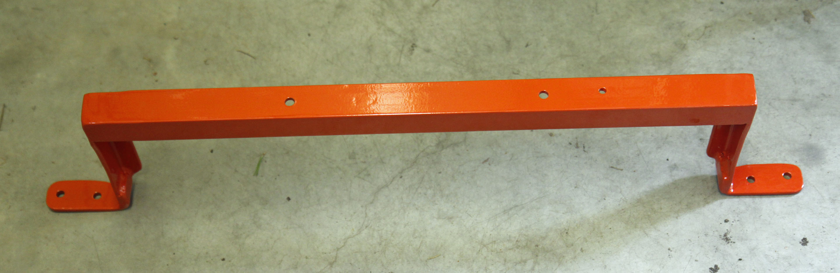

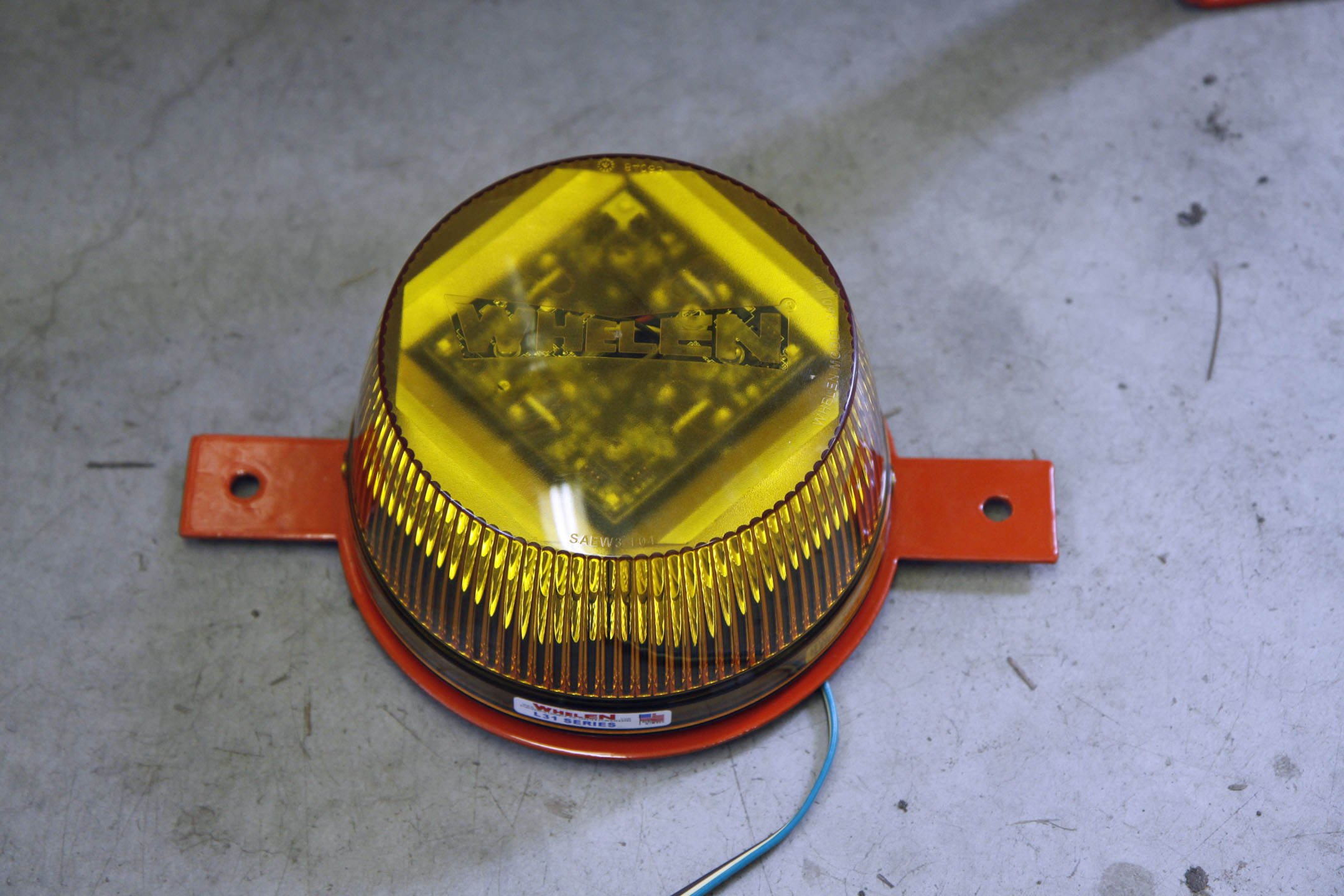

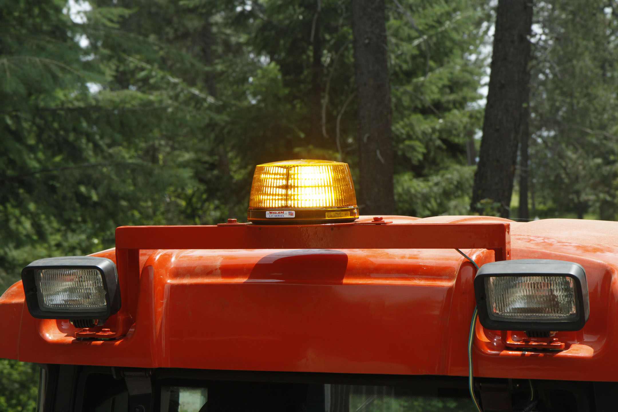

for my kioti i made a simple angle iron bracket that fit on the bolts that hold the cab roof on. then i added a standard 3 wire trailer disconnect plug and ran it down to an aftermarket lighted set of rocker switches. The Whelen flashing light i bought required 2 switches.
A similar thing should work for any type of cabbed tractor. i too shied away from suction cup. I made line so it can be easily removed from bracket for the summer. parts 1.jpglight and bracket.jpgbracket finish 1.jpgmounted 1.jpgrunning 1.jpgswitches 1.jpg

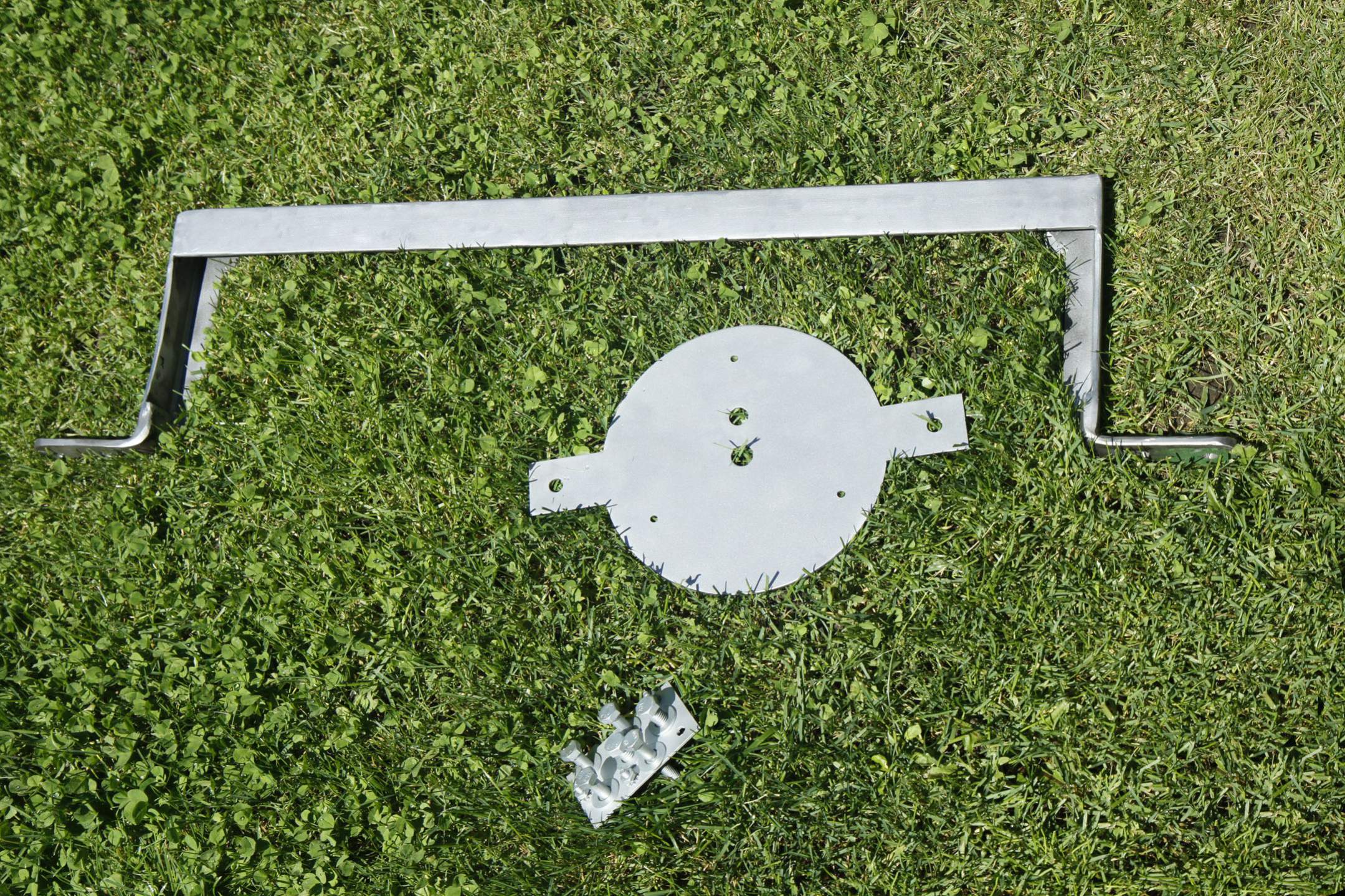

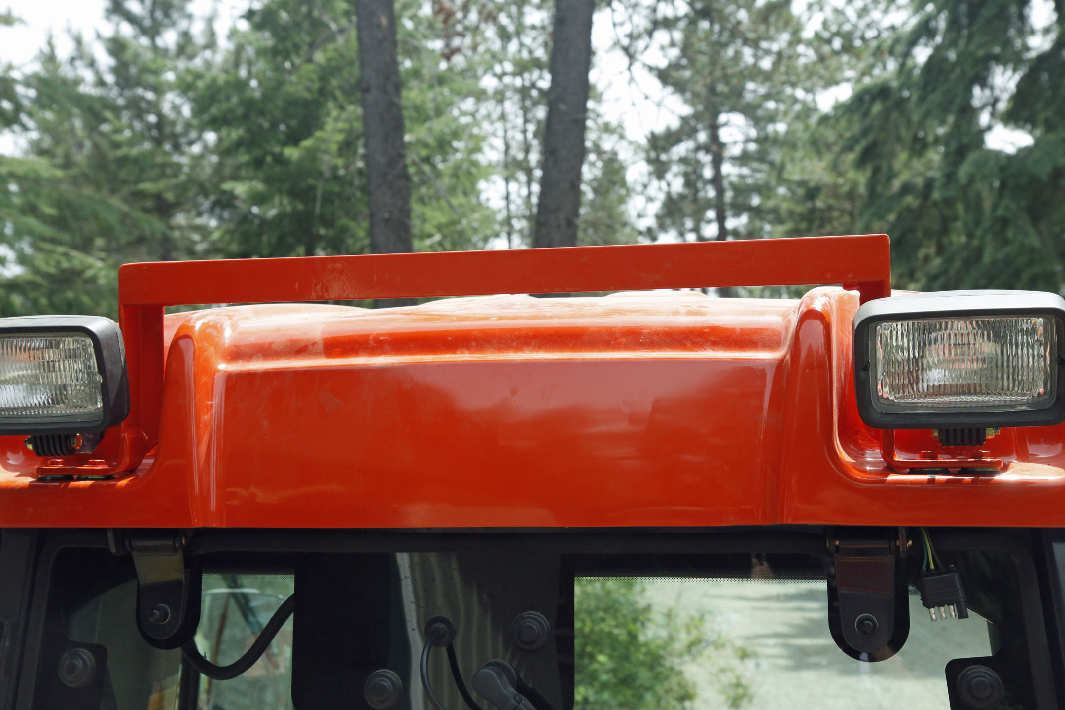

I've fabricated a coupe of roof bars for my top light. I guess its not considered a beacon but one could be attached the same way. One I built for the Kubota 4240 and another for the Kubota 5740. It is bolted to the existing bolts on the cab ans my wiring is ran down inside the cab. Works well for me.

Where are you getting your lighted rocker witches from on line?
