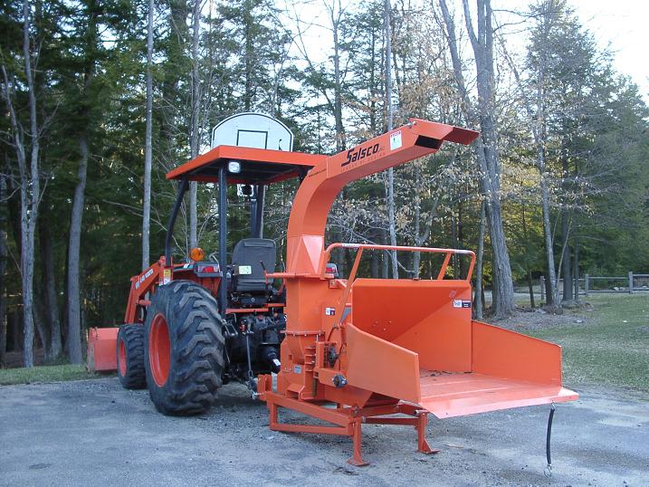

OK, one more time with the picture.

Wow David!! Great looking chipper (and rig)!

Thanks!
I'll have to get a picture of it eating - that is a really interesting sight...
