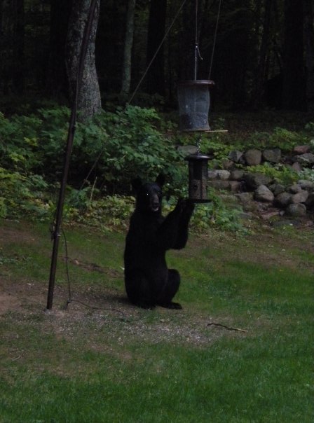

I want to build a bear proof bird feeder. We have a lot of black bears in the woods behind our property. I want a feeder tough enough that it can't be bent by a bear or knocked over or pulled out of the ground. I bought a 8' 2.5" threaded steel pipe, a 8' 2" threaded steel pipe and a connector joint that goes from 2.5" to 2". I will place a T at the top and 2' arms on either side of the pipe to hang the feeders from. I will refill the feeder by using a long pole with a hook to get the feeders down. I plan to dig down 3-4 feet and put in a 12" sonotube, put the 2.5" pipe in the center and fill it up with concrete.
I have this week off of work, and finally have time to do it. But is it too cold to do the concrete? Tonight it is going down to 29, tomorrow is 48/36, Tuesday is 53/35, Wednesday is 47/28, Thursday is 40/25, Friday is 42/24. No rain in forecast until Saturday. We have had 1 night at 32 so far, so the ground is nowhere near frozen. It was 55 yesterday, 42 today.
If I dig the hole tomorrow and do the concrete tomorrow or Tuesday at the latest, will it cure properly in this cool / cold weather? I'm thinking I may be OK since it is underground and the ground is warmer than the low temp each night. Looking for someone with concrete experience who can advise. Thanks!

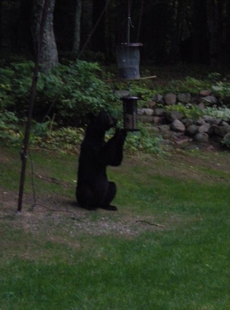

That's good size bear in your pics,if I ..I would dig down least 4+ feet,come spring time frost coming out bear rocking on the feeder might give the feeder different look.

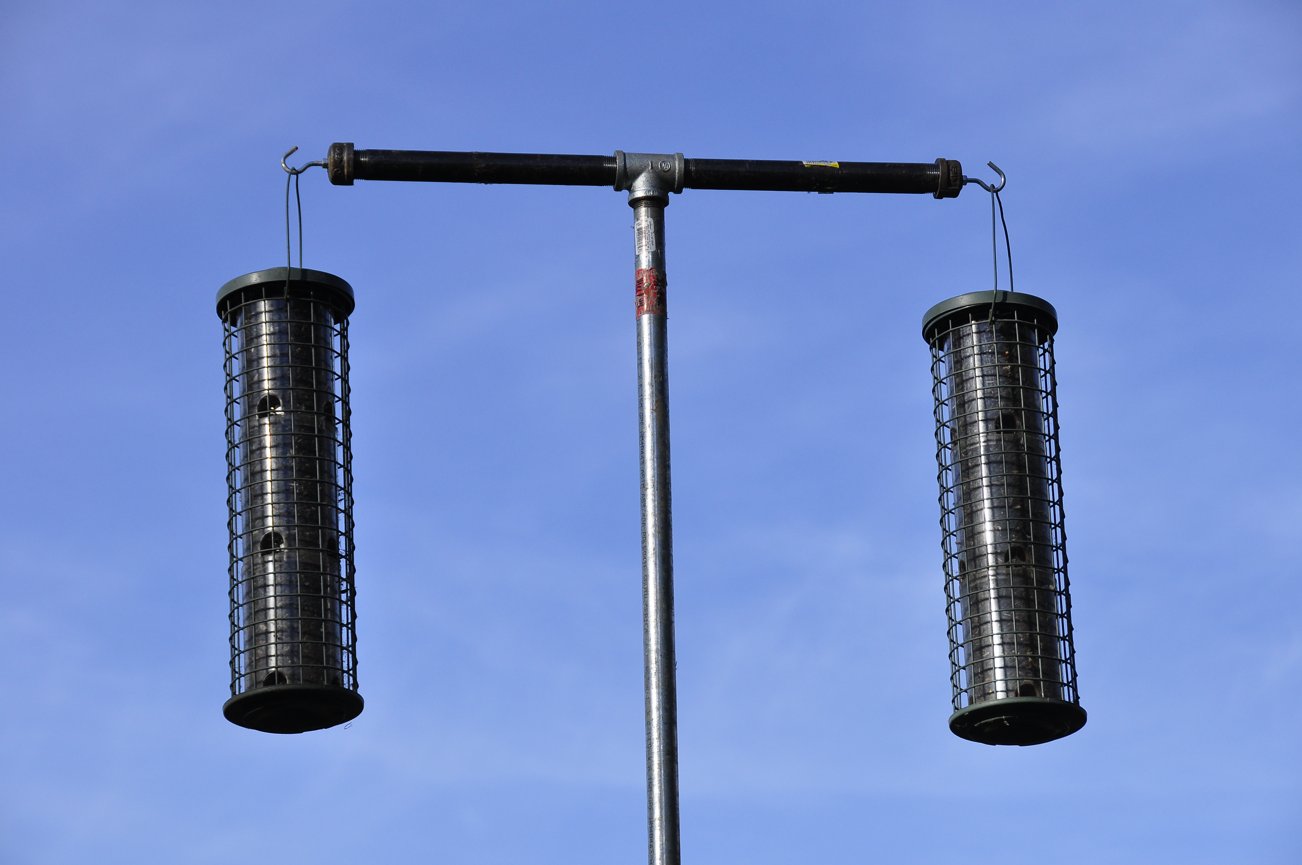

So I dug the hole down to 40", put in the sonotube and poured 300 lbs of concrete. I have the first piece of the bird feeder pole in the concrete being supported by 2x2's to keep it straight up. I checked my first pipe, and I have a 10 footer, not an 8 footer, so the feeders will be 2 feet higher than I initially reported. The bottom of the feeder will be at least 10 feet off the ground.
Its going to be sunny and 55 tomorrow and sunny and 49 on Wednesday and won't go below freezing until Thursday night. So hopefully the concrete will set during the next 3 days.
The bird feeder is inside a 4' high fence, and we won't put out any feeders until the winter hits, so hopefully the bears will be hibernating by then. I pull the feeders in every night as I don't want to attract bears. If a bear decides to climb the outer fence, I will consider adding a hot wire to the top of the chain link fence. FYI, the pics I posted of the bear climbing the fence is a 30" fence for our dogs. The 4' fence was not in when those pics were taken.

Now that the well has been fixed, and I no longer need the well puller tool, I had time to mount it on the base pole and finish the bird feeder today. Should be ready for winter. The wooden pole leaning up against the feeder pole is 8' long and has a hook on the end so I can get to the feeders.
