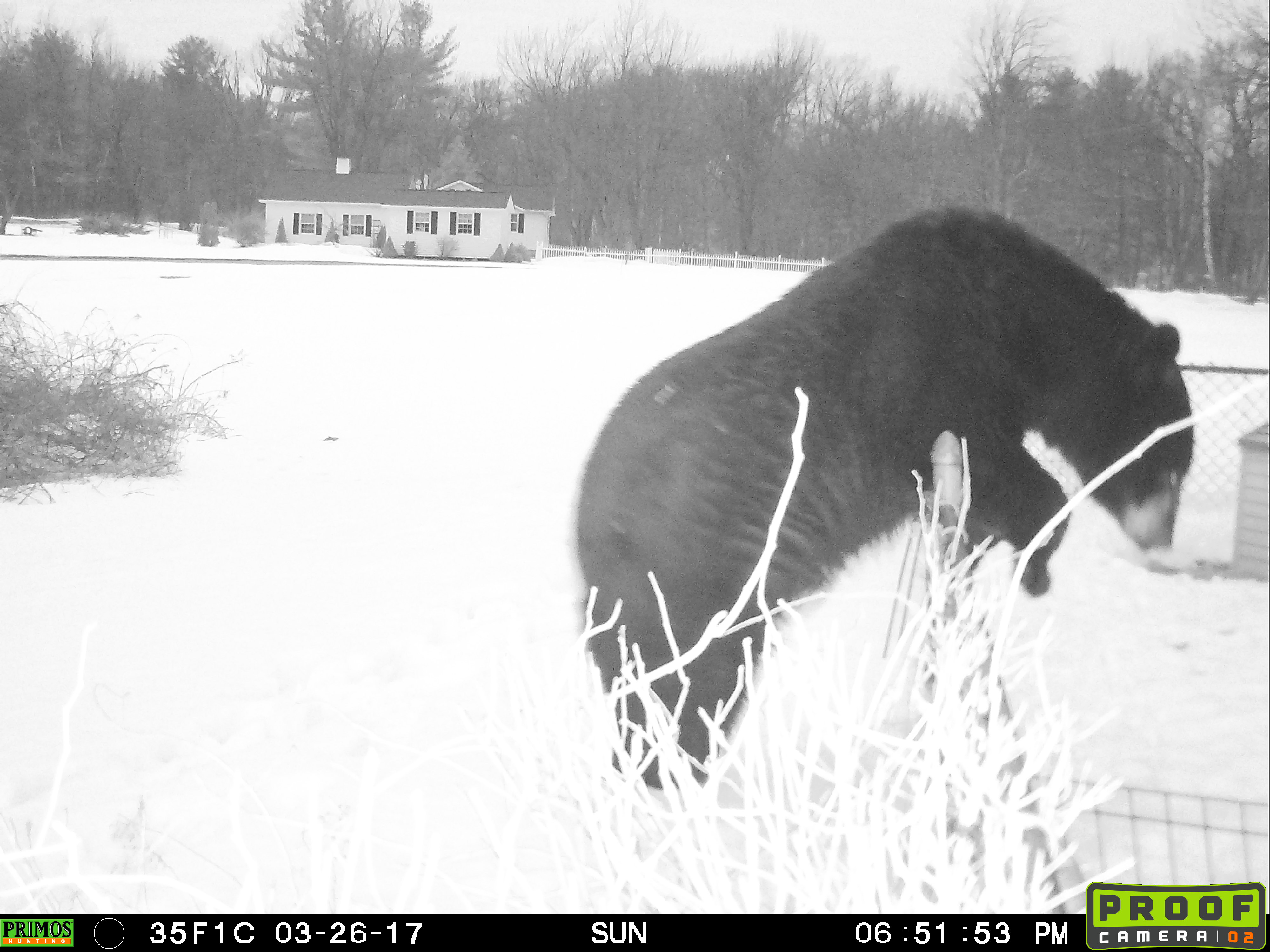

I want to build a bear proof bird feeder. We have a lot of black bears in the woods behind our property. I want a feeder tough enough that it can't be bent by a bear or knocked over or pulled out of the ground. I bought a 8' 2.5" threaded steel pipe, a 8' 2" threaded steel pipe and a connector joint that goes from 2.5" to 2". I will place a T at the top and 2' arms on either side of the pipe to hang the feeders from. I will refill the feeder by using a long pole with a hook to get the feeders down. I plan to dig down 3-4 feet and put in a 12" sonotube, put the 2.5" pipe in the center and fill it up with concrete.

That's good size bear in your pics,if I ..I would dig down least 4+ feet,come spring time frost coming out bear rocking on the feeder might give the feeder different look.

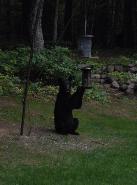

there are accelerators that you can add to the concrete mix to speed up the curing process.......I'm not crazy about using them as it will weaken the concrete a bit but in your case it's just a pole sitting in the ground.......personally I think you're fighting a losing battle as once a bear knows there is a source of food it will find a way to get it.....I think all your going to do is make it mad and you sure don't want a mad bear hanging around your place.......lol......we have the same problems with bears and what works is I wait for the hard freeze to set in usually by mid-december before I put out the bird feeders as by then the bears are hibernating.....I bring the feeders inside each night......I'll stop putting them out when it starts to warm up around end of march to mi-april as the bears will start to be moving around by then......a side benefit to doing this Is each morning I have a whole assortment of birds squawking and chirping waiting for me........lol......Jack

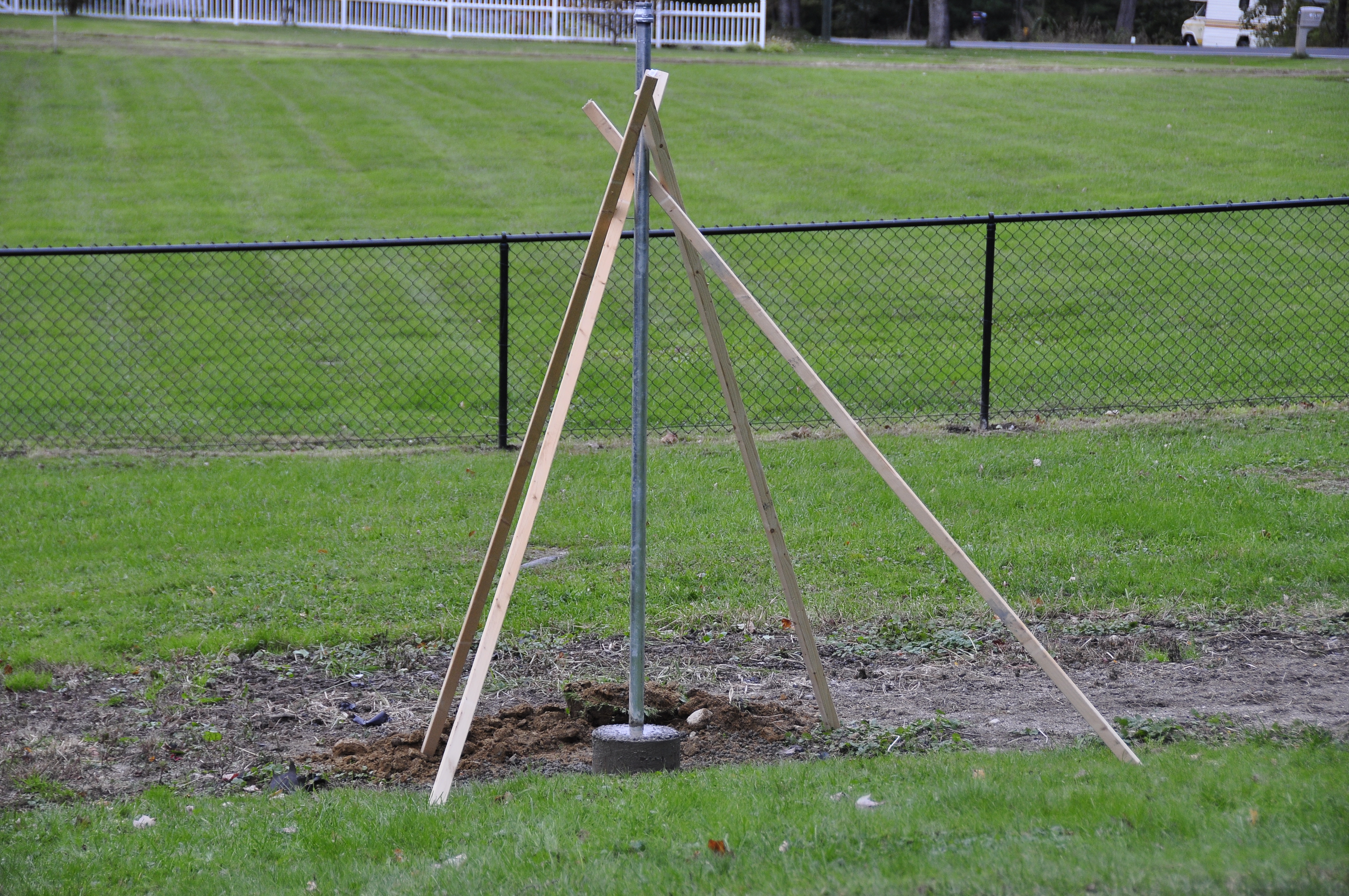

So I dug the hole down to 40", put in the sonotube and poured 300 lbs of concrete. I have the first piece of the bird feeder pole in the concrete being supported by 2x2's to keep it straight up. I checked my first pipe, and I have a 10 footer, not an 8 footer, so the feeders will be 2 feet higher than I initially reported. The bottom of the feeder will be at least 10 feet off the ground.
Its going to be sunny and 55 tomorrow and sunny and 49 on Wednesday and won't go below freezing until Thursday night. So hopefully the concrete will set during the next 3 days.

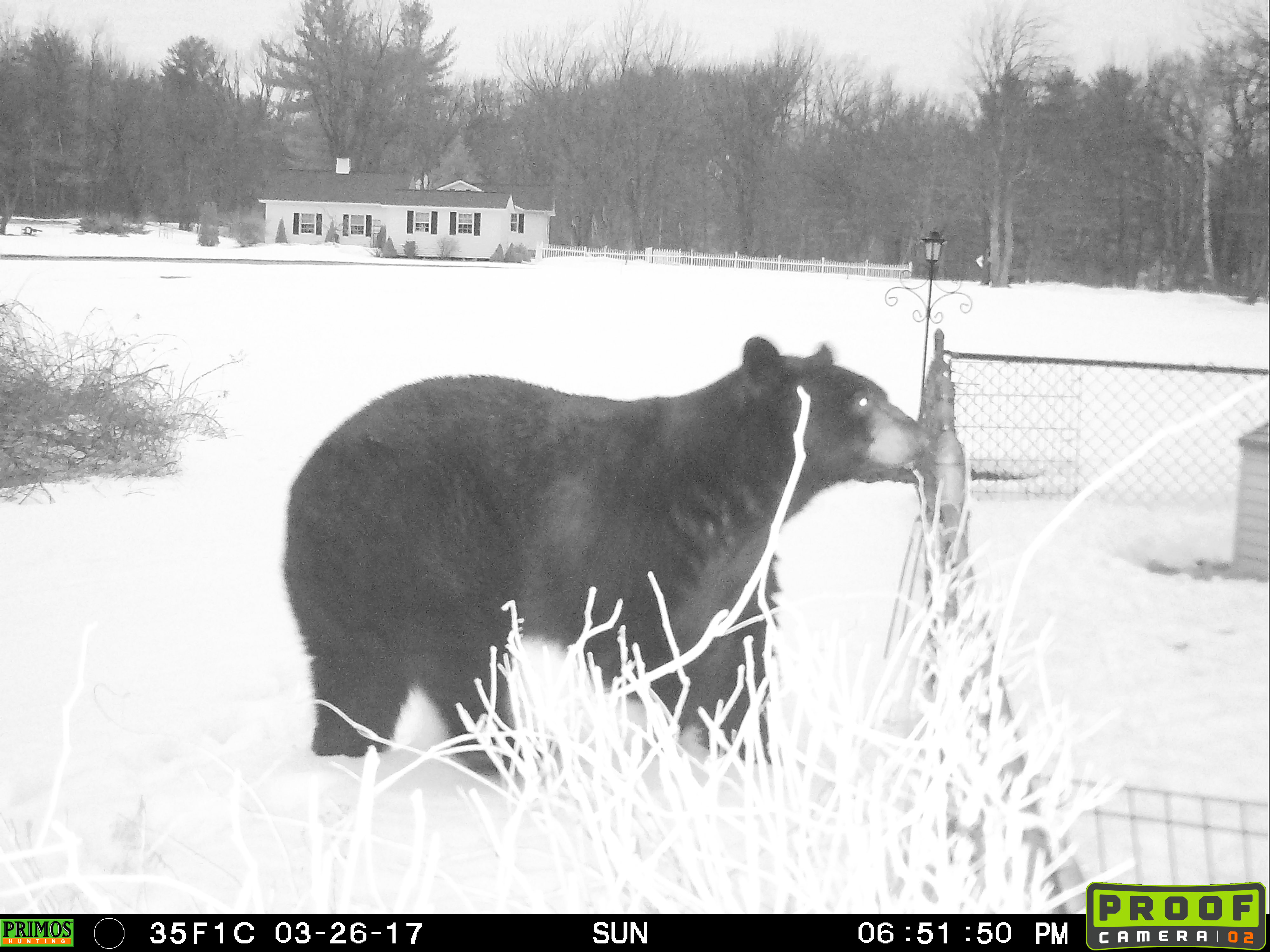

The bird feeder is inside a 4' high fence, and we won't put out any feeders until the winter hits, so hopefully the bears will be hibernating by then. I pull the feeders in every night as I don't want to attract bears. If a bear decides to climb the outer fence, I will consider adding a hot wire to the top of the chain link fence. FYI, the pics I posted of the bear climbing the fence is a 30" fence for our dogs. The 4' fence was not in when those pics were taken.
