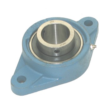

Did you read any of my post about how I removed the bearings. Did not take that long.
Two or 4 bolt flange bearing cost less then $20 each.

/ Bearcat 70554 Problems #16
1.5" Pillow Block Bearing
Bust the cast housing, knock all the bearings, take it down to the inner race.
Use a Dremel tool with cutter disc or a 4 in DeWalt side cutter and cut the race off.
You know you can do, and save yourself a bunch of bucks.
If I was close enough, I would do it for you.
Nothern tools, $16.00
pillow block bearing from Northern Tool + Equipment
Heck, for the price you were quoted for the repair, you could fly J_J to your place, have the repair done, and save some bucks.:laughing:

The flywheel is 125 lbs and chipping generates lots of vibration. Seems like a lot to ask from a $16 bearing w/o specs. But I don't know. I am just wondering. I see 1.5" bearings in McMaster Car with specs on them that run $100 to $400 depending on the dynamic load and other things I don't understand. I guess I would not want that fly wheel to come loose when I was anywhere near it.
/ Bearcat 70554 Problems #18
You would think that since Northern Tools has been selling these bearings for about 20 years, if there were any problems they would have pulled the product.
/ Bearcat 70554 Problems #19
That is a good point J J. I wonder how many go on such a heavy duty application. I really have no idea how suitable they are I just thought it was a reasonable question ask. They are cheap enough that you could replace quite a few sets and still be ahead as long as they didn't let the fly wheel tear a lot of stuff up if they failed.
