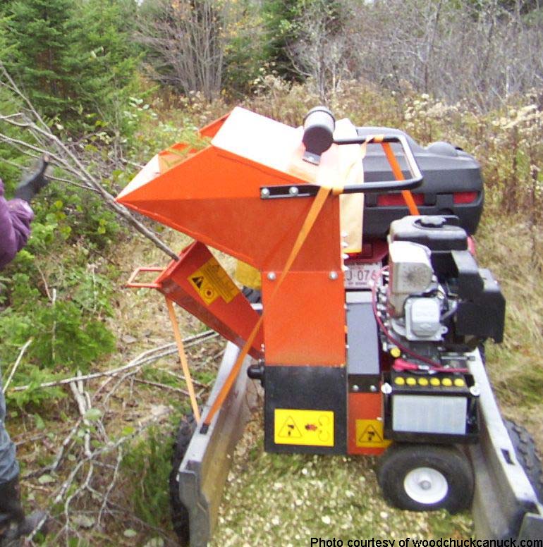

I have the Wallenstein BX42, and power it with my B2620. ... I've gotten a lot of use from mine, and like it a lot. It will feed most moderately branched limbs with no assistance. I'm cleaning up some small things in the pictures, but they were long enough to enable me to stick them in the chipper, get out my camera, and take the pictures while they were feeding themselves as you can see by the chips coming out of the chute.

Mine is my most popular attachment with my Yankee neighbors too. So far I've gotten Jams, and jellys, gift certificates at my tractor dealer, and a gift certificate for a nice meal out from letting them use it. My son brings a pickup load of stuff from his place in town to run through it once in a while too. The deal is that you can chip as you trim, and keep up with things. I will agree that it is not as much fun to chip away at a huge pile for 10 hr days. I find myself trimming things that I would have let go rather than handling the brush several times, and cutting it all up small enough to handle. Working on my new trails in the woods I just back the tractor along as I go, and when I get enough to chip, I clean it up, and go back to cutting brush.

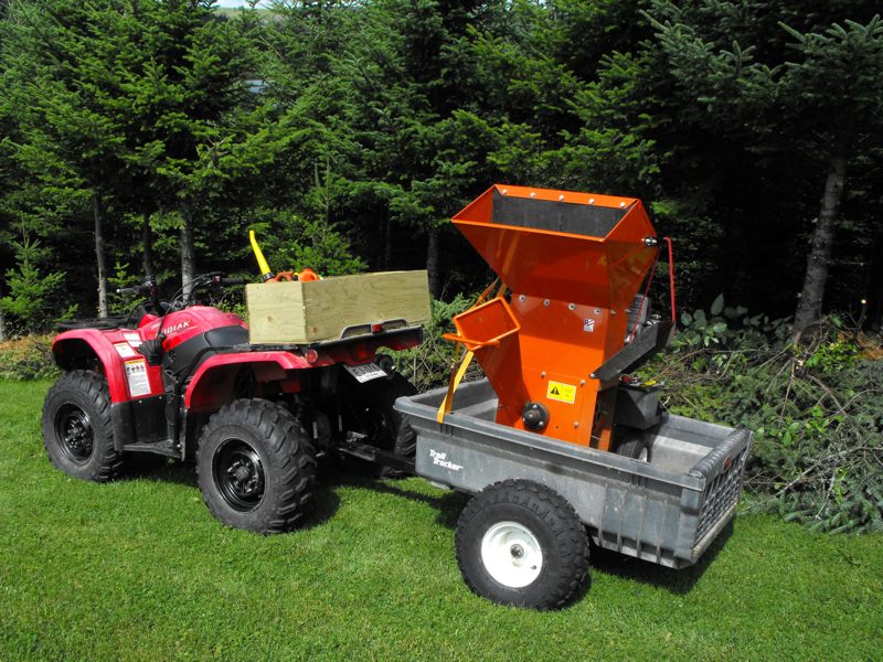

I have the Bearcat 70085. It will eat up to 3" sticks through the lower chute and shred 3/4" through the top hopper.
And yes, I like mine and get a lot of use out of it. :D 11 hours on it so far. Doesn't sound like much but if you've stood a couple hours at a chipper that is operating properly, you know who much it can go through.
