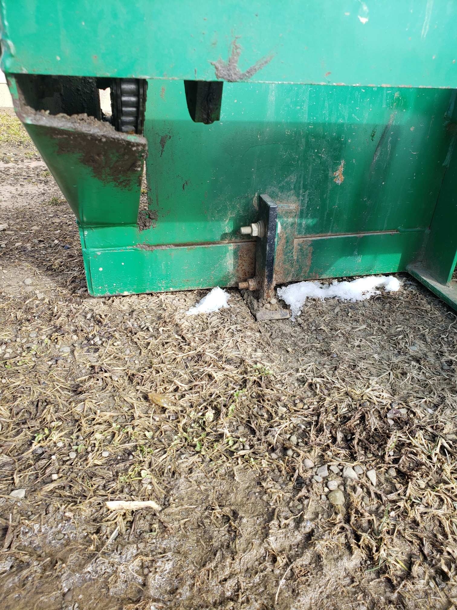

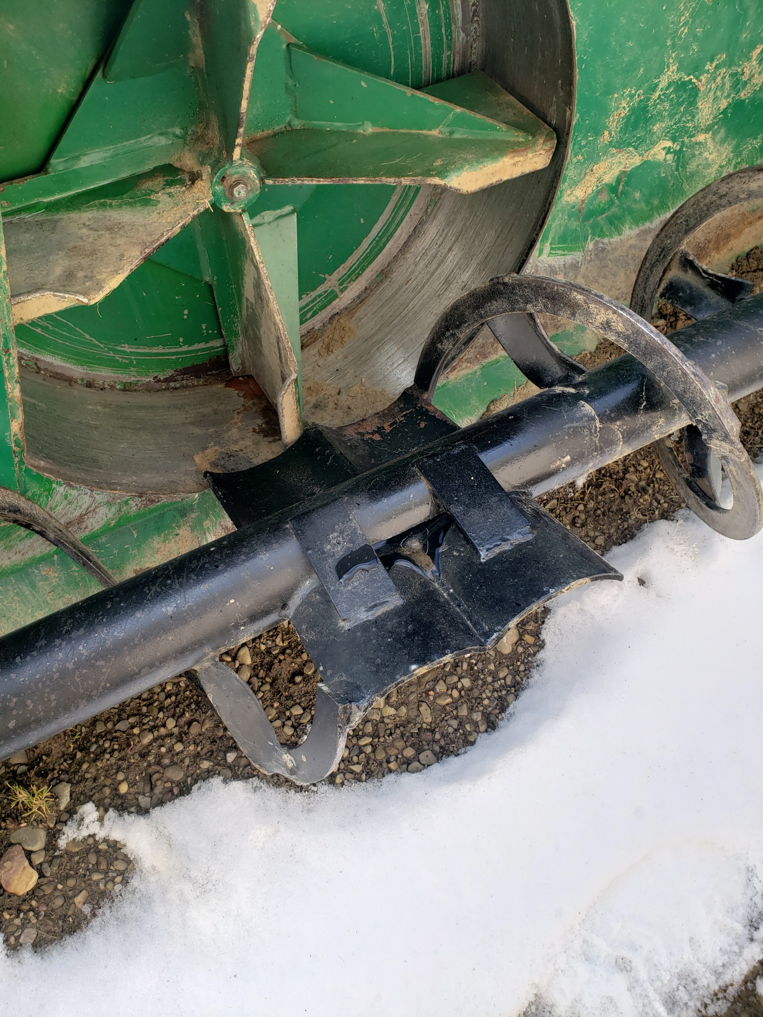

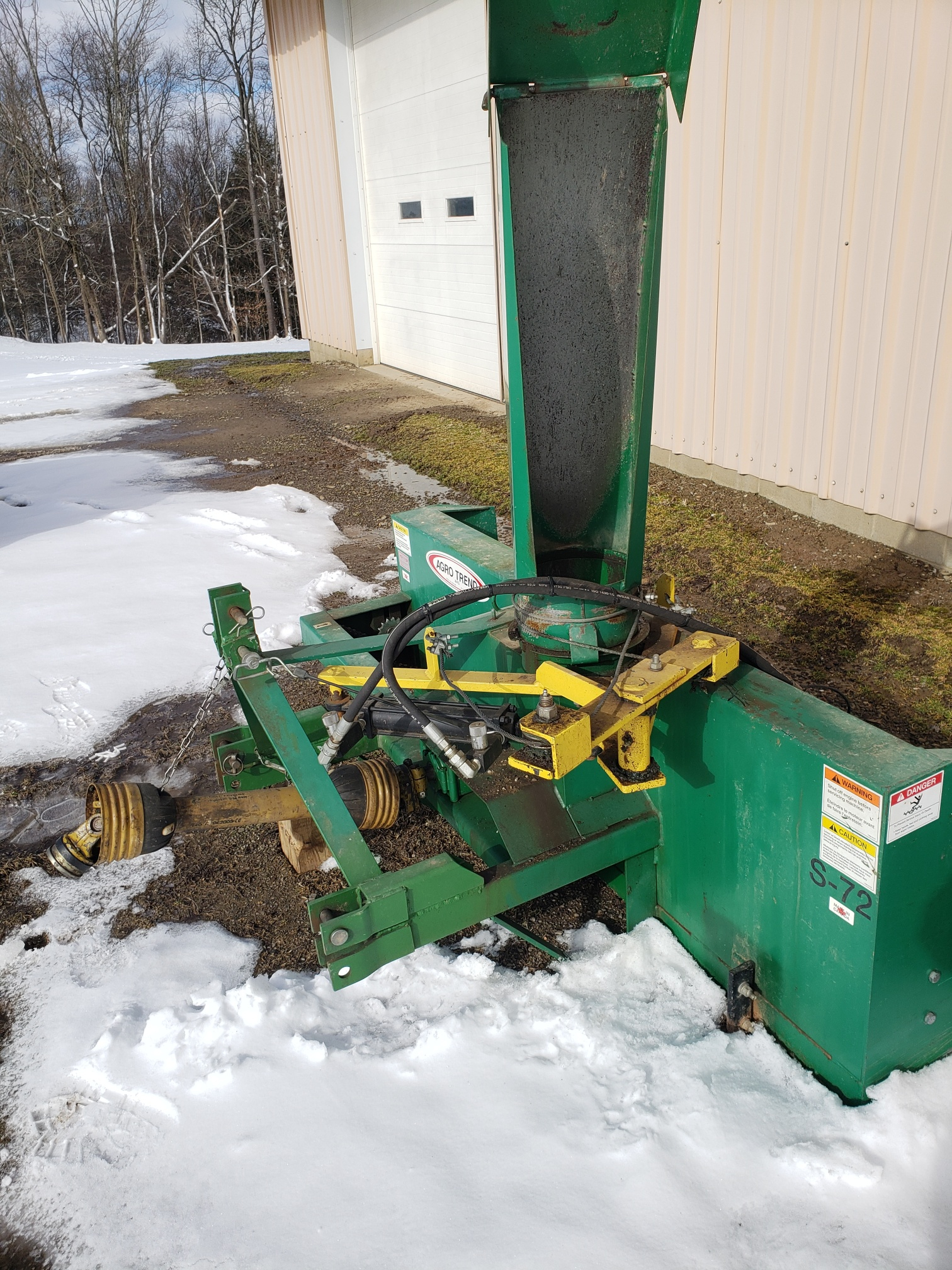

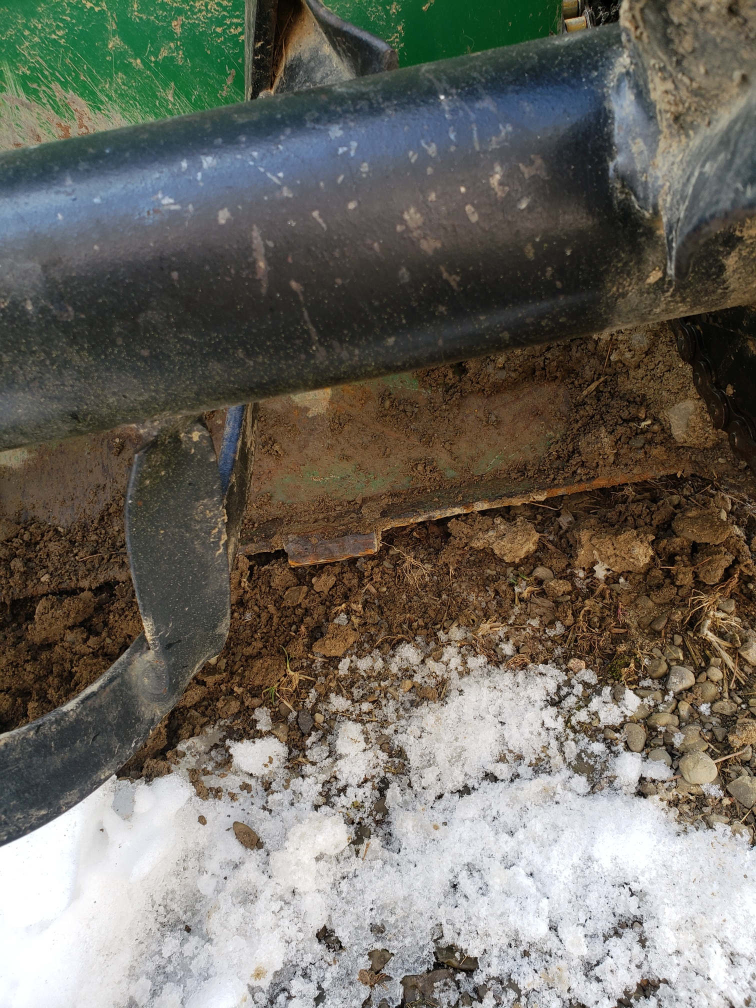

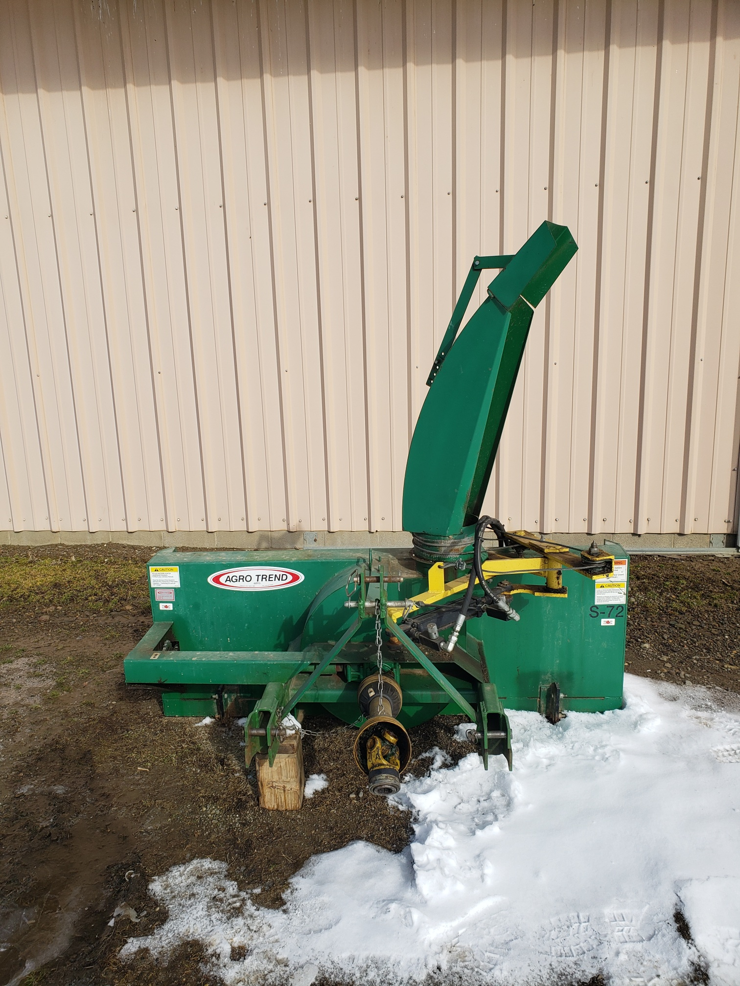

Rogerius, here are some pictures. The two new paddles on the auger were made from 4.50 pipe that I had laying around. The width was actually the circumference of the pipe cut to length. I just flattened the pipe with a sledge hammer until it approximated the original paddle arc. The new paddles with the flat bar support are butted together although they look like there is a gap. That is just a little water and some mud that distorts the picture. You can see the mickey mouse hydraulic rotator. The pulleys were in the same plane originally. On each rotation the cables molested them selves. The cables were not going to last very long. I offset them as show, added zerks and drilled for grease. The original mounting was slightly off center, so the cable tightens in one direction and come loose in the other direction. Easily fixed with a bungee. No problems for 17 yrs. I forgot to mention I added flow controls in each direction. With out the flow controls running at PTO speed, the shoot rotated at the speed of sound. I added 2 flow controls due to the piston and rod difference. As a friend of my used to say, when in doubt meter out. Now at pto speed no problems
. The shoes are on a 52" center line made from .50" X 2.0" X approx 8.0" long bar stock. The ends are bent up so they do not dig in. They are bolt on on the back side but when installing I was concerned that the auger side could get caught on something. So I welded the auger side to the cutter bar. They are worn pretty good right now, maybe less that .25" in the middle. Will need replaced later. Last is the 3 pt mounting. I just added it to the existing. It lowers the cutting height of the blower. Self explanatory.
