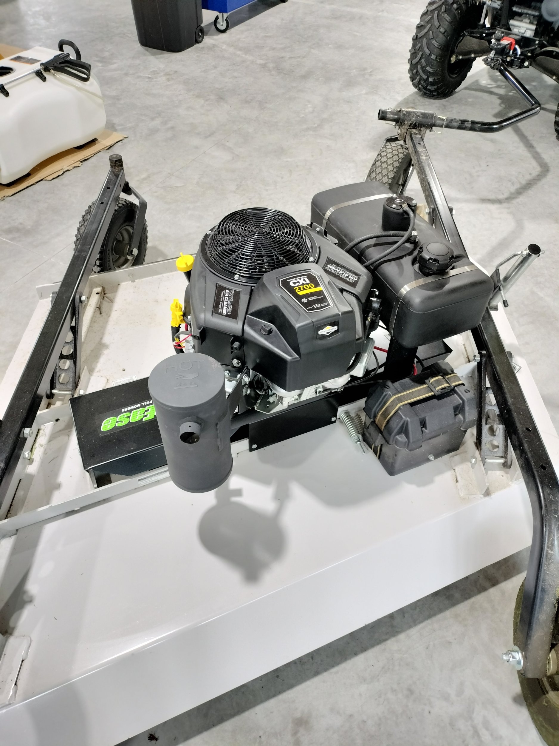

Last week my son had an unfortunate incident where the trail mower I have him run, threw a rod through the side of the crank case.
We found a new replacement with the correct shaft and alternator size... But it came with the choke a matic that starts the engine wide open, as the choke is just past full throttle.
We used the choke bell crank from the old motor and linkage, which matched perfect on the 810cc motor. Finally back in the mowing biz.
