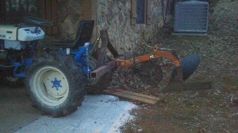

I have been slacking but here as of late i have started back on my project. I didn't have any 3 pt hitch equipment but i have quite a few pieces of sleeve hitch stuff. So after a bit of digging in the junk yard, i came across part of a tool bar. Then some new pins and drill work to make it match up. It was almost dark so the first test was only about 12 ft but tomorrow it will get to plow a friends garden. I snapped a picture but as i said it is pretty dark.

Nice toolbar. I have a Brinly plow too but don't think it is that big.
/ Beaver Re-do #27
Brinly makes 8 10 and 12" plows in sleeve hitch and 12" in cat 0 3pt. Thats a sleeve hitch plow, most likely a 12"
I have quite a few for my JD garden tractors.
I pull a 16" plow with my S373D, but it needs 4wd on and I have 150lb wheel weights on each wheel, bar tires all the way around thats all that thing can handle. A 14 would be a better fit, but it handles the 16 thus far. On a 2wd tractor your not going to be able to handle more than 10 or 12 depending on your ballast, field conditions and desired speed.
On the 3pt adjustors/lift links did you go with adjustable on both sides or just the one?

It is a 12 in plow and i have another just like it in my shop. I caught an ad on craigslist about 6 months ago where a lady was selling equipment that belonged to her late husband. I bought 2 plows, a culitvator plow, potato plow, and disc all for a sleeve hitch. i think i paid something like $150 for all of it. I thought it sounded like a pretty good deal.
This tractor is 4x4 and I have the rear wheels fluid filled. Also, my 280 lbs of me on top of that helps. I still found myself using 4x4 as it was a bit wetter then i would have liked. In the clay dirt around here, 12 in is the max i would try to pull with this tractor.
Just one side is adjustable on the lift links. I bought them from a website someone posted on here for Yanmar (i think) tractor parts. I posted about it a page or so back on this thread. They fit with very little mods. The only trouble i have had with them was they were powder coated and the ball sockets were stuck. They broke free pretty quickly with a long bar and some elbow grease.

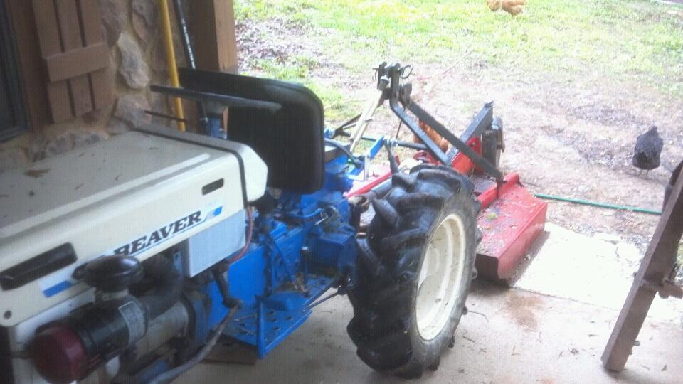

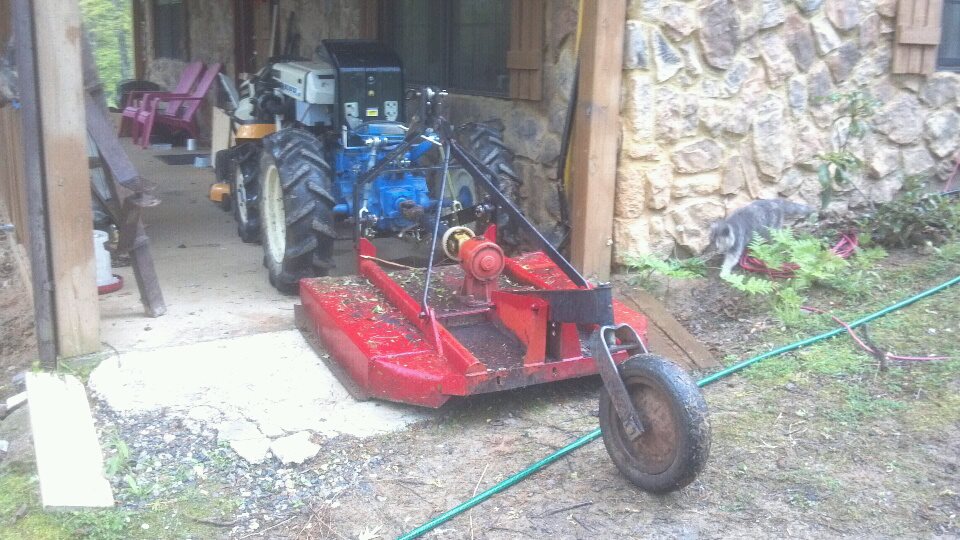

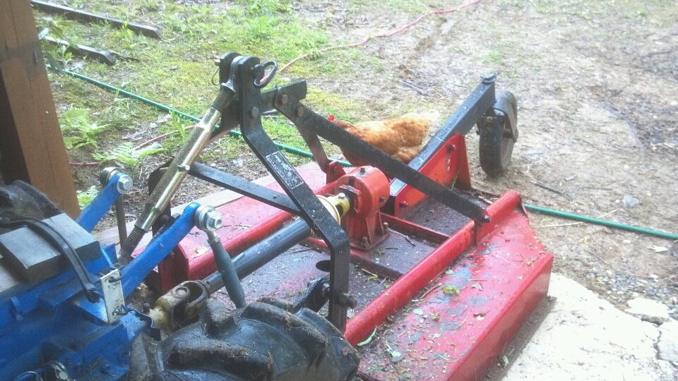

Newest addition to our farm: a 42" rotary cutter (bush hog). picked it up Saturday afternoon from Craigslist. I had to cut the pto shaft off but then it was time for a spin. I learned really quickly what "live pto" means. So i will be shopping for a one way clutch very soon. Over all, I am very glad i did not go with a bigger cutter. This one already will lift my front wheels at times.

Nice looking mower...you"ll likely need a bit of weight up front

Yup, the front end gets mighty light when i pick up the bush hog. I have a few pieces of railroad rail at home and i plan to torch a couple holes into it to make a mount. Hopefully that will work. They weigh about 80 lbs each. I think one will do it.

Don't these tractors have a one way (overrun)clutch built into them? Thought I checked for that the one time I tried out my buddies finish mower? Maybe only certain models?
/ Beaver Re-do #37
My Buck does but the 1450 does not. It's a grey 373. Here's a way to test. With the engine OFF, put the pto in gear and see if you can turn it by hand either way. I think if you can spin it clockwise you do have an over running clutch built in.

This one does not have the one way clutch built in. i am thinking of purchasing one but the money is not there right this moment. I do have a PTO Reverser on this one and it may be on the later models they did make that change.
