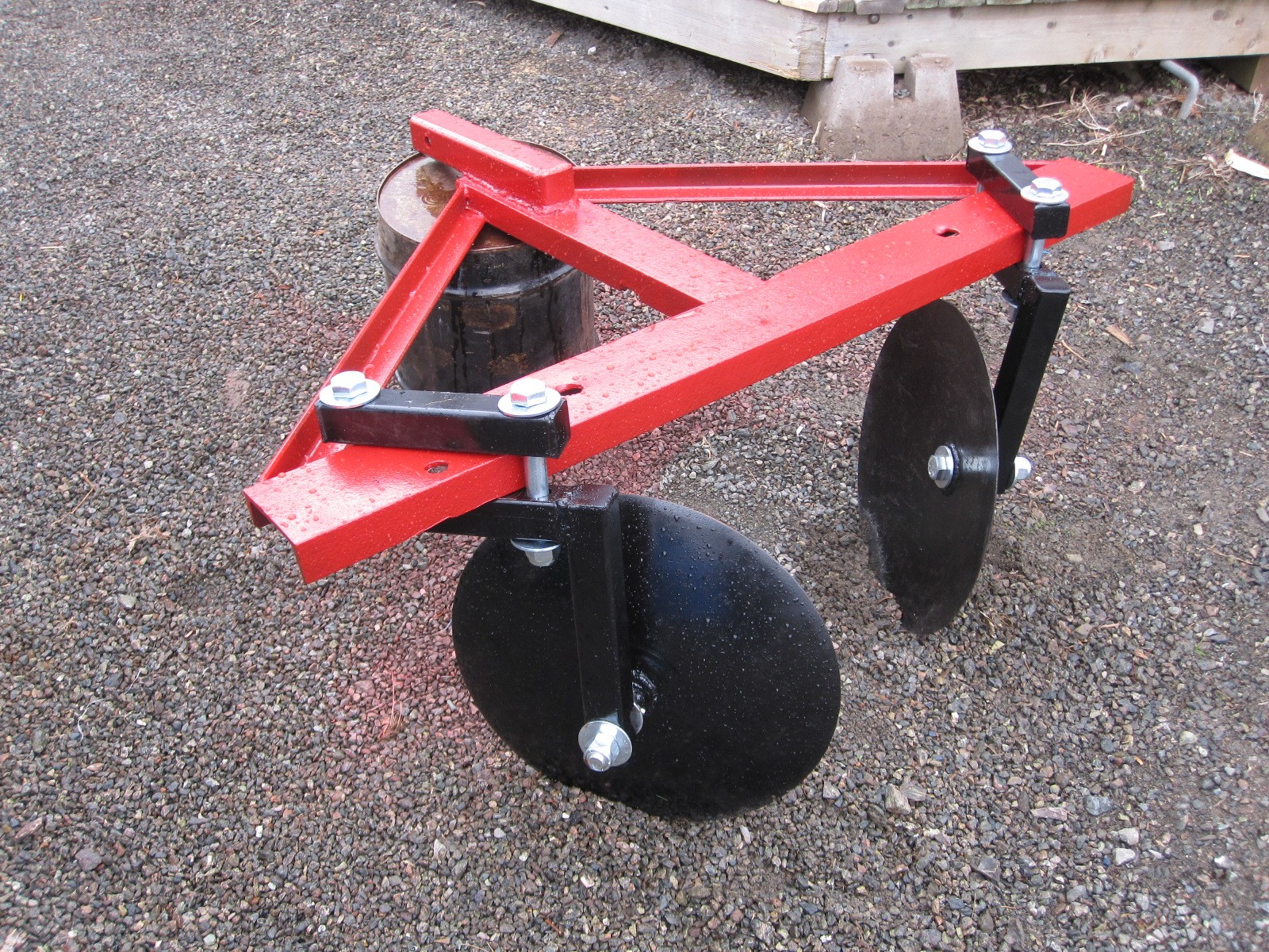

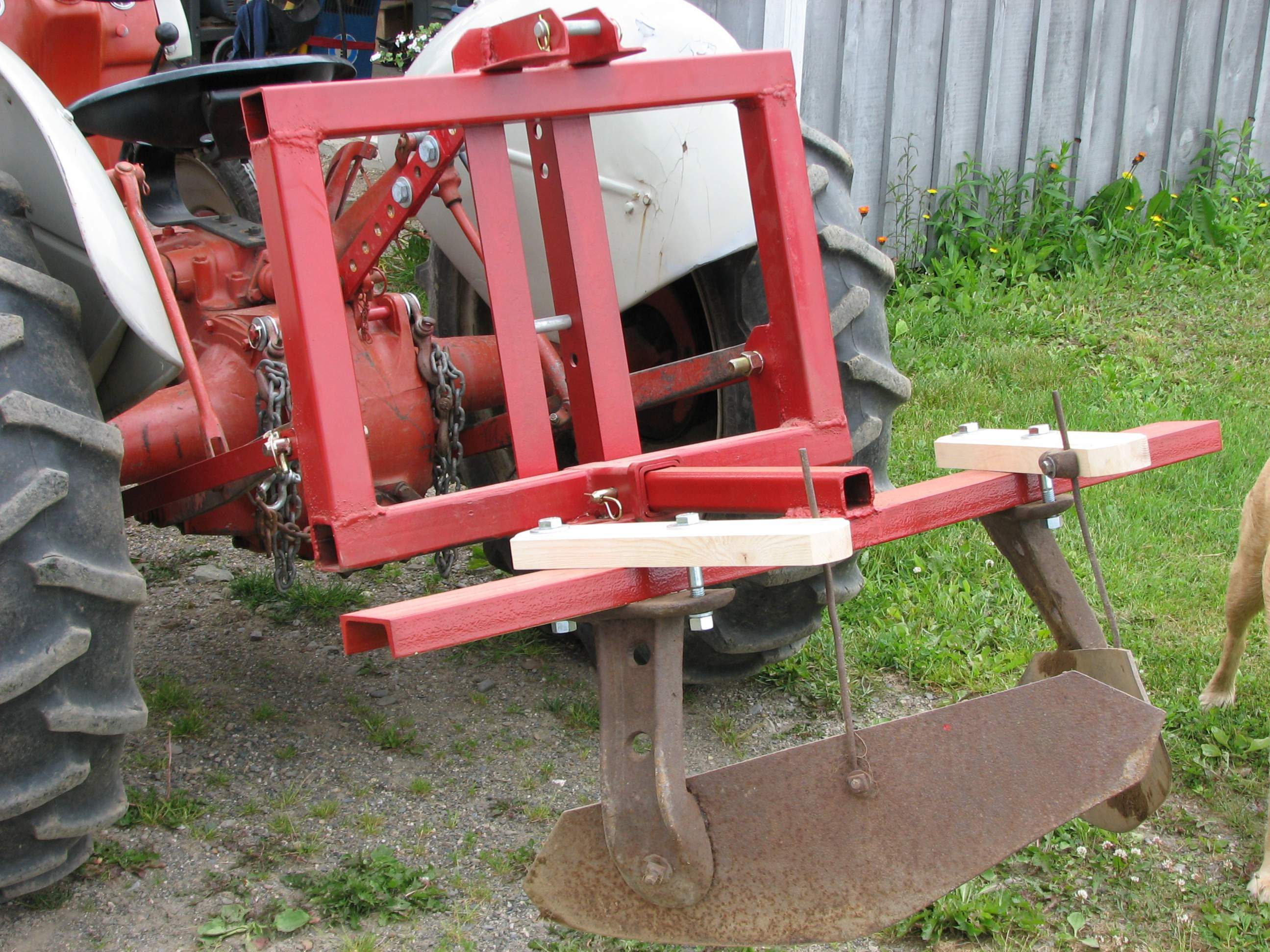

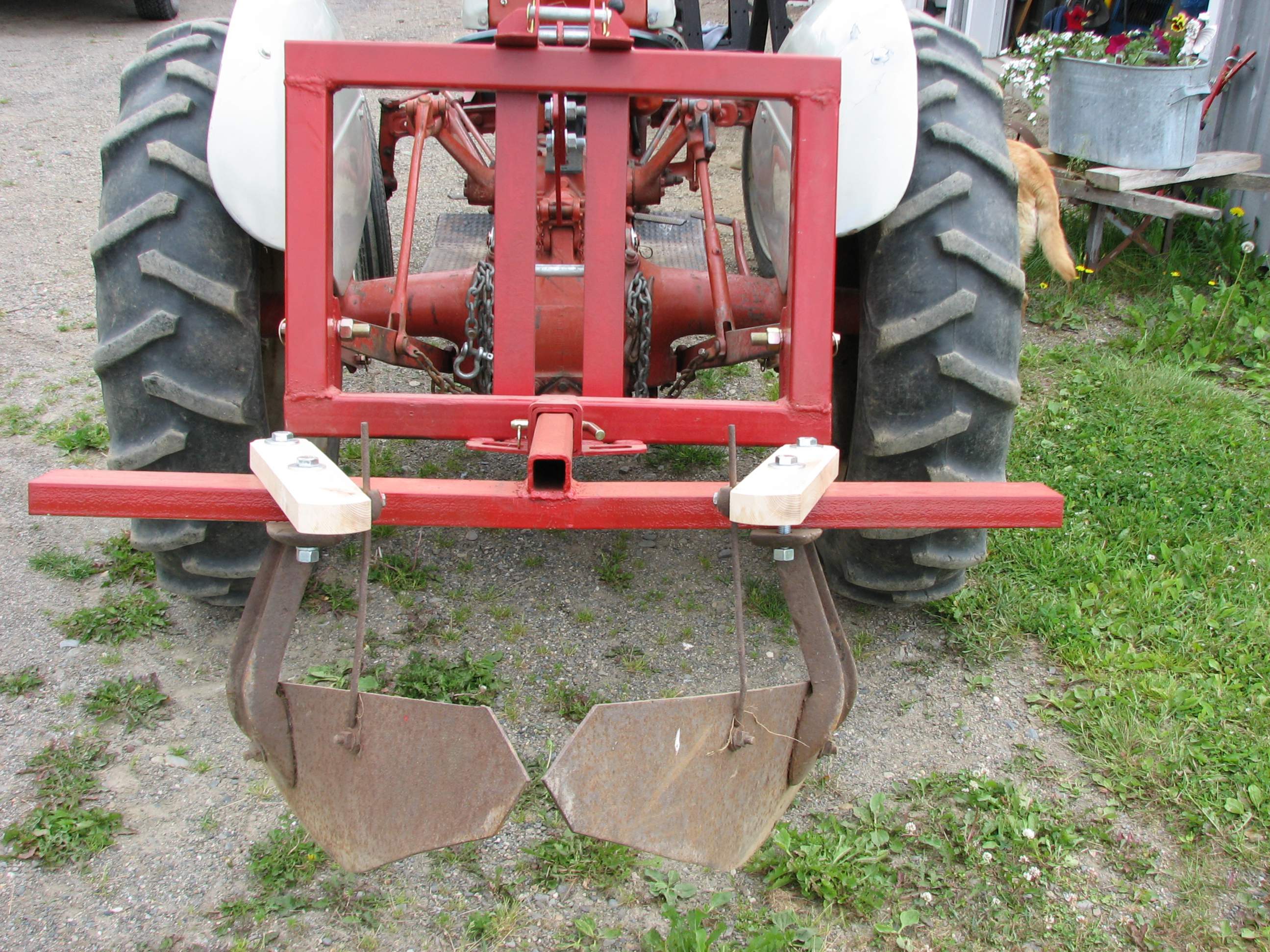

Here is a couple I made (posted here before, I think). One used the metal parts from an old set of horse drawn hoes, the other uses a couple of discs from an old disc harrow & mounts to my 3 pt. trailer hitch/log skidder. Both work great. 005.jpg004a.jpg001 (4)a.JPG032.jpg

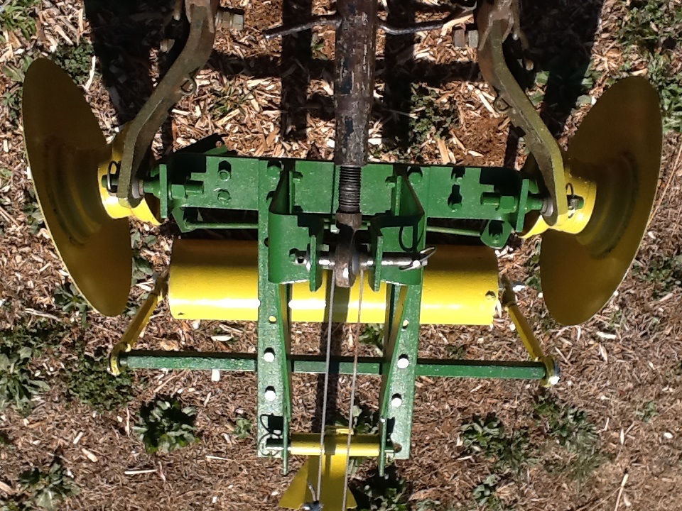

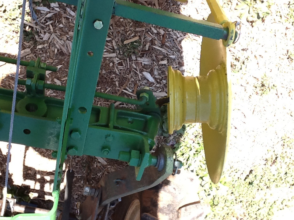

   / bedder hiller #7
[ATTimage.jpgACH=CONFIG]309617[/ATTAoCH]I built a hiller/bedder from front end of garden tractor works great.email me if you have questions or want more pictures.

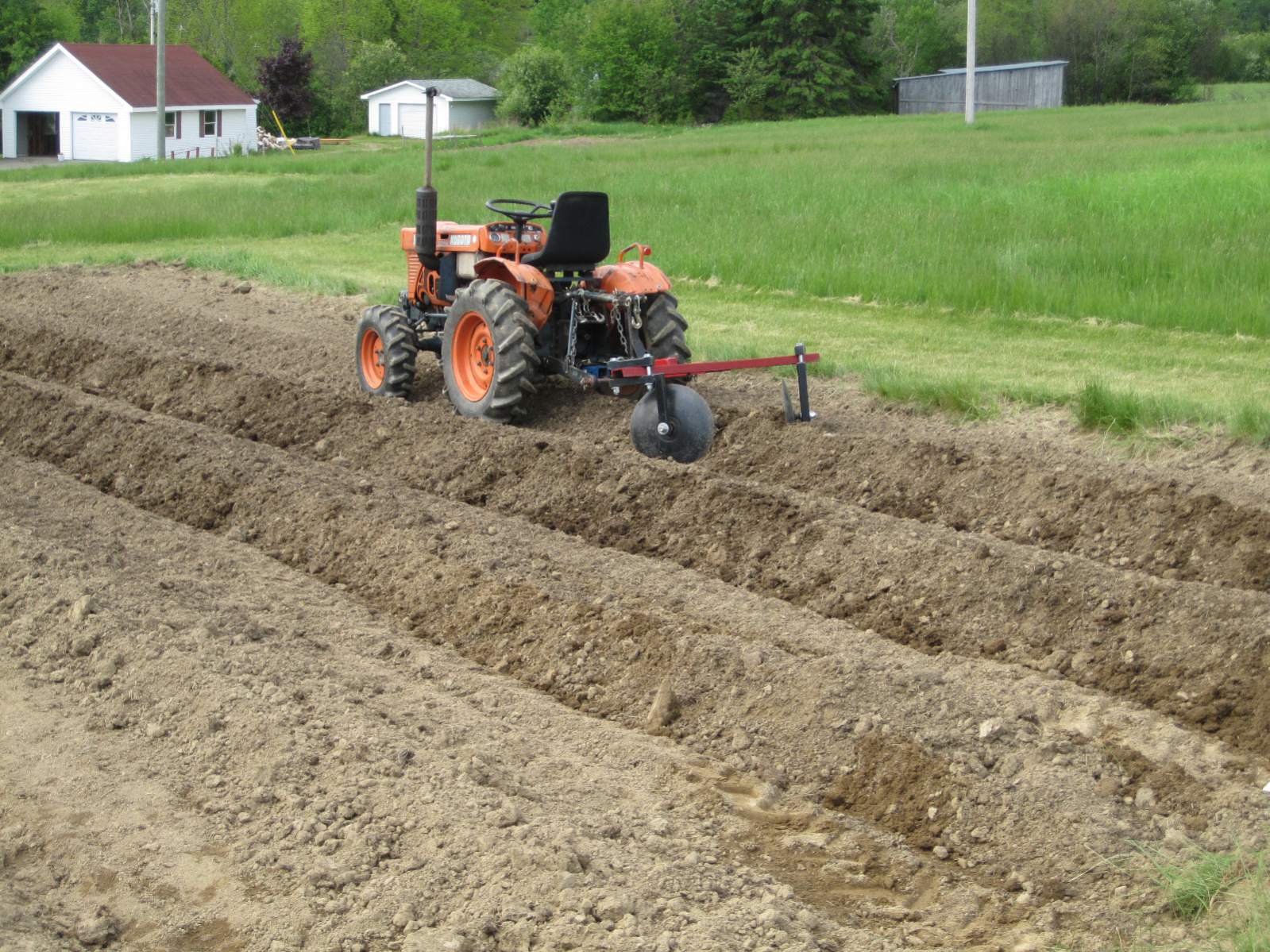

   / bedder hiller #8
[ATTView attachment 309618ACH=CONFIG]309617[/ATTAoCH]I built a hiller/bedder from front end of garden tractor works great.email me if you have questions or want more pictures.
Terry,
Looks like you used the front axle from an old lawn&garden tractor. So I see you use the tierods to adjust angle. and the roller on the back is to flatten the top of the row?
The end looks like you have a furrower.... I'd love to see the rows this makes.... It's a very nice setup.... Talk about green.. it's all recycled...
Regards,
Chris
