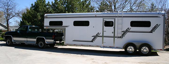

Looks like a McBride. Not a real heavy trailer.
Truck could probably handle it for occasional short-distance hauling provided you didn't put two horses in the front two stalls.
Configured as two box stalls with a mare and foal in each should be OK.
You would want tires with E load rating and trailer brakes and controller that were in top notch working order. Air helper springs are wonderful.
This photo is of my 3/4 ton SRW Dodge with 30 ft overall 4 horse head to head. This truck (before helper springs) barely squatted with this trailer attached. Look at how far back trailer axles are placed, due to a 5 ft. wide side un-load ramp. A half-ton with helper springs should at least support the tongue weight of the trailer, being careful of how the trailer is loaded.
Anyway, is it not usually a problem to get out of an existing lease if you are going to lease a newer more expensive truck from the same dealer?
I don't know, never leased anything before.:confused:
