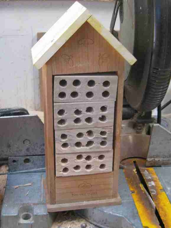

I was very surprised reading that you should put a screen over a Mason Bee "hotel", while they are hibernating, so woodpeckers don't eat them. WE HAVE SERIOUS ISSUES WITH WOOD PECKERS 'ROUND HERE. :( I think my BIL has ill will towards me. He gave us his used little Bambeco house, but left out the Bamboo straws. Spent two hours making holes in untreated wood blocks to made my own. Then I looked up what a new one would cost with the straws..... $12.... He must be laughing at me right about now.
