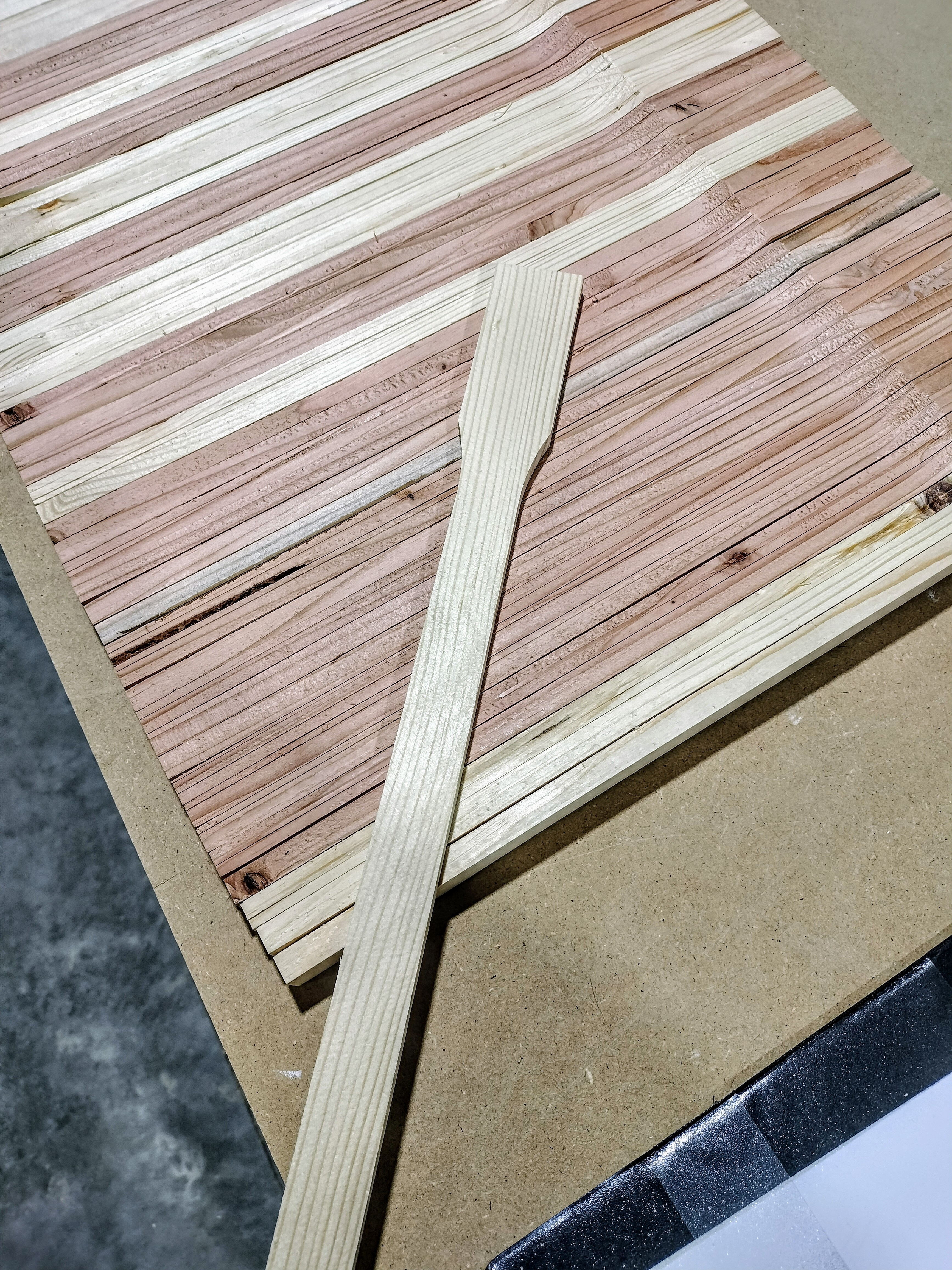

I leave a couple thin strips on each side, to stabilize the board as I carve out the rest of it. I also run the board through a planer first, to make sure they are completely flat on each side, before I start, and exactly the same thickness
/ Beekeeping #513
2x6, I lay on its side, and taper with a 1” wide dado blade on a table saw. Then rip into 3/8” bars
Do you have a photo? I'm sure this is obvious, but I'm having trouble visualizing it. 2x6x30"?, 6" side flat on saw?

/ Beekeeping #514
All the best,
Peter
Yessir, they are about 16” in length. So the 6” flat is laid down on the saw. The dado bade .25” depth of cut. I have a mark on my fence so that I know where to stop the taper. I don’t have a photo sadly.

/ Beekeeping #516
Thanks! I was a bit curious on how you were executing the stop of the taper. I'm impressed at the repeatability, and care of your work. The SOP binder seemed very en pointe for a former pilot somehow, at least to me. (I'm not a pilot, but I am a fan of the training and SOPs in use in aviation, especially the flight deck.)
