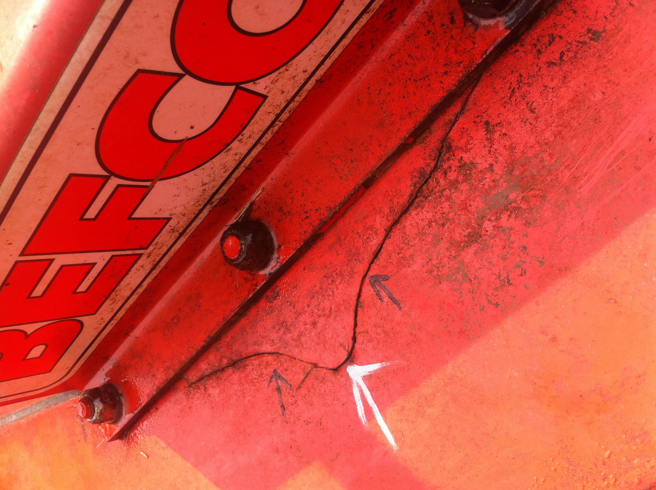

Front of deck developed a crack from gearbox plate flexing :

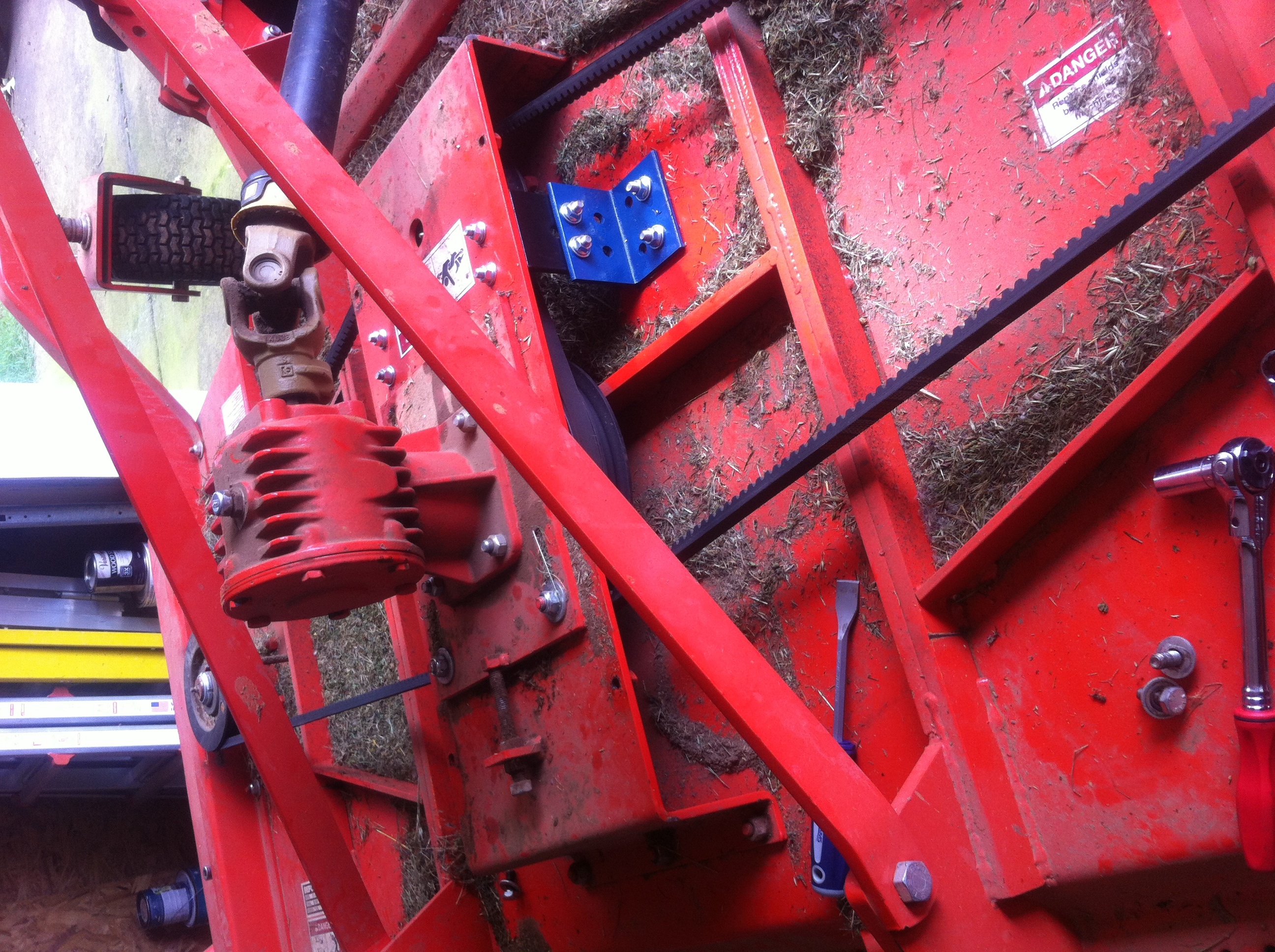

I bolted in some steel brackets on each side of gearbox plate :

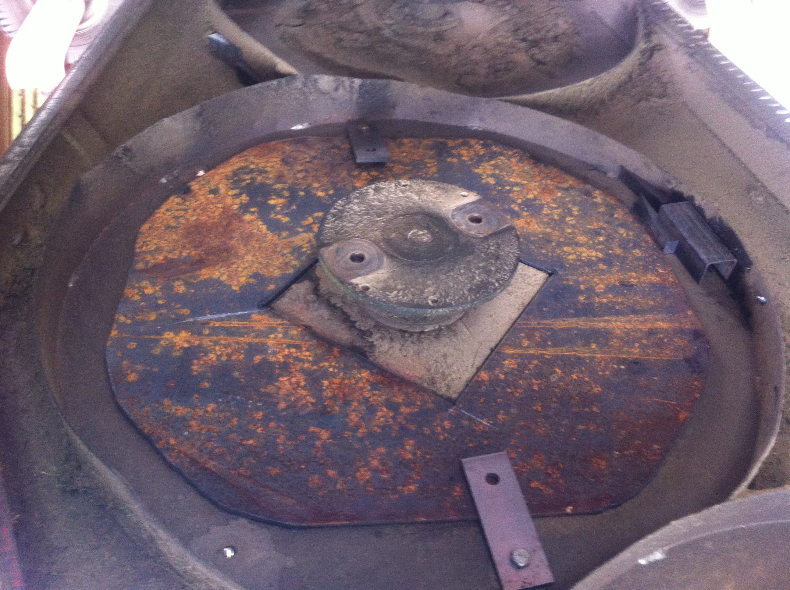

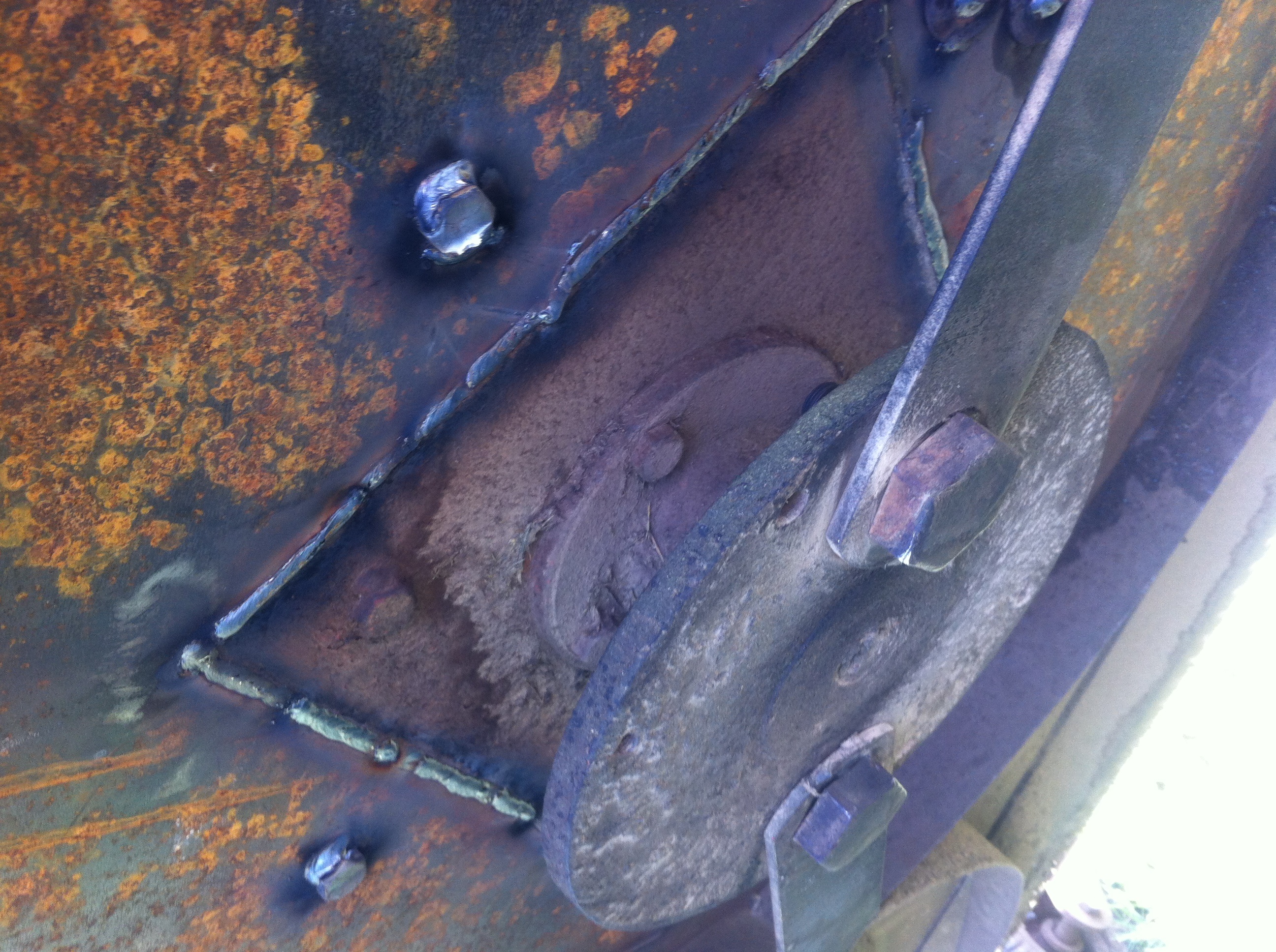

Then bolted & welded in this 1/4"'plate around the OEM 11.5" square reinforced plate that center gearbox bolts to :
