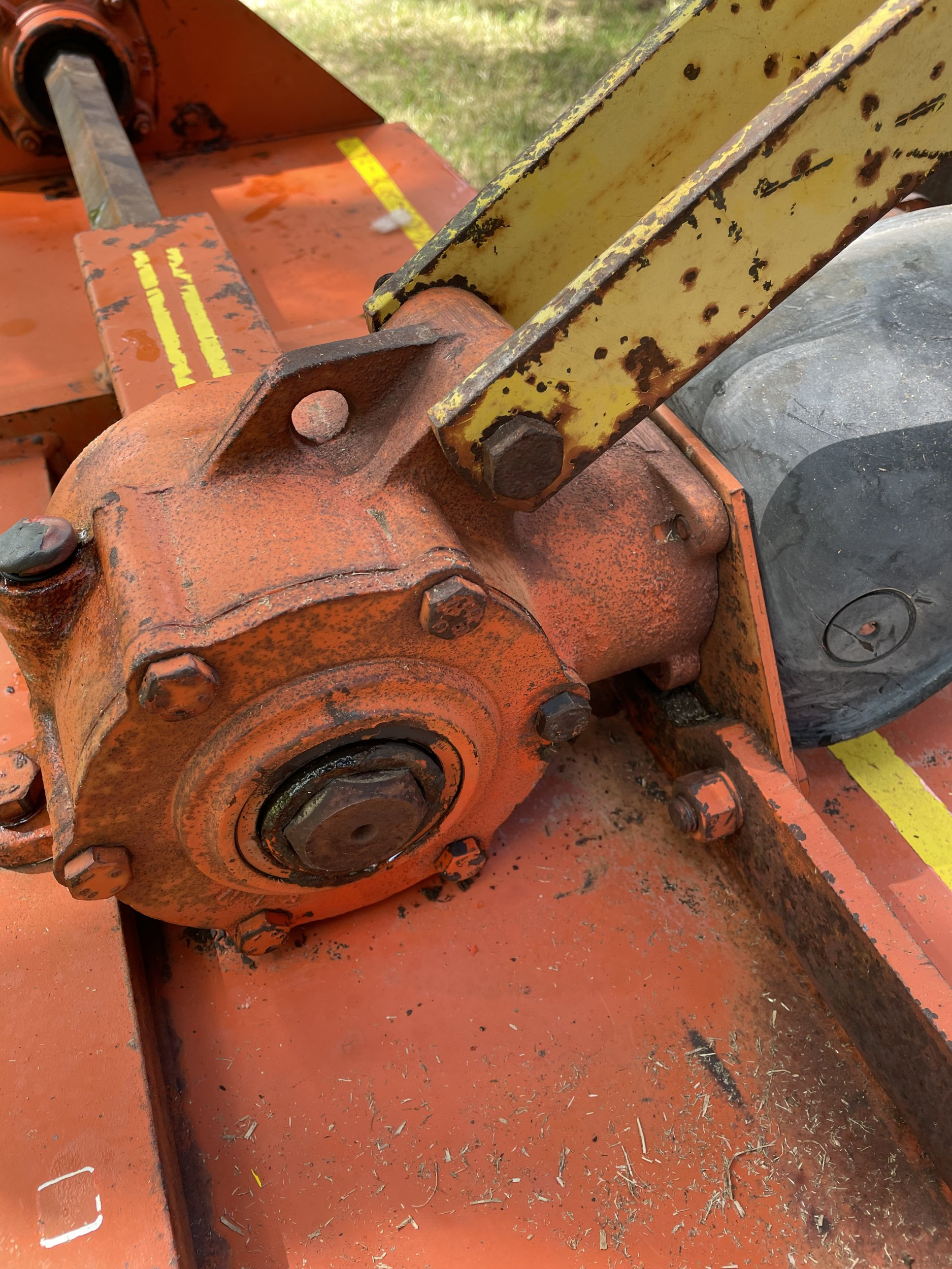

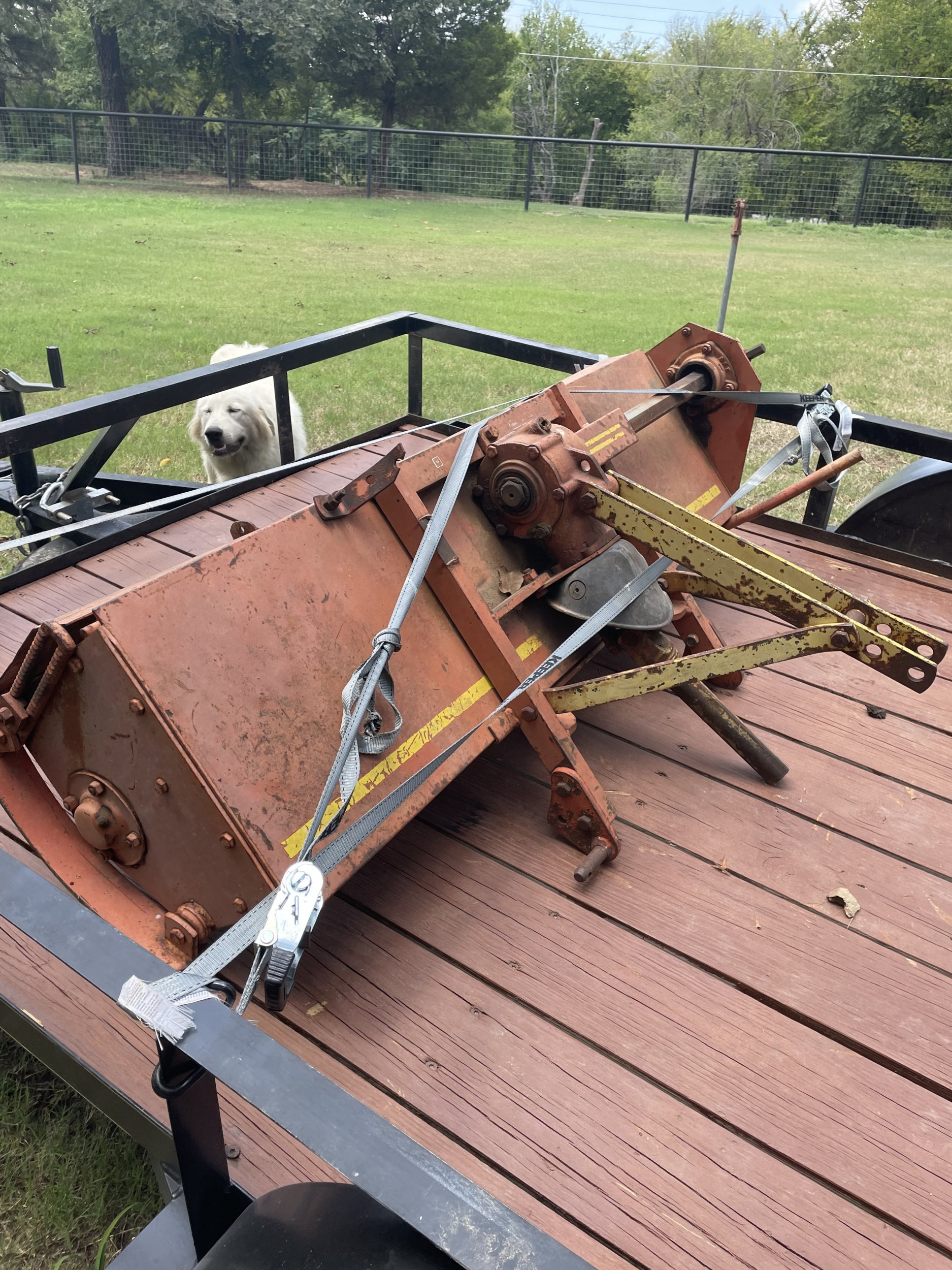

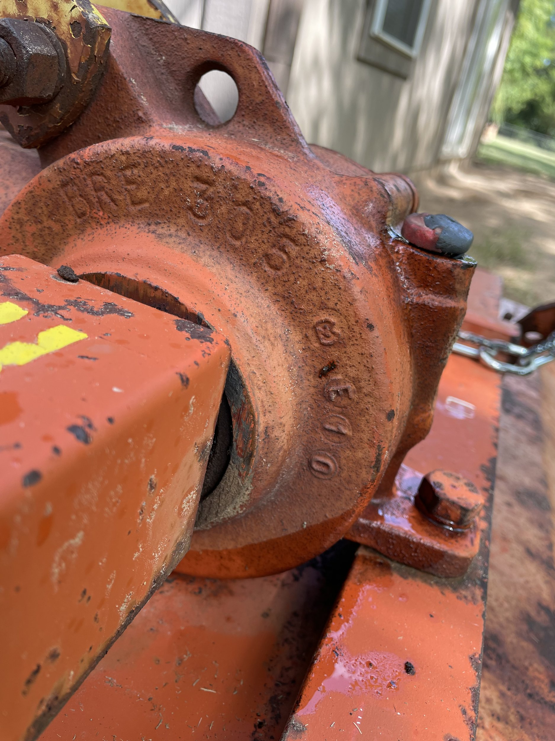

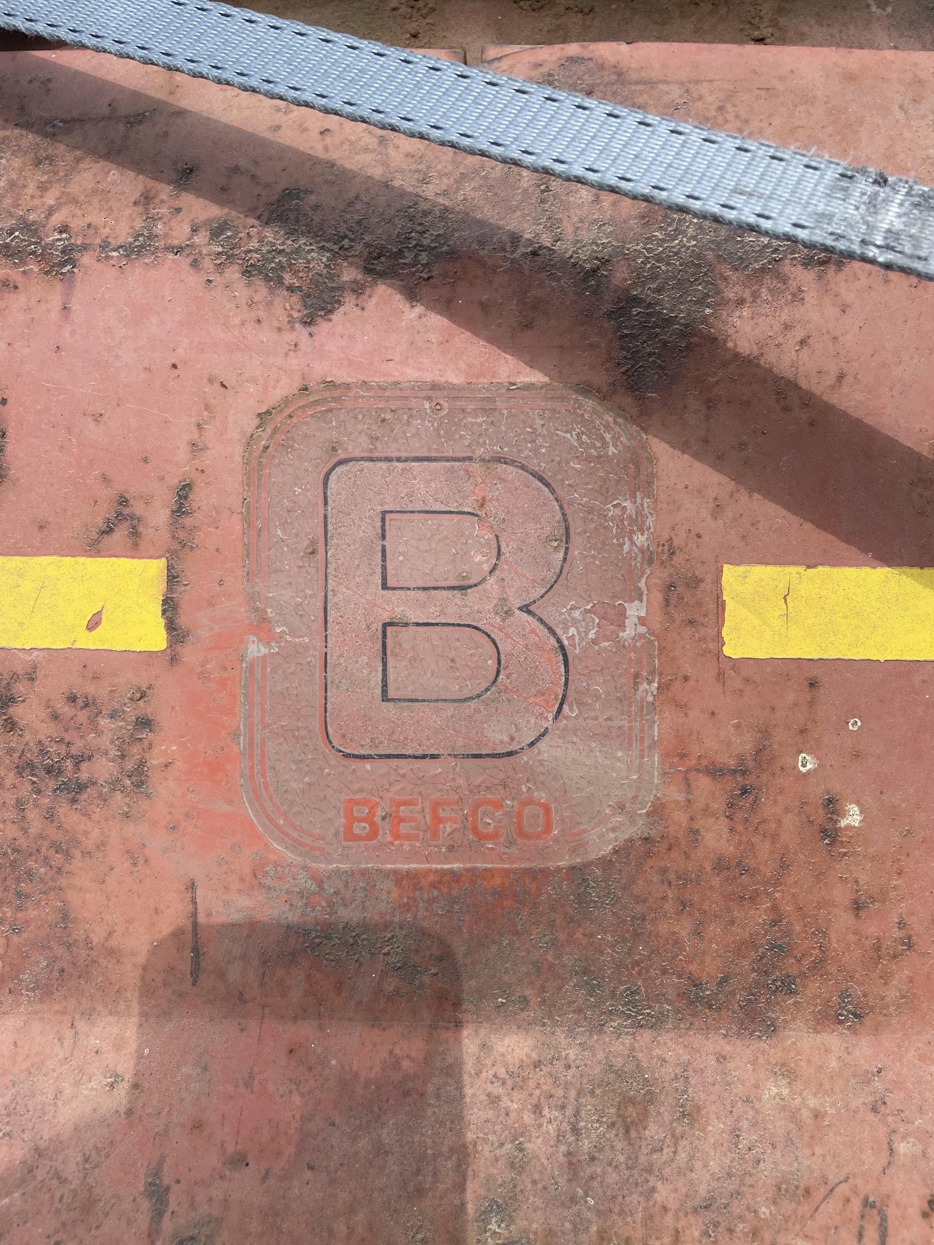

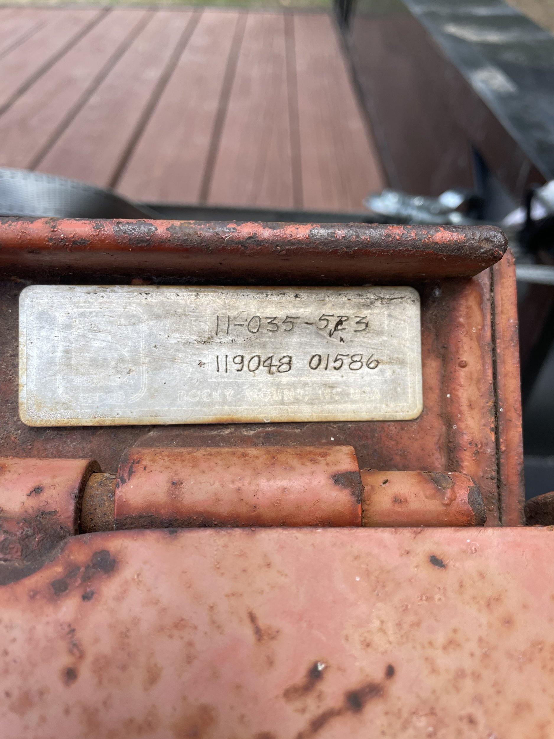

I recently purchased a Befco tiller. The front seal on the gear box is pouring oil out. Im having a hard time identifying the model to order parts for it. Can anyone help me out?

I would simply take the seal out and go to an hydraulic shop, bearing/seal supplier or something similar and just get a new one. Same for any bearings that you may need.

I'm not sure what the 11-035 --- is, but the bottom row of numbers look like a serial number and date of manufacture. Call Befco direct and see what they can tell you.
Befco part number is 000-22995. It is a common metric seal sold as 35 x 62 x 10 at any bearing and seal supply house.
