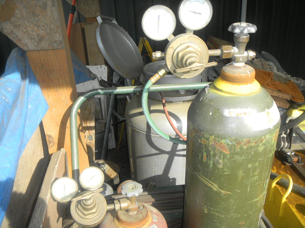

Only regulators I've used is Victor Journeyman. Even on the job site, all we got were Victor Journeyman.
