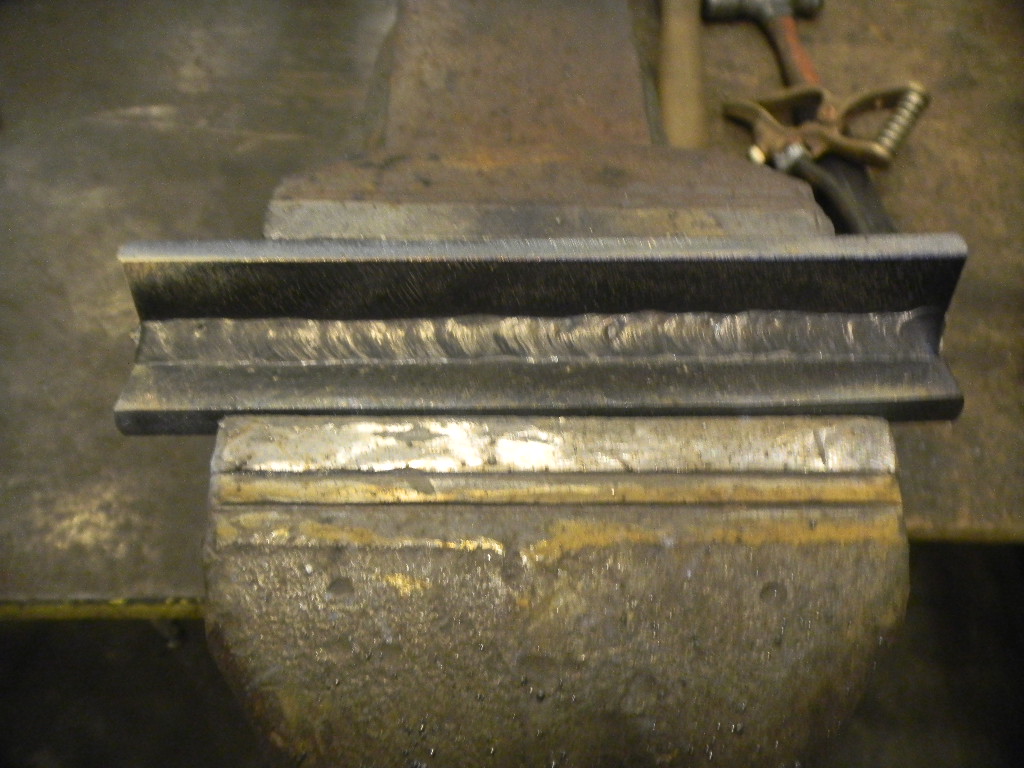

If you are limited to 120-volt input power. I suggest you look into a self shielded flux core Mig welder. And run .030" Lincoln NR-211 wire. This will get you up to speed the fastest.
This weld was made with an Everlast PowerArc 140ST 120-volt Mig welder, and .030" NR-211.
