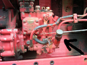

There is no shutoff solenoid. On my 250 the throttle lever just gets pulled back further to shut it off.

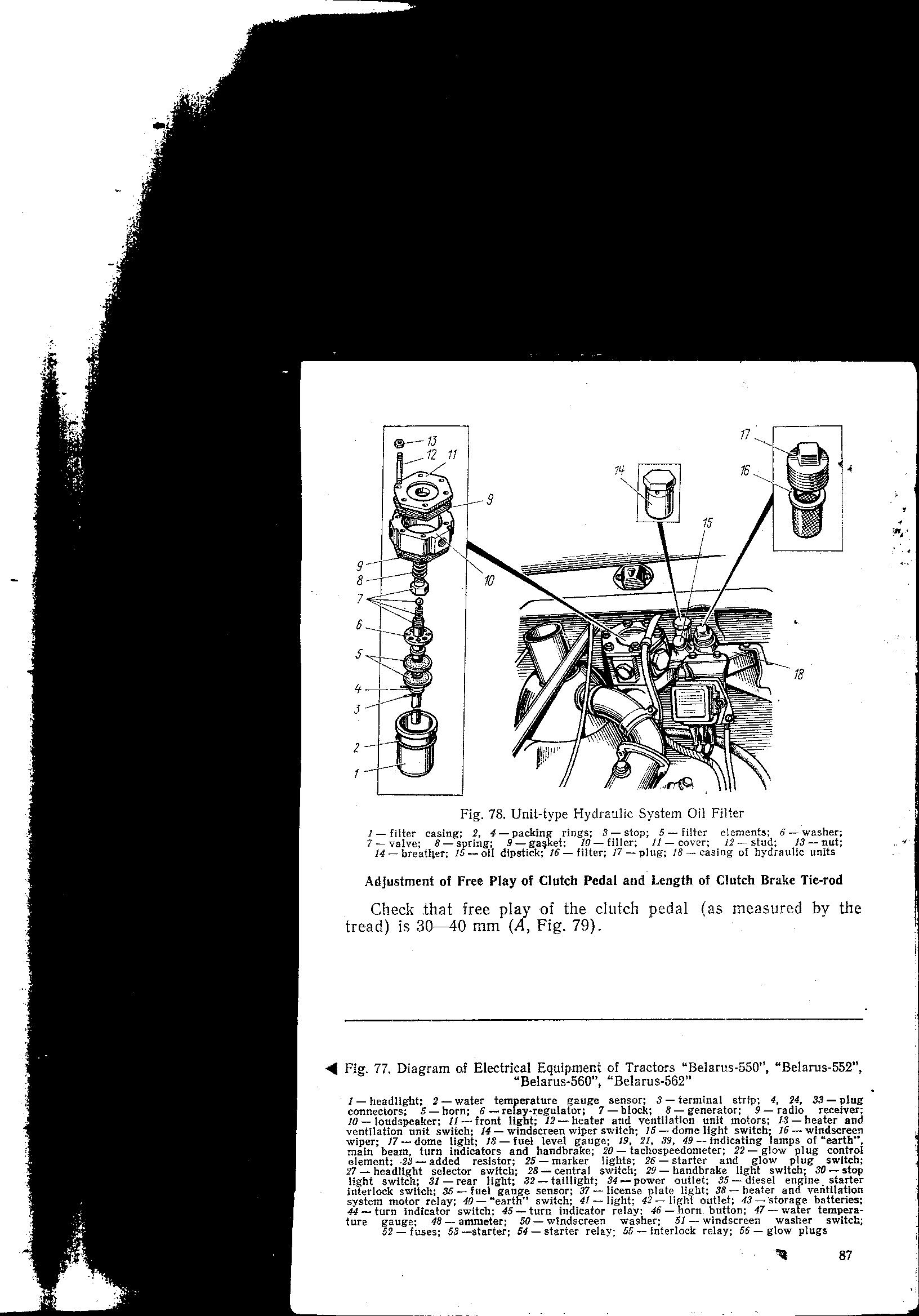

I have 2 copies of the operator's manual and a repair manual for my 250. The owners manual is pretty good with detailed maintenance instructions. It's 92 pages and includes an electrical schematic on the last page. the p/n of my operators manual is 904252. The repair manual is about 245 pages. It's complete with plenty of pictures.

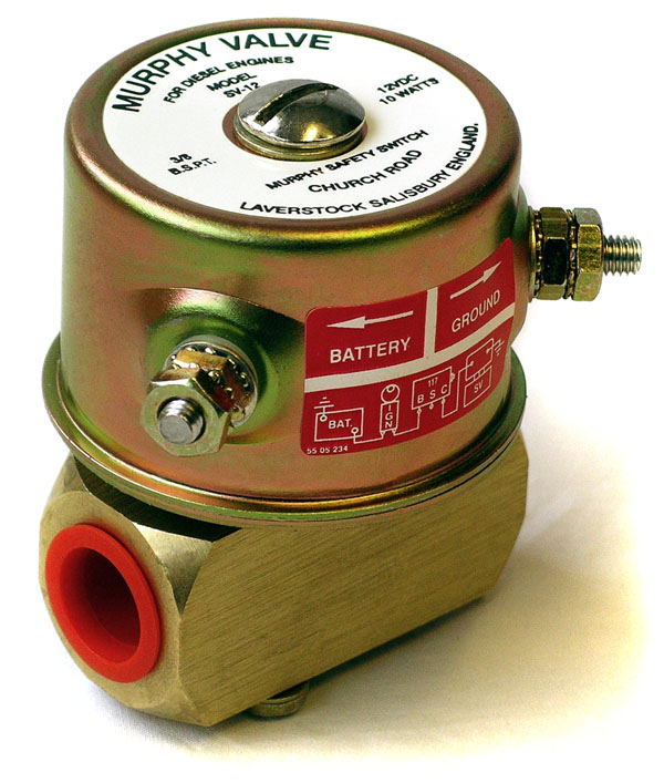

I just bought a Belarus 420AN that the previous owner decided to sell for scrap iron. Long story short, I have $650 in it & it runs great...but half of the electrical doesn't work & the other half is missing. I can start it, but I can't get it to shut off. I can idle it way, way down & it will slow down (2-300rpm I'D guess) but it just won't die. I've heard using the compression release is hard on stuff, and I know shutting the fuel off at the tank is not good either. I read something about a "stop solenoid", but I don't know what it looks like to even look for it. There are no wires going to the injection pump that I see...(I'd assume the stop solenoid would be close to the pump) I'm lost and haven't found much information on these tractors at all. Any help, web sites, info would be greatly appreciated.
