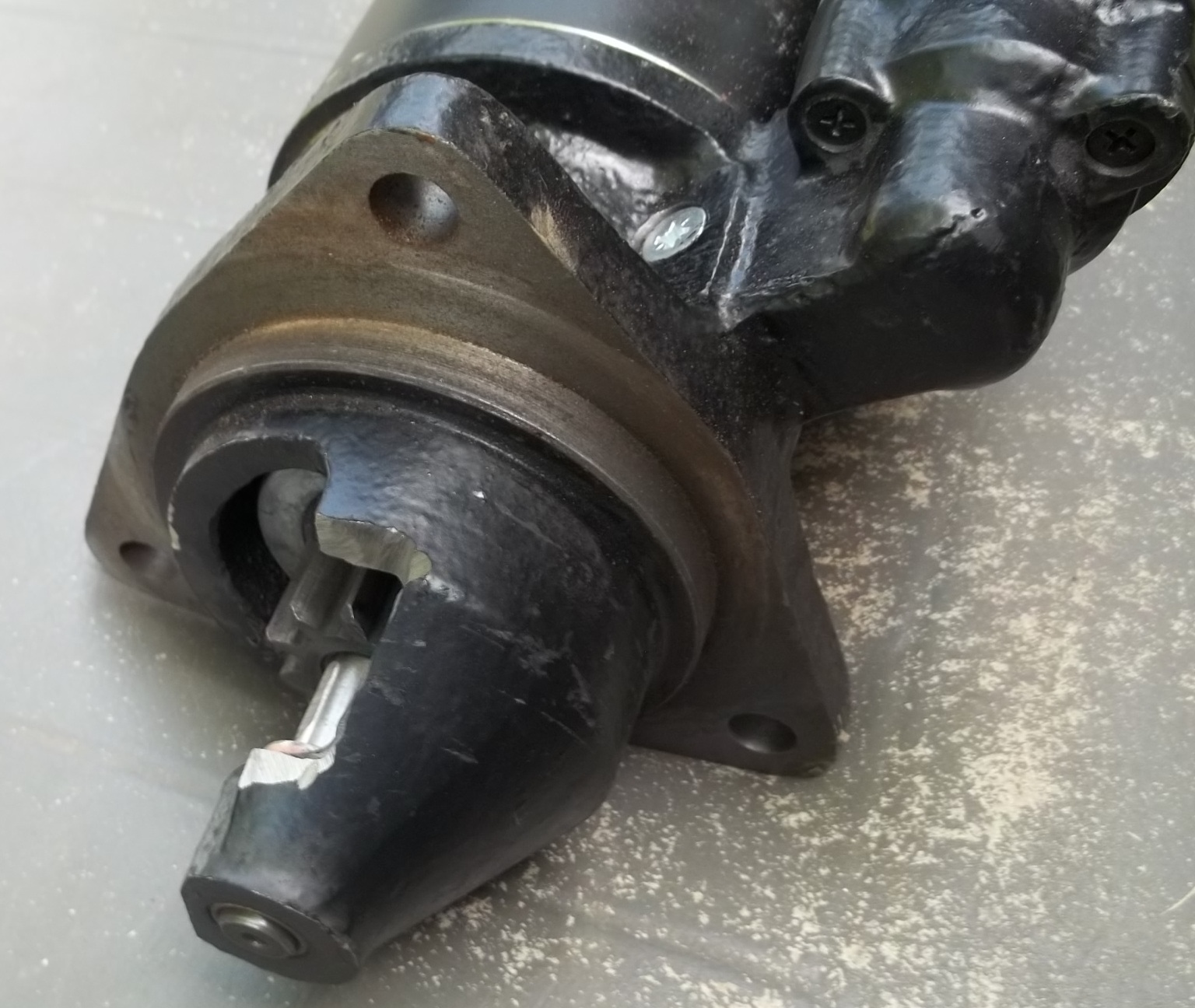

This could be for discussion for anything to do with belarus starters but here is my problem.
I got this starter for my 1979 250 AS and it does not fit. The ad clearly states for 1979 250 AS .
NEW STARTER BELARUS TRACTOR 250 300 400 400A 405A 420A 425A SBE0003 | eBay
This starter has a nose/bendix opening that is too far counterclockwise if facing the nose side. It hits the flywheel while the bolt holes are about 1/4" from lining up. Actually the bendix opening should be about 30 deg CCW from where they have it. The nose length and width are smaller also and the gear sets out a little further. Measuring the flywheel teeth to mount face and that of this starter it looks to me as it would still work, leaving about 3/16" between the flywheel teeth and the bendix gear with the solenoid at rest, as long as I could get the holes to line up. I have a couple ideas to try since they require me pay return shipping and then it's at their discretion whether they want to refund or not.
Even though they print that it fits a 250 AS 1979 in bold print at the very beginning there was nothing about nose differences and then they print later and smaller "must match part numbers." Well I could not read part numbers but after closer inspection later I saw CT222 a distant "T" then more bizarre characters. They state CT222A .
I may try to just cut a 1/2"X 1 1/14" rectangular slot at the edge of the nose where the flywheel, redrill bolt holes, or make a mounting adapter of some sort. I also considered just switching the mount face and nose with my old one but I think the shaft length is different.

Tested it to assure it would work if I modified the mounting. All I ended up doing to test it was just turning it counterclockwise so the bolts would go in the holes on the bellhousing and not the starter yet the washers would catch on the starter mount flange.
Worked awesomely well. Started it several times and had to check to see if the engine was even turning it was so fast. It would even turn it fast with the decompression lever engaged, Ran it for a while listening for noise then pulled it back out. No sign of scoring, rubbing etc. So this starter will work for this tractor with minor modification. After seeing what I did to try it I may just perfect that by making an adapter plate or 3 stout "slats with pins" shaped like an L and not alter the starter or tractor at all
   / Belarus Starters
It's done. As I began to make a bracket which would have been made from 1/8 steel plate with holes for the bolts to the bellhousing and rods or bolts for the starter holes, I realized this would take an hour or two as opposed to just cutting some off the edge of the nose. I cut a place approx. 1/2 inch deep and about 1 1/2 " long (rectangular cutout). Tried to go slow and very careful not to cut where I didn't want to and make it real neat. It cut unexpectedly fast and I did score places I did not want to because of that but it won't affect anything. Only took about 2 minutes with a 4" angle grinder with a cutoff wheel. Made two 1/2 cuts inward and then a partial cut connecting them long ways then broke of the cutout with a hammer and then smoothed the rough places. Basic stuff. It appears to have left plenty of the nose circumference unchanged as seen in the 2nd pic. When I tried it I found it would actually turn a huge 1 1/4 inch PAST the holes before it hit the flywheel opposed to hitting 1/4" before the holes before I cut it. That means I could have probably just cut 1/4 " or less instead of 1/2".
Tried it, worked perfect, no scoring, nothing rubbing, no heat. I'm happy!

I didn't see any that cheap. Was yours the "centric" without a nose? Sure, in hindsght I may have just got another type but with this starter I don't see need for a gear reduction after using this one. Turns too fast already if there is such a thing as too fast. It may be just a very powerful one. It has the power listed but I don't know what to compare to. I almost bought a centric but they did not respond to email since they stated to make sure the nose was right so I ordered elsewhere. In the pic it did not even have a nose.
