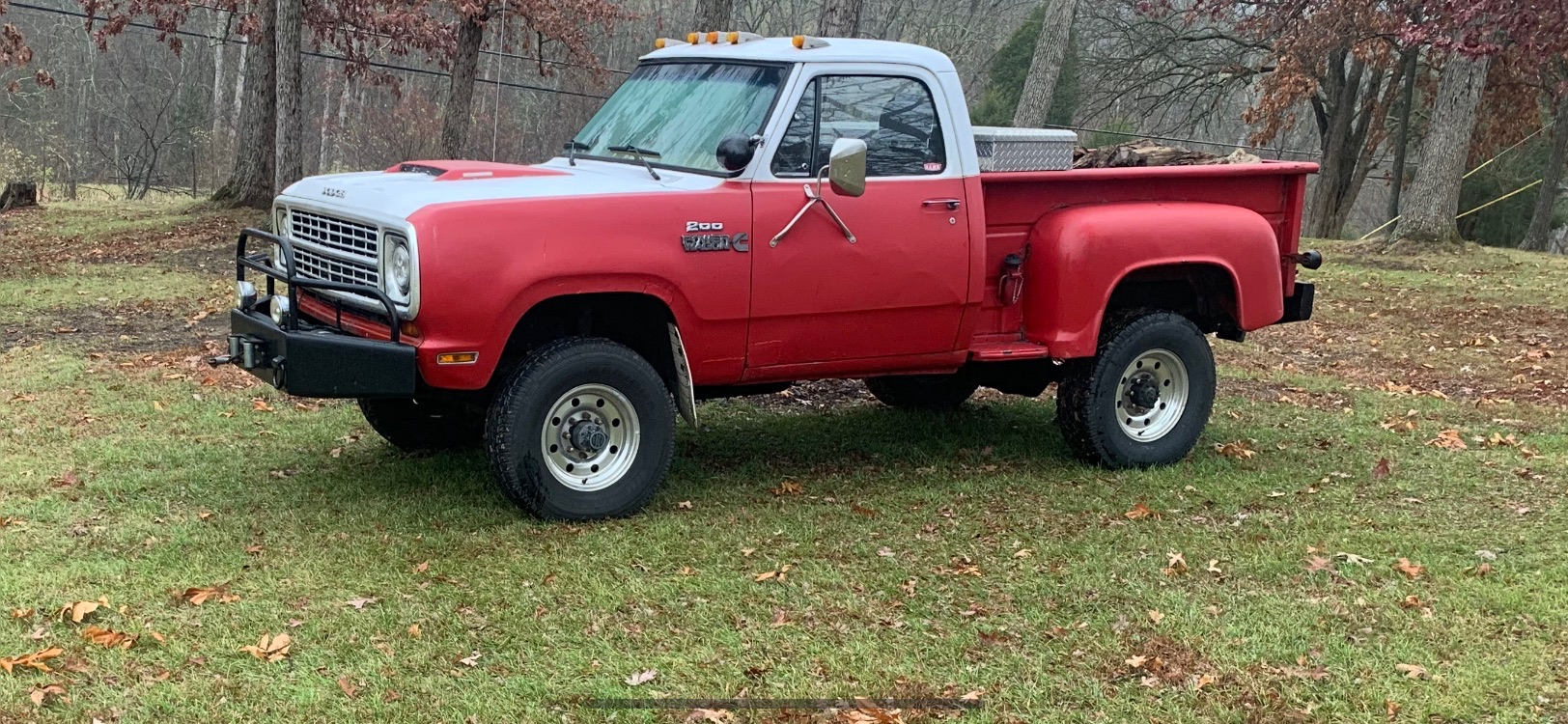

Here the Old Work Horse is , Dana 60 front and rear axles , both have Dana power locks , Cummins Powered , NV4500 , NP205 , Ramsey hydraulic 20 ,000 lb winch . It will drive anywhere on the planet , that you can steer the steering wheel . X US Forestry unit . I purchased and M35A2 at the same time.
Yeah thats a stout truck.
Let me know when you’re done with it…..
