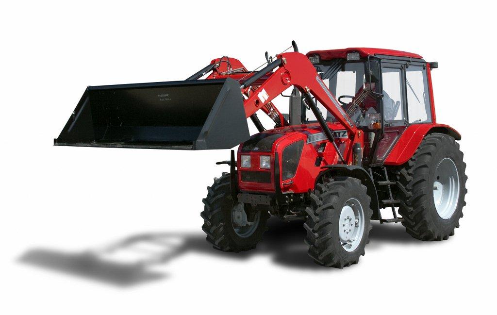

Well I got a first hand look at these new Belarus's under the MTZ name now in North America at a Farm trade show in Red Deer Alberta a couple weeks back. They had a 122hp model there which their biggest 4cyl model but the sales rep said on the dyno it put out 130 hp. They have much bigger 6cyl. ones too but only had this one model there. Over all yeah its a big improvement over my old 825 that's for sure but it comes with a price. Wouldn't be so bad if the Cdn. dollar hadn't dropped off so much, state side their cheaper of course. I see even Belarus is going to electric over hyd. switches in the cab for MFD, Diff lock and pto. New dash too and better hood. Fellow said they out sourced the injection pump and injectors to meet emissions. Still mechanical though NO electronics/emission controls so far.
They had a price comparison done that was interesting its on the website too vs lower cost basic tractors from many brands.
