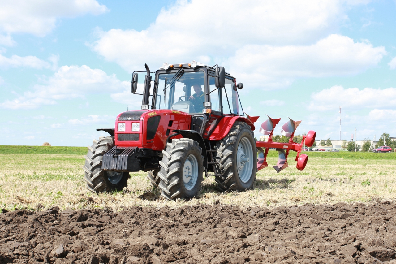

Interesting info.
Back in the day Belarus imported (into Canada) the 100/102 and later 6100 that were rated at 100 pto hp. Who knows what they actually put out as they always seem to under rate the hp ratings on them. THey came with a 24 speed synco trans and were a little bigger frame tractor.
Now their current biggest 4cy. model would be I guess the 1220 series rated at 112hp pto 122hp engine with a wieght of 12,170lbs before ballasts, loader etc. So its definately more beefer then the 95 pto hp 952 model the now import or my old 825.
Current 1220 model
