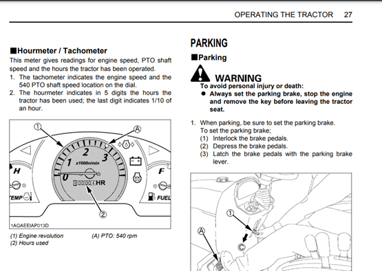

You can certainly be running at WOT and not be under a full LOAD. In fact, when sitting still and just spinning the blades at WOT, the tractor is under very little load.
I don't understand the reluctance to run the tractor at the proper RPM for PTO work. It's clearly indicated on the tachometer. Based on the manual I downloaded, proper RPM for mowing on that tractor is 2800 RPM. If you were running a tiller or bush hog, the proper RPM would be 2800.
Take it to the dealer and mow some grass in front of their place and ask them what's wrong. I bet $5 they point to the hashmark on the tach and tell you to increase RPMs to 2800.
It's always a good idea to have sharp blades, but it's still not going to cut right at 2300 RPM. That's like taking a basic push mower and running it at 75% of its rated RPM speed. It just won't do a smooth job.
I looked at my Kubota manual for both the rear and mid PTO. For both, Kubota says to run the engine at the speed indicated on the tach. (In my case, that's approx. 2600.) There's no mention of NOT running at WOT and there's also no indication of a "red line" on my tach. WOT on mine is 2800 RPM with NO load on it.

You can certainly be running at WOT and not be under a full load. In fact, when sitting still and just spinning the blades at WOT, the tractor is under very little load.
Good luck.

Mike -- take it out and mow with it at 2800 RPM for 10 minutes and see if it doesn't do a good job. Even dull blades will cut grass when you spin them at the right speed. They'll tear the grass instead of cutting it clean, but it will be shorter and it will throw the clippings like it's supposed to.

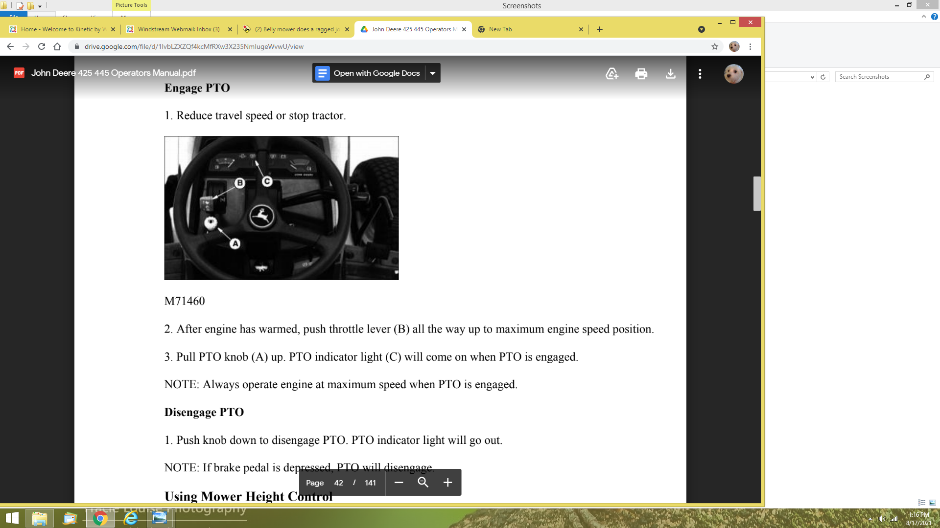

Sharp blades and running it at WOT (2800 in your case), and that mower will cut like it's designed to.
Stop under running your rpms, you're blade speed falls off dramatically, and ANY mower will cut like garbage doing that.
   / Belly mower does a ragged job - why? #38
I have an JD X300 and the owners manual says to run the engine at full throttle when engaging the blades. And that’s what I do, I push the throttle wide open and engage the blades and start mowing. Also, according to my small engine repair guy, he told me that a lot of mowers will get too hot if the rpms are too low for too long cause the engine is not getting enough air.
