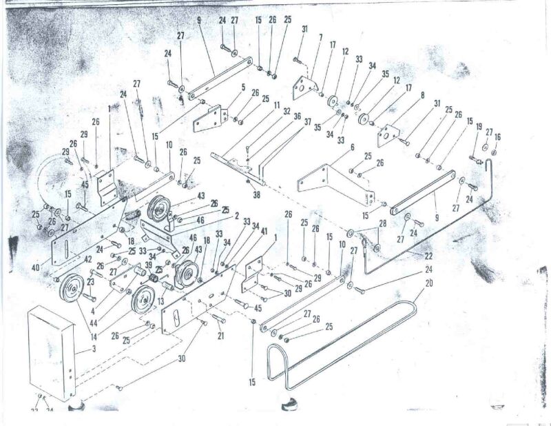

Attached is a scan of the parts breakdown for the mounting hardware. I also have a manual for the YMM-60 which was driven by the rear pto. I can scan a page of that too if you are interested.

Remember, the scan from gbirky is the mounting parts for a YM1300, not for your YM1100.
   / Belly Mower Help #8
Actually, the manual states that it is for YM135 (YM1100), YM155 (YM1300) and YM155D (YM1300D). That does NOT include the YM135D which is the equivalent of the YM1100D. The parts are the same for the YM135, YM155, and YM155D, but you use different mounting holes, and you need the extra back side idlers and a different belt for the YM135.
You may have some clearance issues with the YM1100D front axle and driveshaft.
   / Belly Mower Help #9
The front left and right mounting brackets are not the same length for the 155 (1300) and the 135 (1100). Nor are the front tow links the same for those two models of tractors. The 155 has a longer frame and takes longer brackets and tow links.

Here's a scan of the "tractor mounted" parts for the YMM-60. This deck is driven by the rear pto with a large pulley (around 12" diameter if I remember right). This might be a less expensive alternative, but would require quite a bit of fabrication. Since your's is a YM1100, it should have higher pto speeds, so wouldn't require the 12" pulley. I think I figured out that an 8 or 10" pulley would work for the YMM-45 with pto at 1300 rpm.

Yanmar packaged the Operators Manual with the Mounting kit, so when a dealer ordered a kit for the YM155, it didn't show the parts for a YM135, and vice versa.
There is about 3" to 3 1/2" of lift before the guards contact each other, almost as much as on a YM155, both those models used the same size Ag tires (5-12).
