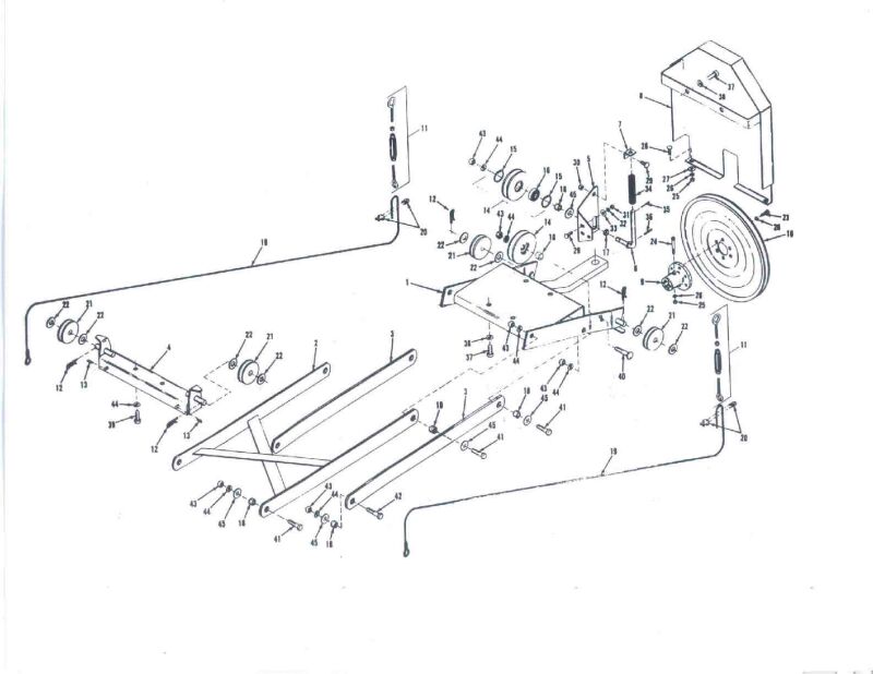

Bill,
Here's a scan of the "tractor mounted" parts for the YMM-60. This deck is driven by the rear pto with a large pulley (around 12" diameter if I remember right). This might be a less expensive alternative, but would require quite a bit of fabrication. Since your's is a YM1100, it should have higher pto speeds, so wouldn't require the 12" pulley. I think I figured out that an 8 or 10" pulley would work for the YMM-45 with pto at 1300 rpm.
I hope this helps.
