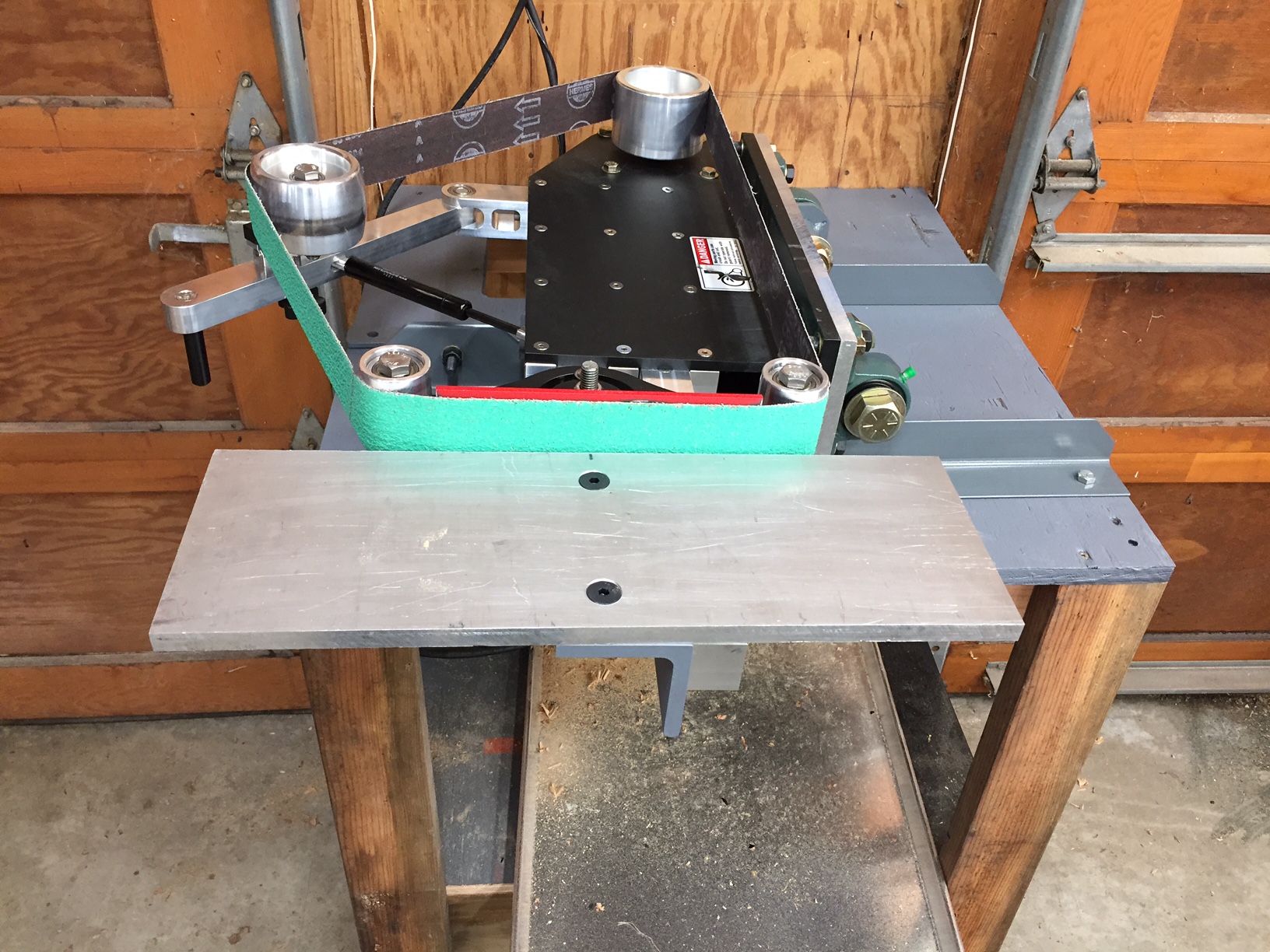

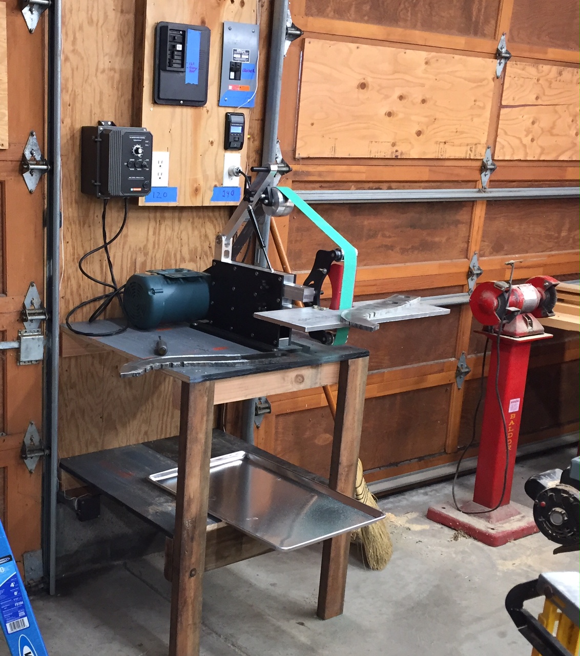

I wanted to make the grinder from scratch, which lots of folks do. But I have so many projects stacked up. I finally decided to buy it from an outfit called The Belt Grinder in Minnesota. It is wonderfully well made, everything CNC machined. I got the 2hp 3 phase Leeson motor from Surplus Center and the Variable Frequency Drive from KB. It took a day to make a bench and wire up the motor and VFD. I already had 240v power at various places.
I haven't got to knife-making yet. The first job is to clean up the main rails of the new backhoe thumb I am making. At a belt speed of about 3600 feet per minute, with a 36 grit ceramic belt, the grinder chews through 1/2" steel very fast.
Right away I can see a need to lay the machine on its side, there are many operations that pretty much require that. So will rig up a simple hinge.
I ordered it without a work table. The knife making work tables are all pretty small. But for what I do I wanted something bigger. So I made a 8x24 table from a piece of 1/2" aluminum plate left over from something else. It works very well.

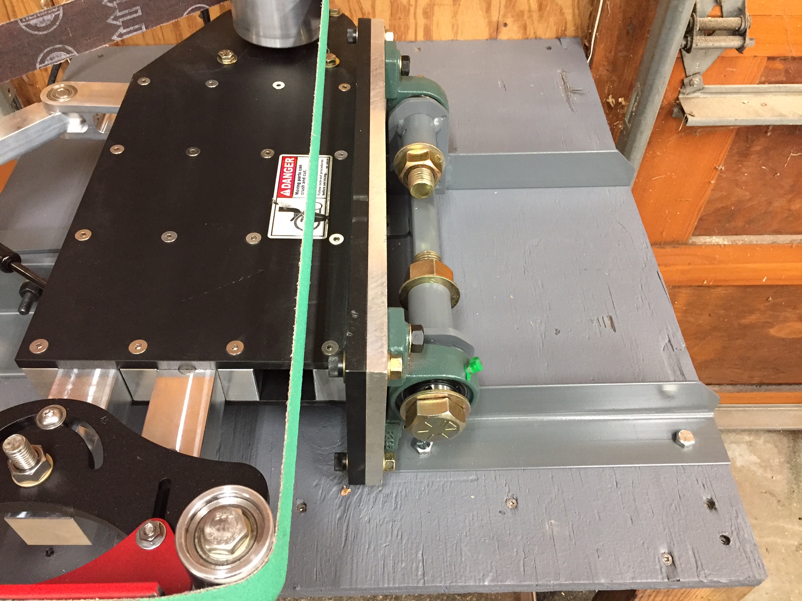

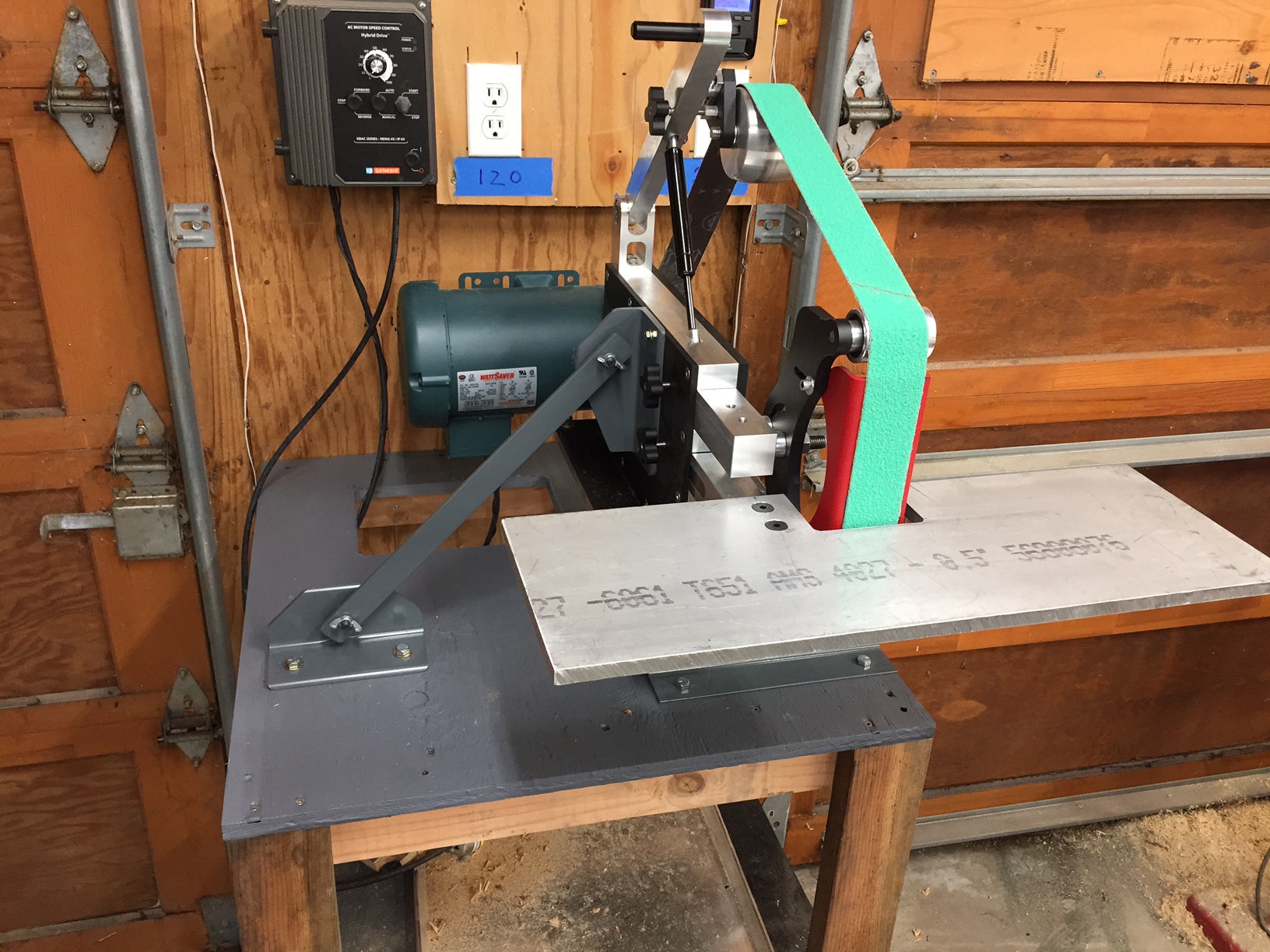

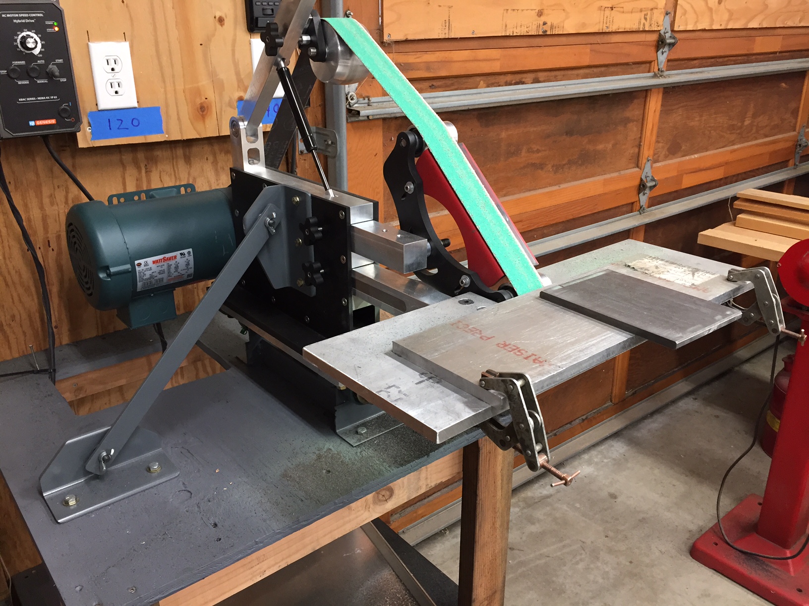

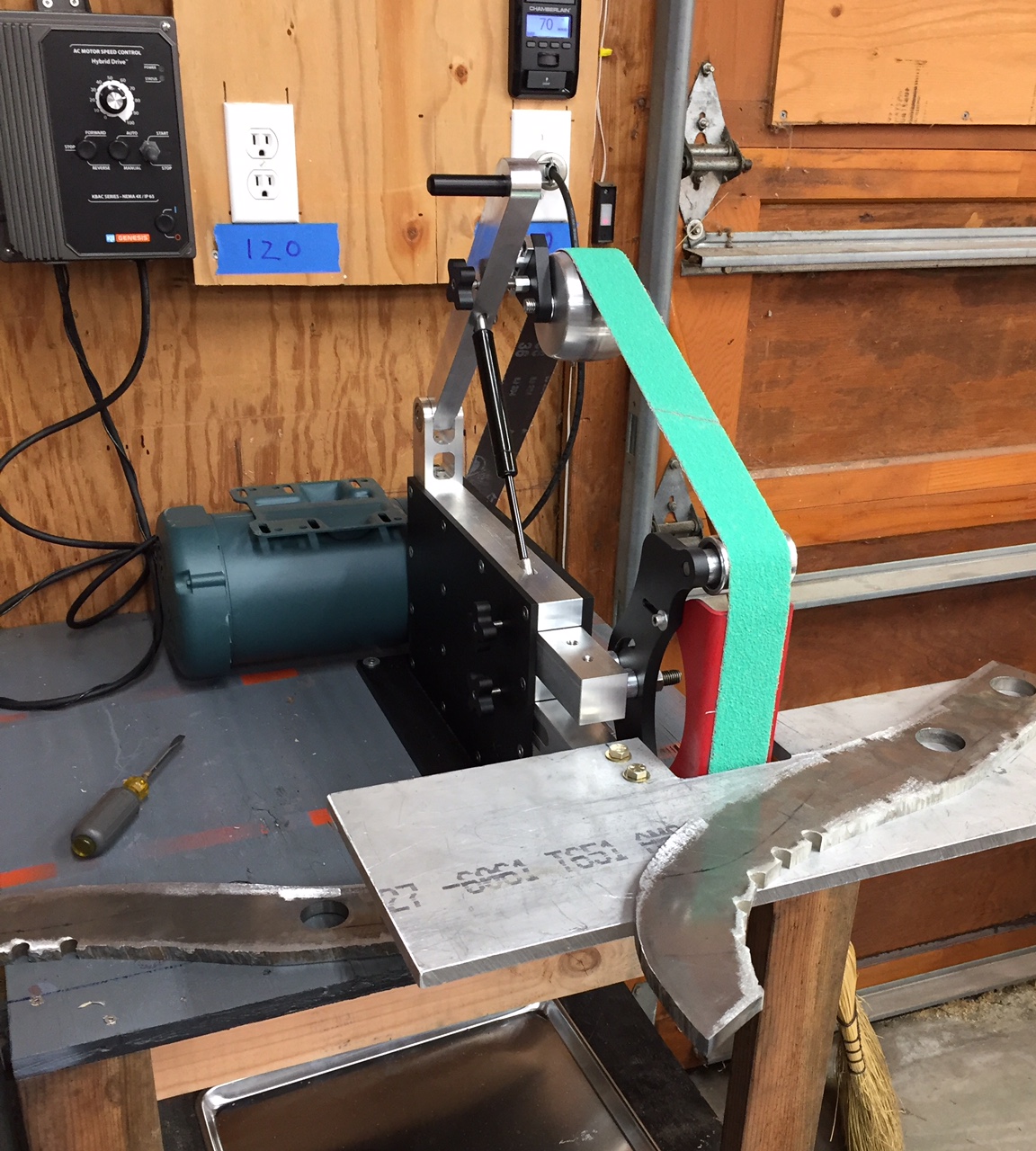

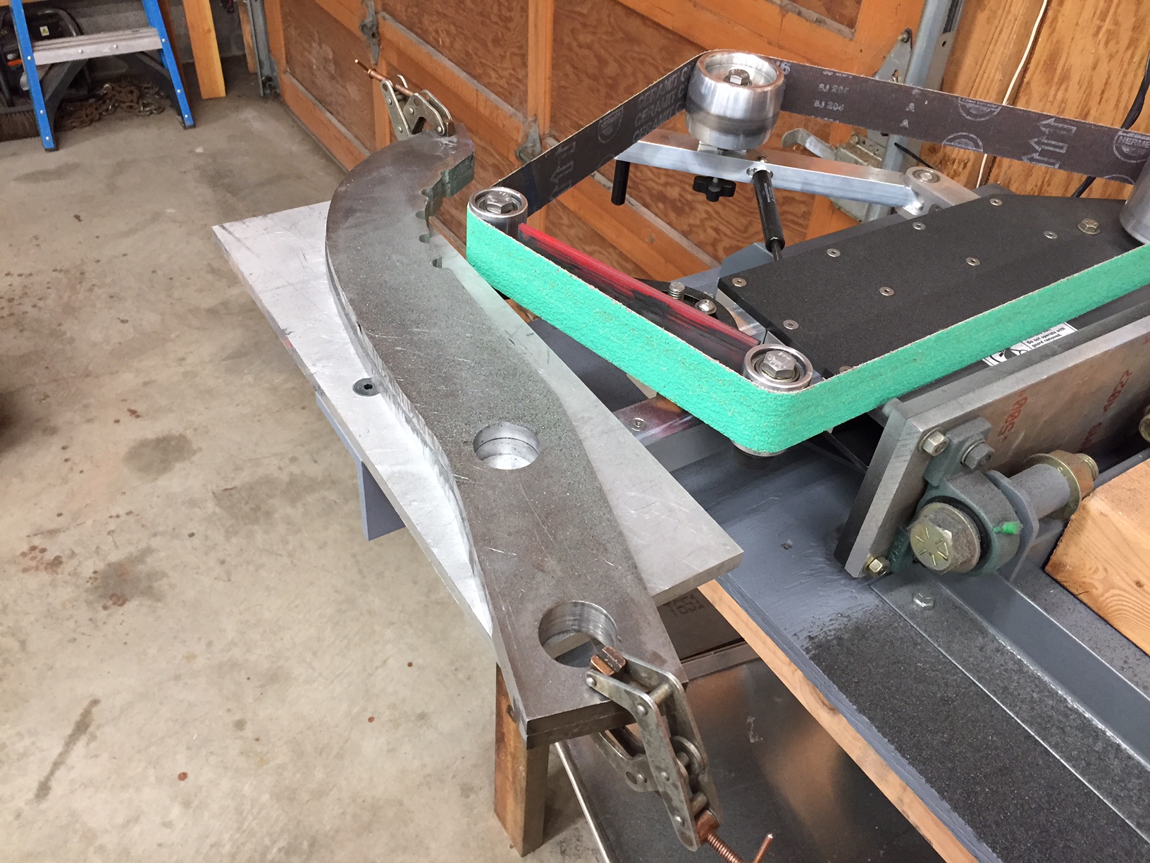

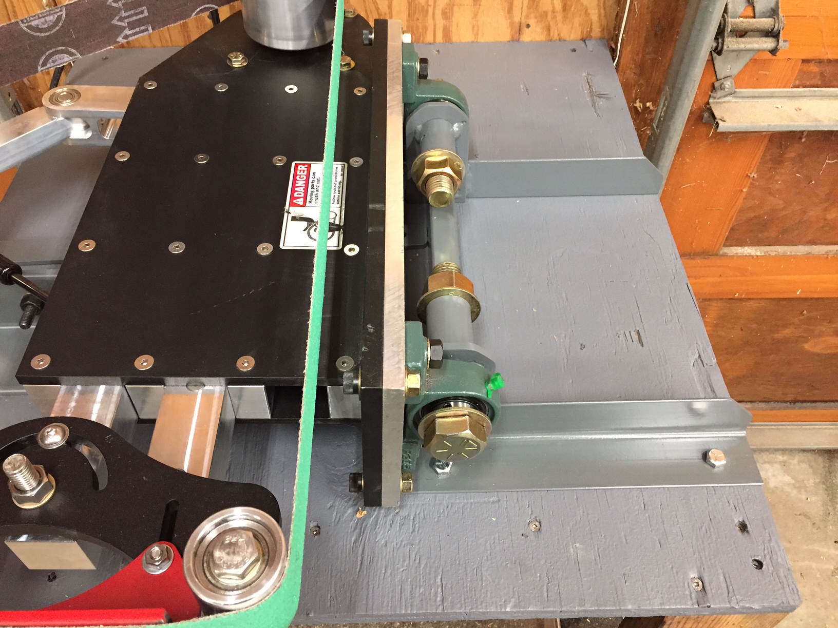

Got the hinge made, works well.
Photo 1 - Grinder in vertical position. You can see the brace that holds it in place and a hole in the bench, which is what the motor rotates down into in the horizontal position.
Photo 2 - Grinder in horizontal position. I made a work table out of 1/2" aluminum 6x18.
Photo 3 - The hinge. There is an adapter plate of 1/2" aluminum that bolts to the machine base on one side and to two pillow blocks on the other. I got the pillow blocks for $7 ea. Then the main hinge frame, welded up from scraps laying around. The hinge pins are 1" bolts left over from something else.
All the bolts that go through the bench have large heavy duty plate washers on the bottom side to keep the fasteners from sinking into the wood.
First project is final shaping on my new backhoe thumb, and bevelling of the cross pieces for welding.

Wow. Nice job on the hinge. I need some of those $7 one inch pillow blocks!

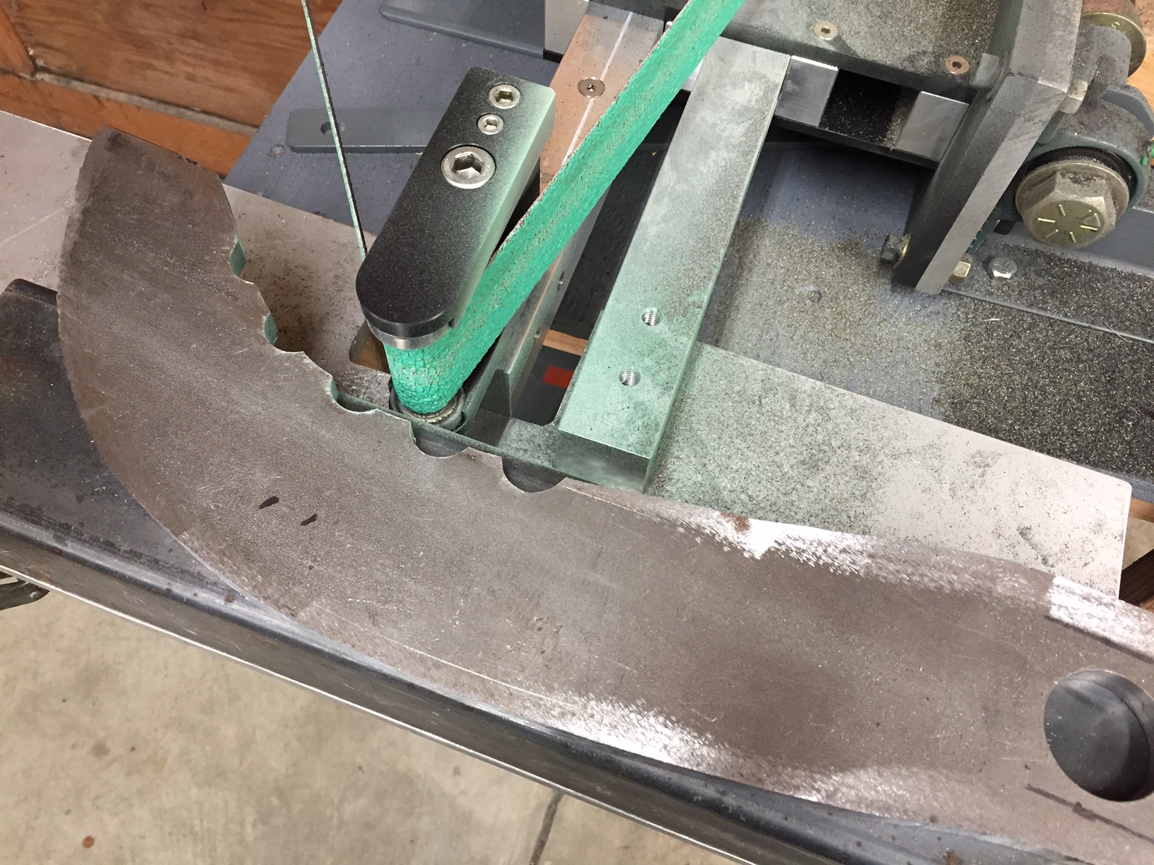

This grinder is a BEAST. I am cleaning up and matching the two main parts of the new backhoe thumb. I am not the world's best plasma cutter so there is a fair amount of cleanup to do.
It is possible to remove too much metal in a twinkling. They are 1/2" steel.
With a few adjustments it is very easy to grind both inside and outside curves.
Have to think about cleanup, it throws crud all over especially in the horizontal position.

The horizontal position with your large table makes it ideal for grinding that thumb part!

I got a set of small wheels (1/2" to 1"). Used the 3/4" wheel for final shaping of the "teeth". Just took a few seconds for each one. Same thing for beveling the 3/8" braces. One pass at 3/4 speed.
Like the MIG welder and the plasma cutter, this is a tool I should have got a long time ago. Very productive. Have to think about some kind of guard though I have not seen any installed. I use full face mask and heavy leather gloves but even so that belt is traveling at 35-45 mph.
