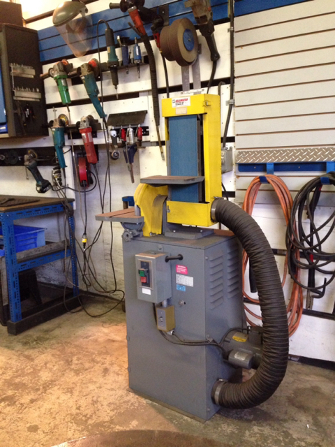

Jim, ideally you would have BOTH of the machines you posted pics of.
Combination machines (IMHO) should be called "compromise " machines.
Here's the Kalamazoo I have in my "same old grind" station:
It works fine, (has a vacuum system) but ideally I'd have the two machines (or similar) you posted.
Terry
I was just looking at some of the Kalamazoo products - they look like quality stuff - but expensive. For the price of one of the Kalamazoo setups I could probably get a decent 20" disc grinder and one of the 3x79 belt grinders.
