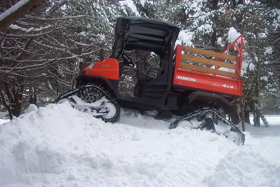

Can the other UTV's with only a belt for a transmission be outfitted with tracks or is it too much strain on the belt or lead to premature failure?
/ belts? #22
The belts are very tough. Out of 4 utv's I've never broke the 1st belt.
You can get tracks for atvs as well as almost any utv.
Many rhinos rangers and gators run them. With all wheel drive thats allot of torque to the ground.

How do you come to the conclusion that the only ppl that feel safe running tracks are rtv owners? (because one rtv owner post a pic of an rtv sitting in snow with tracks?)
The cv trans is proven tough and reliable. They have been around far longer than the rtv.
I wouldn't say the hydro tranny is anymore or less durable than the cv trans. Just different types. Both are subject to problems.
Do you remember this thread of the rtv with tranny hydro track problems? http://www.tractorbynet.com/forums/atvs-utility-vehicles/112802-1100-rtv-mattracks-beware.html
The rtv is an excellent machine. But it is not the do all for all vehicle. :rolleyes:

Some UTv's may not have an aggressive tread pattern but you can get them for any of them. My tracks weigh 900 lbs (4) thus far I have hit a few rocks and no problems. I watched just a bit age a Polaris with Soucy tracks on yourtube pulling a groomer in Canada. They weren't having any problems. I cannot speak about other UTV's because I have only had an RTV. Therefore I have nothing to compare with.

I have seen and heard from several real owners of RTV's with tracks on the numerous sites I visit, never seen or heard from an belt machine owner who has one with tracks. Thats why I asked the question. The snowmobile clubs use the RTV with tracks almost exclusively to groom trails.The two clubs in my area use RTV's although all the major manufactures are nearby.The only issue I heard of with the tracks on a RTV1100 was a design flaw with the tracks and not the machine.
I have trouble believing that a single belt is as durable as a hydrostatic transmission, which is a tractor transmission, but, I am always willing to listen to reason, thats why I would like to hear from a belt owner with tracks so I could have the benefit of thier experience.
The initial inquery was whether there was another brand with the durable Kubota hydrostatic type transmission or some other type of trans that was not belt driven. My question was aimed at hearing from the belt owners who have tracks to see if the belt is realistically capable of handling the tremendous drag of the tracks or perhaps they might warn against it. So, again, I would like to hear from a real owner of a belt machine who is running tracks so we all could have the benefit of thier experience.

There are three RTV owners on this site with tracks, Deerlope, Culater and a snowmobile club. On compacttractorreview there are also three. Every snowmobile club I know has the rtv with tracks. I am not stating that the RTV is the end all be all I only would like to know why it seems that only RTV owners seem to have the confidence to run tracks on thier machines. Again, if someone out there has a belt driven machine with tracks by all means let us know what your experiece has been so we can have the benefit of your wisdom.
