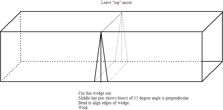

Personally, I would cut out a triangle, leaving the back on, then bend and weld. But I don't have a good shop.

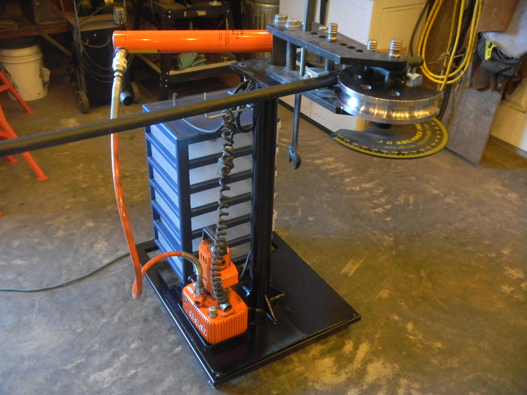

I have a pipe bender, i had to put an arch in a peice of square tubing as well. I took and put the 2inch square in the pipe bender on the 3 inch mandrel. I heated a large section of the tube and slowly used the bender to make my arch.

IF you need a tight bend, I am afraid the only way would be to cut a triangle out. Otherwise, the sides will buckle and it will look like crap. Being only 3/16" thick, a slicer disk on a 4-1/2" grinder will make quick work out of it. Or if you have a bandsaw, set it to 7.5*, cut it all the way through, rotate one of the halves 180* and weld.

Here's a picture of what I was talking about.
That's a thought! What was the thickness of the tubing?

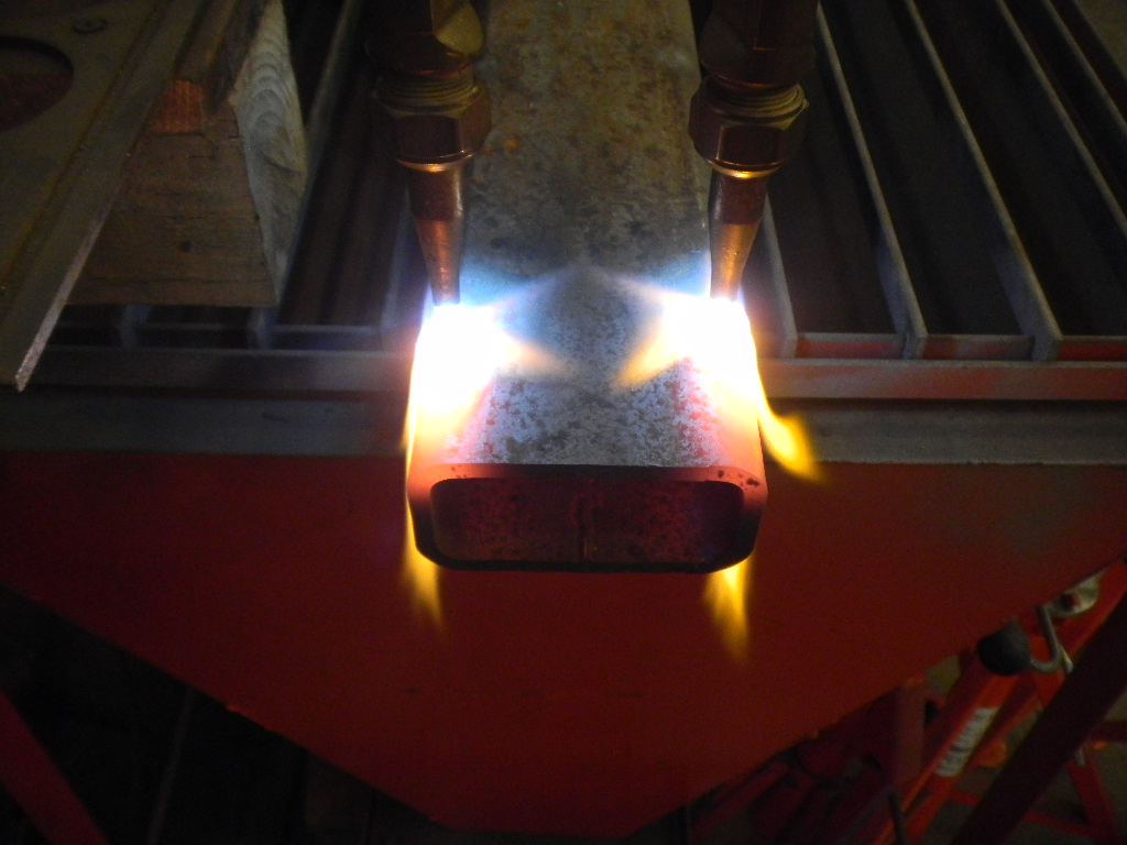

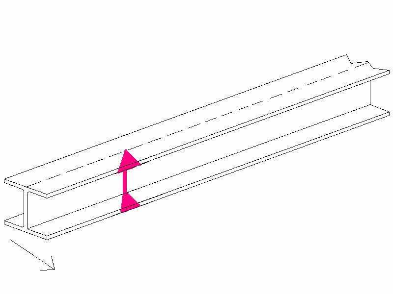

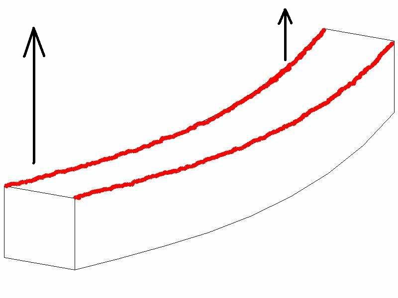

Got a torch? Heat a small wedge in the side where you want it to bend. First picture is of a beam, but same technique.
If you want a slow bend heat the heels of the box tube.

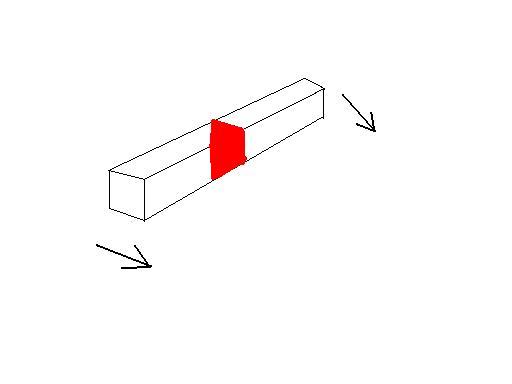

Here is a quick and dirty drawing of how to heat shrink square tube.
It was only like 1/4 wall. Nothing to heavy. I would bend a section roll it down the pipe bender and do another part of the arch. I had to make the arch follow the frame of an atv. It attached at the rear 2 inch receiver then follow the frame forward until it arched it up following the skid plate.
