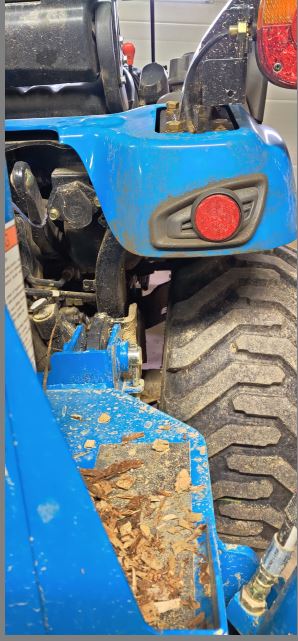

I noticed that one of my back tires is bent in. The other tire looks straight. At first I thought maybe the rim is loose so I jacked that side up and the tire is on properly. Could it be a bent Axle. If so is that covered under warranty? Thanks
/ Bent Axle? #4
Does it turn evenly and not wobble?
I guess also, there is Axle as in housing and Axle as in Shaft. Housing should be cast and not bend, shaft should be steel, can bend and the wheel would wobble.

Measure from the tractor to the rim top and bottom both sides and see what the difference is ....

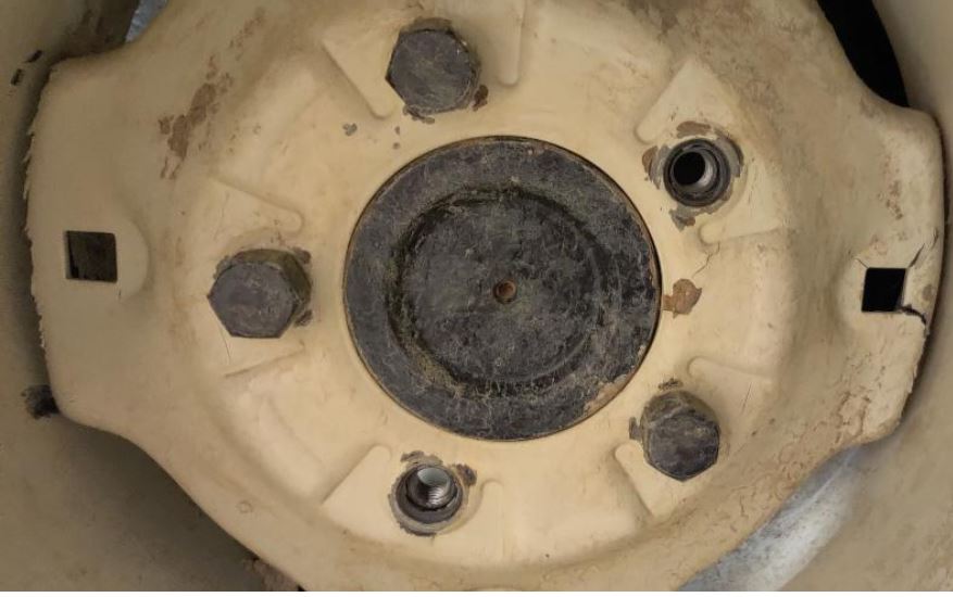

/ Bent Axle?
I found the problem. Looks like the rim is coming apart. I guess it's welded and not one piece. I'm going to call the dealer tomorrow. Does anyone know if I can bring it to any dealer?rim.JPG

That might be one of the wheels that is made up of a inner hub, ring, and outer hub, and made to allow different orientations (standard/narrow, flipped/wide, etc). It could simply be coming apart because some of the bolts came loose or fell out. I think if you study it, that would be obvious.
/ Bent Axle? #15
It's also cracked.
That is often a result of loose lug nuts/bolts or loose clamping nuts/bolts. Once the wheel comes loose, driving on it will cause cracking. Too many people find that out the hard way. Super important to check all the wheel lugs and bolts periodically. If the cracking (or any wallowing) is right around one of the bolt holes, you have found your smoking gun.
Can you post a picture of the whole inner rim, so we can see all the bolt holes? And if any fasteners are missing or loose, indicate if those were removed or lost. I would bet there is a high correlation between the cracks and any missing or loose fasteners.
/ Bent Axle? #16
It looks like in the picture that the left side has broken free and the right side is cracked.
/ Bent Axle? #17
Are there suppose to be bolts in the square holes of the inner rim that connect it to tabs on the outer rim or did welds break?
You’re also missing 2 lug bolts that hold the inner rim to the axle.
/ Bent Axle? #19
Yeah, did the OP take the lugs bolts out? I don't think these wheels are adjustable for width, but I'd have to check mine to be sure.
Henderson ain't but a hop, skip and a holler from LS Corporate. I think a road trip might be in order.
/ Bent Axle?
#20
The first thing I did was to remove the tire. Pulled two bolts and saw that the inner part of the rim was damaged. The bolts we're all tight. Just a damaged rim.
