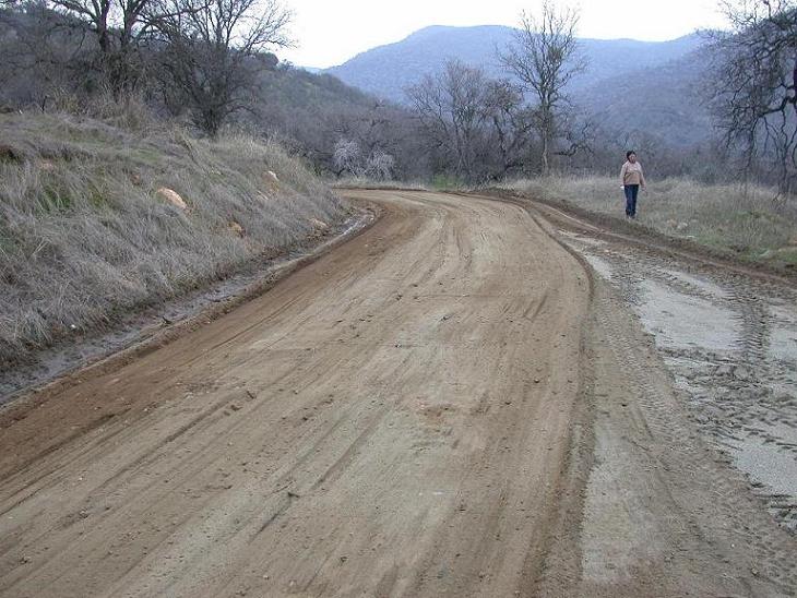

You know I've been cutting gutters with the box blade and it works real good by tilting the heck out of it...(see picture...see the gutters and how nice the road looks with boxblade..no leveling wheels yet)
In doing so, I noticed that the down side (cutting side) appeared to be farther back fron the tractor than the up side. So the boxblade was not only tilted, but angled slightly too. Well, cutting those gutters in represented no match for the tractor so I toodled along nicely.
To my surprise, the 2 scarifiers I had down on the cutting side had both bent towards the edge of the box. So "Yes" they were cutting at an angle and bent because of that.
Of course I hadn't read your post before this, and not thinking anything of it at the time, I went ahead and tilted the boxblade the OTHER way so I cut cut the other side of the road. Hence the nicely, equally bent (mirrored) scarifiers.

Also, thanks everyone for the input and the links to the scarifiers. I thought I'd put one more pic in of the road to show the gutters and also that using the boxblade correctly, you can get a pretty darn smooth, beautiful road. At least my lovely wife and dog think so. /forums/images/graemlins/confused.gif
