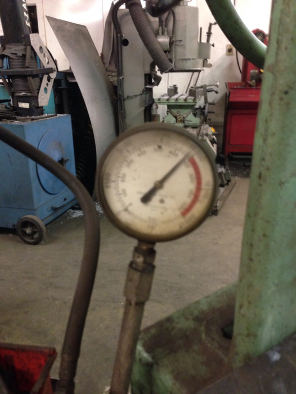

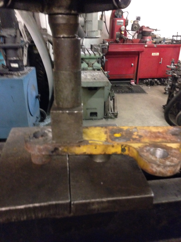

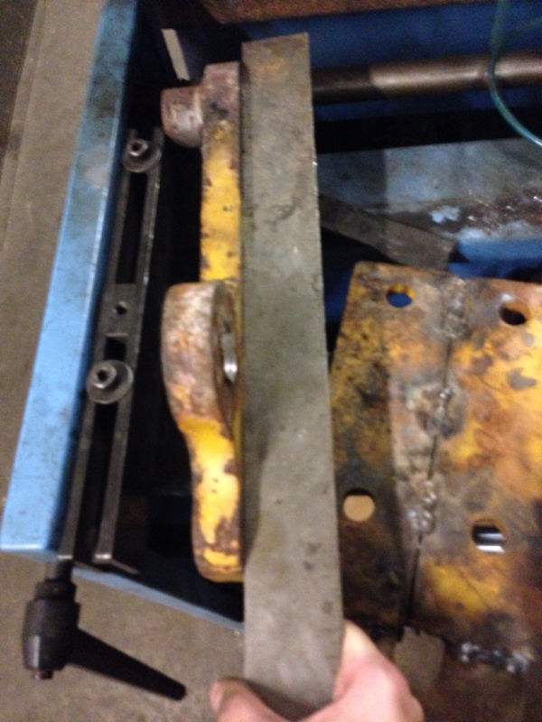

Here is what I straightened today. This was 1 inch thick and 3-1/2 inches wide. It was bent in a steeper radius than the bucket. It was bent about 1/2 inch over a 8 inch length. It was all my 30 ton press wanted, but I got it within about 1/16 of straight with no heat. You are only fooling yourself saying a bucket can't be straightened. image-2315228695.jpg image-2930193881.jpg image-2228933691.jpg
   / BENT BUCKET #27
What did you do to bend it if a 30 ton press barely bent it back?
