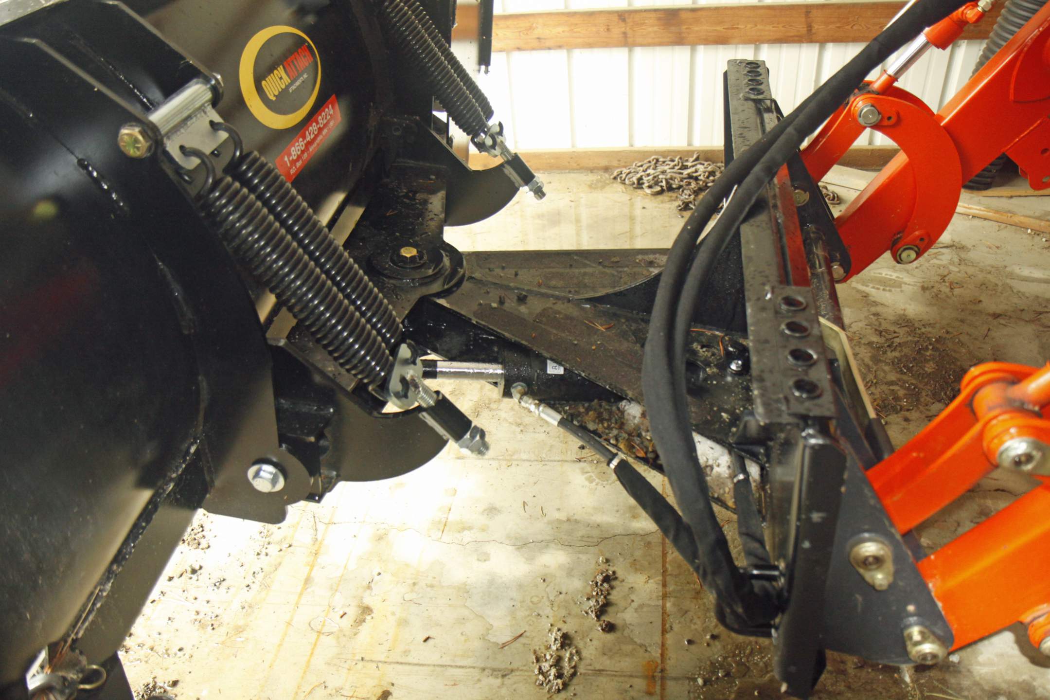

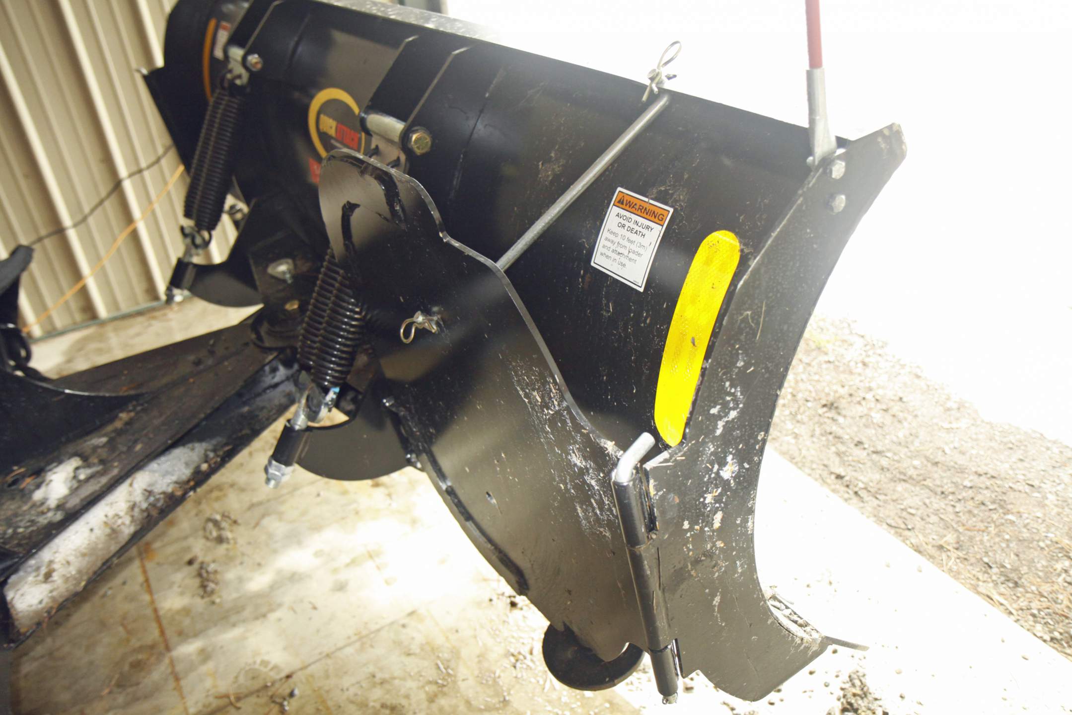

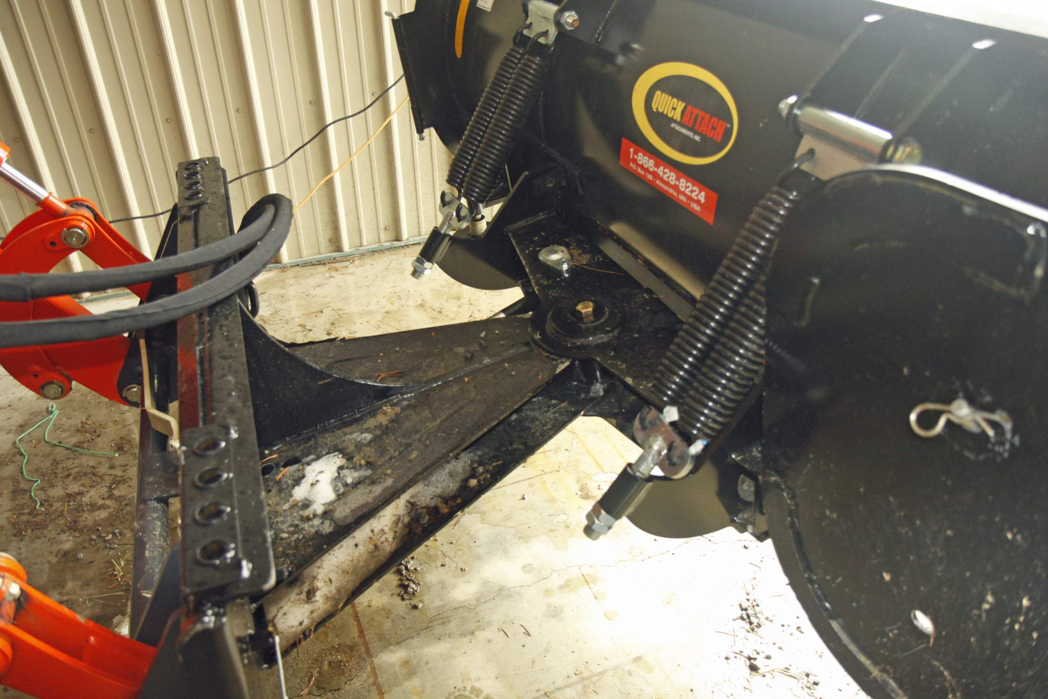

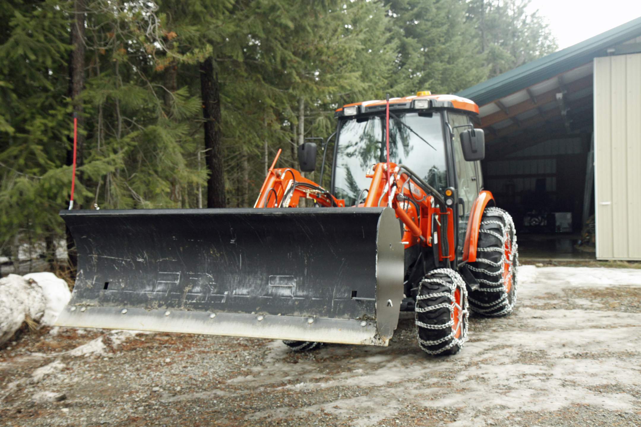

I now have 2 seasons with my Quick Attach brand loader mounted plow. Its a 84" wide plow with 4 quick trip springs. Works flawlessly as long as i chain up all 4 tires (otherwise it tends to drift when blade is angled)

it may be hard to find many/any people who have experienced a failure this way, because most people won't put themselves in the position to experience it. it's basic physics really:
look at your loader arms - the width is less than the depth of them, because loaders are designed to lift vertically.
look at the floor stringers and roof rafters in your house - they are positioned vertically for strength.
go out and see if you can find someone who framed the floor of their house with 2x12's laid flat and let me know how the search went. this is a little extreme of a comparison, but it's the same principal. loader frames are designed to take vertical loads and not necessarily lateral loads. they will certainly take some lateral loads but many people will avoid doing it - particularly with smaller equipment.
my tractor is a jd770 and parts of the loader frame are 3/16" plate bent into a c-shape. i know this can take some lateral loading, because i've smacked into a few things over the years and it hasn't fallen apart yet. i would put a straight blade plow with a trip edge on if i didn't want to use the bucket but i wouldn't consider using an angled blade on something this light. stumps, rocks, and frozen banks are going to put a lot of repeated stress on that frame if i do. if i had a heavier setup i might, but i would have to look at it and evaluate whether i thought it was up to the task.
