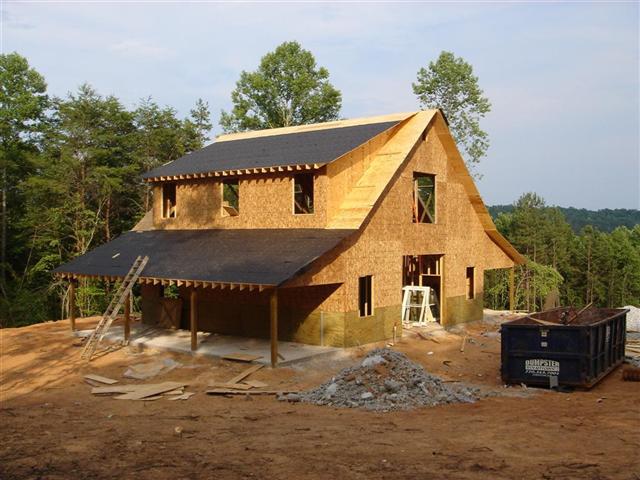

One more...

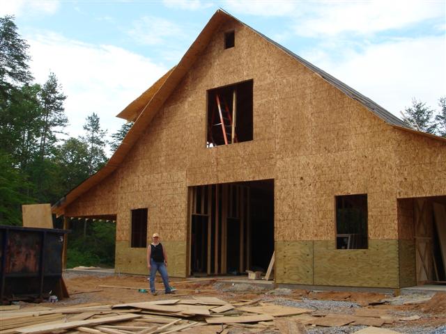

Oh yea, HAPPY WIFE, HAPPY LIFE...
