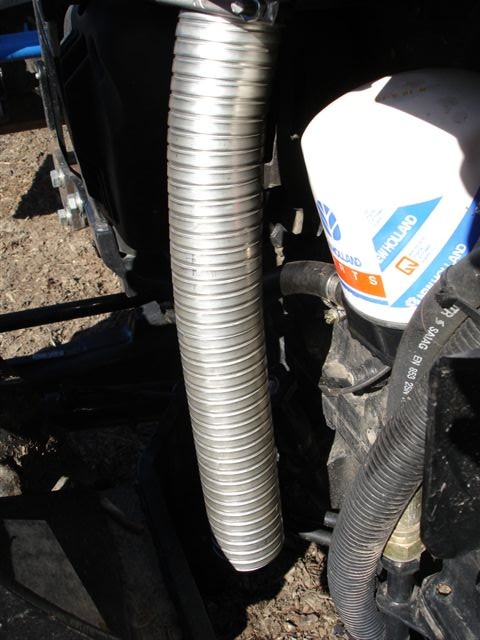

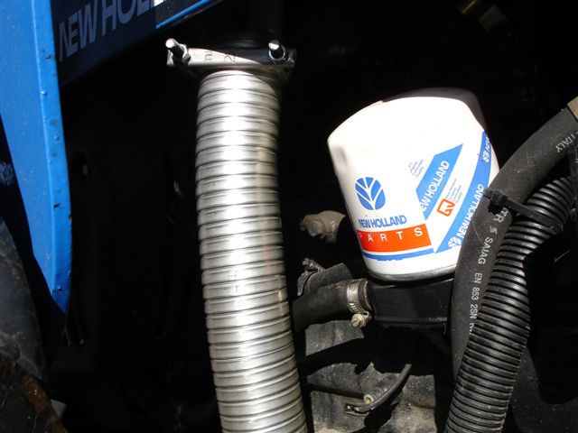

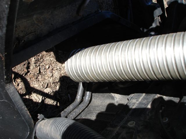

Well, after all the excellent advice here, I removed the bent exhaust and atttached a 18 inch flexible exhaust pipe. I am happy to report that the tractor runs fine. The exhaust is "clear" (no obvious smoke or particulates) and although the pipe gets hot, the exhaust is remarkably cool at the tip. After running it for an hour on a cool day (40 degrees) none of the adjacent parts get warm (the oil filter does, but that is to be expected). If the flexible pipe was 6 inches longer, it would clear the frame completely and might even be a permanent solution :D . Maybe some nice black exhaust paint and no one would ever notice?

Chrome :D ! Sounds nice. Maybe hang some nice nice on the dash while I am at it with the chrome pipes :). One friend described my flex pipe solution as "ghetto". I will dry fit the new pipe next week and see what happens. IF all goes as planned, I will have the bent pipe fixed and then have a spare I will never need since I will not reuse the 4 inch extension and therefore never bend another exhaust pipe.
