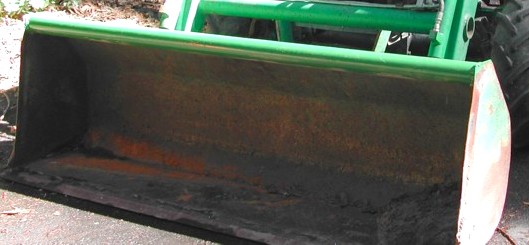

I have been thru this several times. If the bucket is not
bent too bad, then I use heat, hydraulic jacks, come-alongs,
and a sledge hammer.
Pictured is a JD bkt that was too far gone, and work-hardened
from previous repair attempts. The carcass is only 1/8" thick.
My local tractor dealers had weld-on cutting edges, but they
wanted $300 for a 6-ft piece. I found a chunk of beveled plow
steel at a steel dealer for $60.

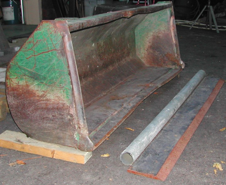

   / Bent FEL Bucket #13
And here is the result. I cut out the top edge and the whole
bottom plate with a plasma cutter and welded in the sched 40
pipe for a strengthened top lip. I welded in a new piece of 1/8"
x 10" steel for the bottom, along with the 1/2"x6" plow steel.
Managing the heat is important to avoid warpage. No continuous
welds.
The resulting bkt for a JD 955 is better than the original was new.
