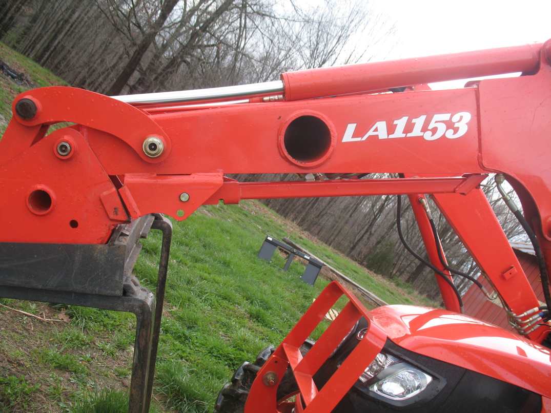

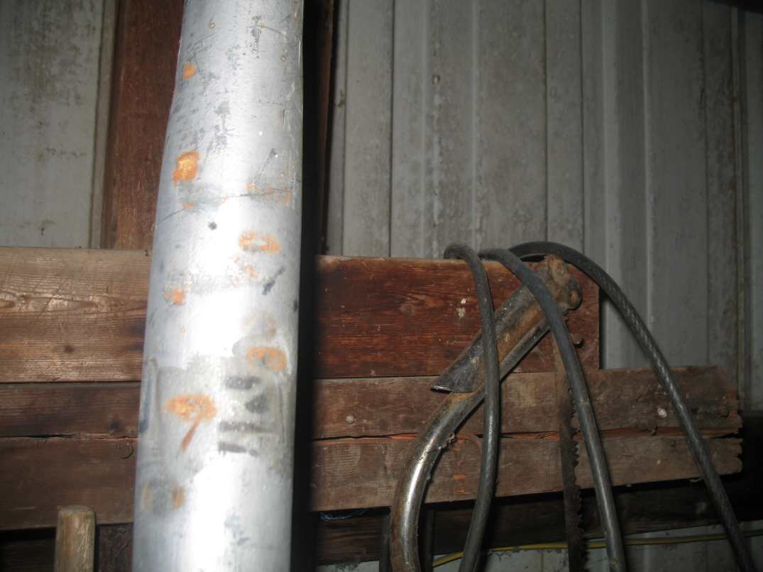

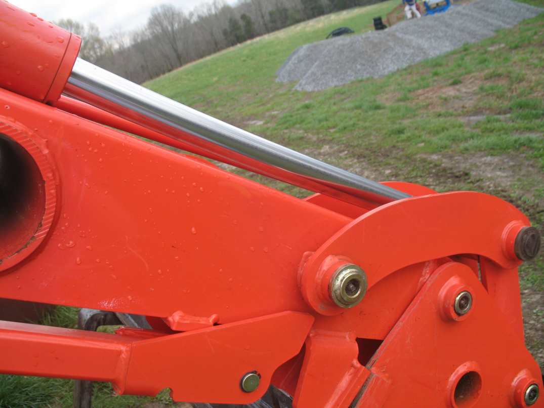

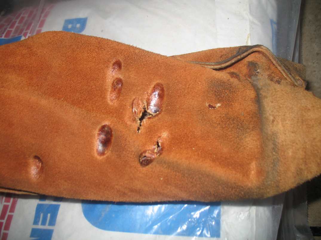

...Use your dump on the fel (extend the cylinder) and go slightly past straight when bending it back and check it. If not straight enough, do it again with a little more bend at the wedge...
One thing I've learned doing stuff like this is start out at low engine RPM's. Slow and steady is key to this type of procedure working.
   / Bent Hydraulic Cylinders - Now what?
#13
I have to say I am one happy guy tonight! Sitting back drinking my reward for a job well done.
pics 1 and 2 are before shots. Bend was pretty good.

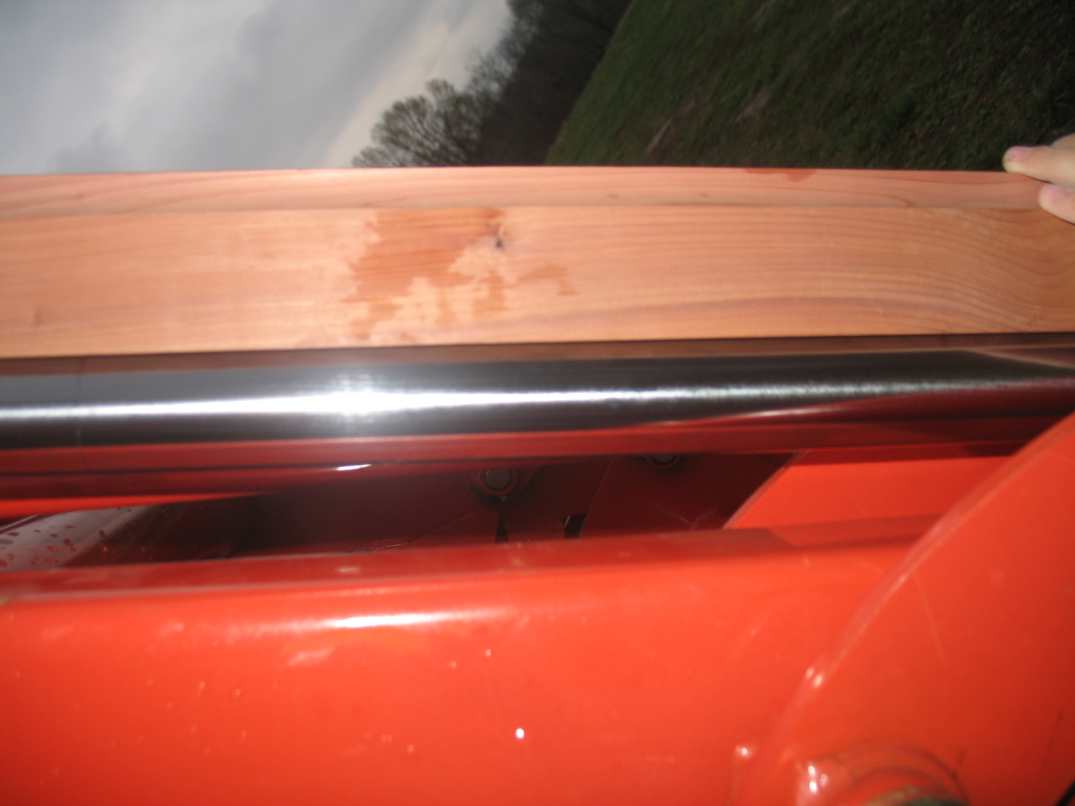

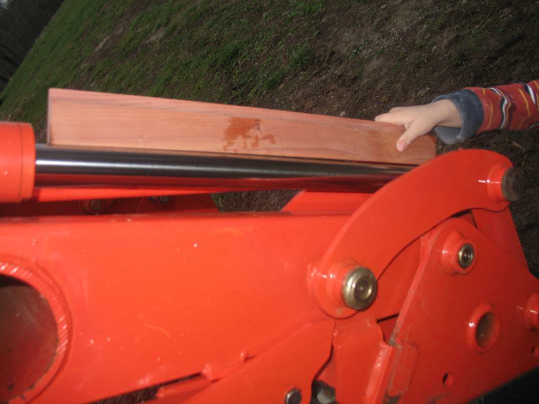

Pics 3 and 4 are after shots.
Pics 5 and 6 are of the leather I used and the pipe. The brown spots are not rust, thats leather on the pipe! Lots of pressure in there.
I could not believe the results! I was truly amazed. Even though in one of the pictures it looks like there is a small gap under the board, there really is not. Maybe I was asking too much of my three year old assistant :) The board is extremely flat as I put it on the jointer before using it as a gauge (mild woodworker; mostly precision cut firewood :).
Thanks a ton guys. Really did save the day!

That is sweet, have to remember that one in case it ever happens to me, was it like bending something springy where you have to go a little past what is straight so it doesn't just spring back?
