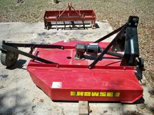

The lift arms on this howse shredder seem much sturdier
