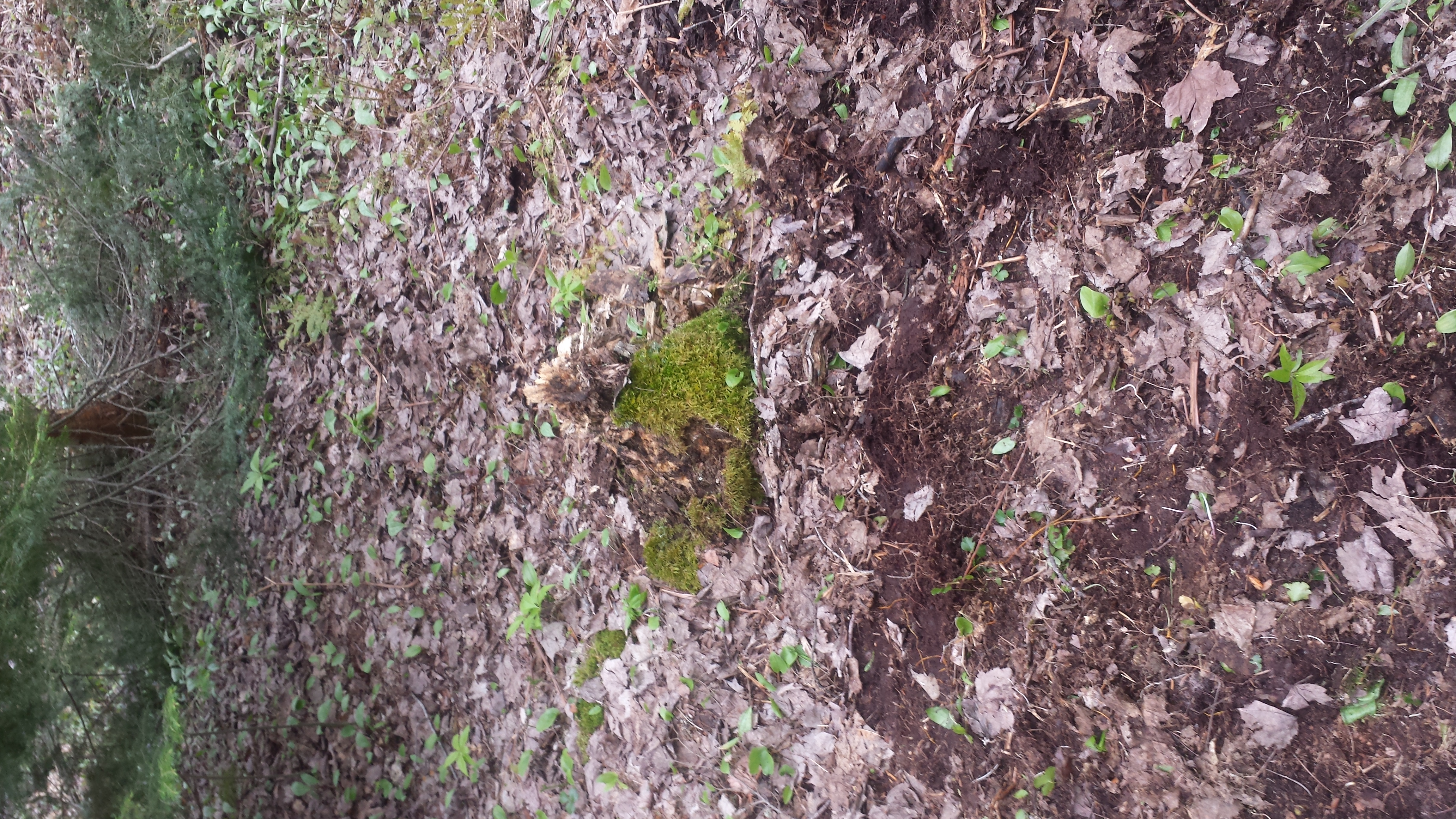

Looked innocent enough.
   / Bent my box blade mount, shorter top link? #33
Wow--that's disappointing to see, Those square tubes must be about as thin as the mast plates! The good news is: if they'll crumple that easy, they shouldn't be too hard to bend back. This would be a good archive photo for how the mast can be engineered to resist a pull, but fail miserably on a push.
Do you have a digging iron? About 6' long, 1" hexagonal... can exert quite a bit of leverage. I'd see if I could lock into that and gorilla it back... likely that'd fail and I'd start hammering the mast plates, then the square tubes, then back, and see if I could tap my way back near normal.
The bottle jack idea between the side links up to the mast is a good idea too.
Also would consider locking the top connection to an immovable object and trying the 3pt or pallet forks to lever it back.

Whoops. Now that I see the photo, if this was my problem, I'd cut that off and either fab up a new one or reuse the center top link bit and fab up stronger braces.
511144d1496154138-bent-my-box-blade-mount-20170530_100726-jpg
   / Bent my box blade mount, shorter top link? #36
Zerk, I bought a King Kutter rear blade oh 15 years ago and had about every weld on it to break, no major metal failure but soon learned that at least the blade I bought was not near the quality I thought King Kutter was.
I also backed into a thought to be rotten stump with a box blade and did about same damage you did. They just do not have the hitch material to hold up to back into what they will hold being pulling into same load. On my which is more like the other box blade I trashed the three point hitch and used I think 3 by 3 angle iron I am sure at least 1.4 inch thick but think maybe 1/2 inch even and made me new mount for the 3 pth. I really believe you are best off to remove the bent part at least cut it loose and reinforce with metal and have it all welded back to new bracing.
I doubt a 10 ton jack will straighten this for they do not bend metal like this with a slow pressure system like a jack they do it with a brake coming down on it with some right good speed. Same energy as slow speed would not give it the crisp bends it has.

The stump was way out in woods, it can stay their. I thought it would be a push over. If it gets way will cut down with chainsaw, it's just woods trail, actually more of a turn around.
