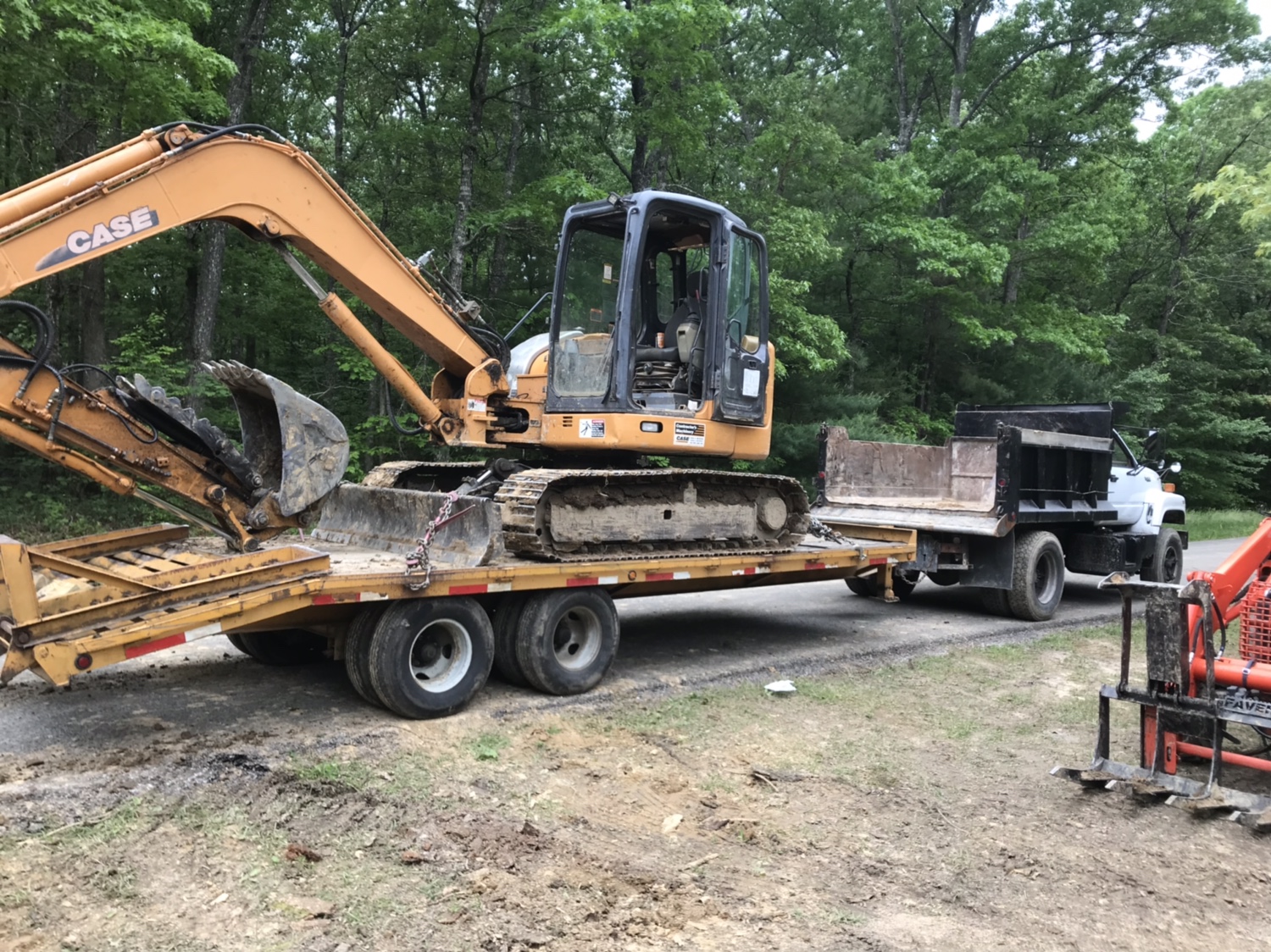

I plan on putting both machines behind my 6500 truck but my KX040 and a 75 skid steer is nearing 20,000 pounds without any additional implements.
   / Bent rods in loader arms? #18
Can you legally do it? Might be right at the max capacity?
   / Bent rods in loader arms? #19
I don’t even know what the rated tow capacity is. That’s not much more than my buddies 80 trackhoe and it handles it fine. IMG_8754.JPG
