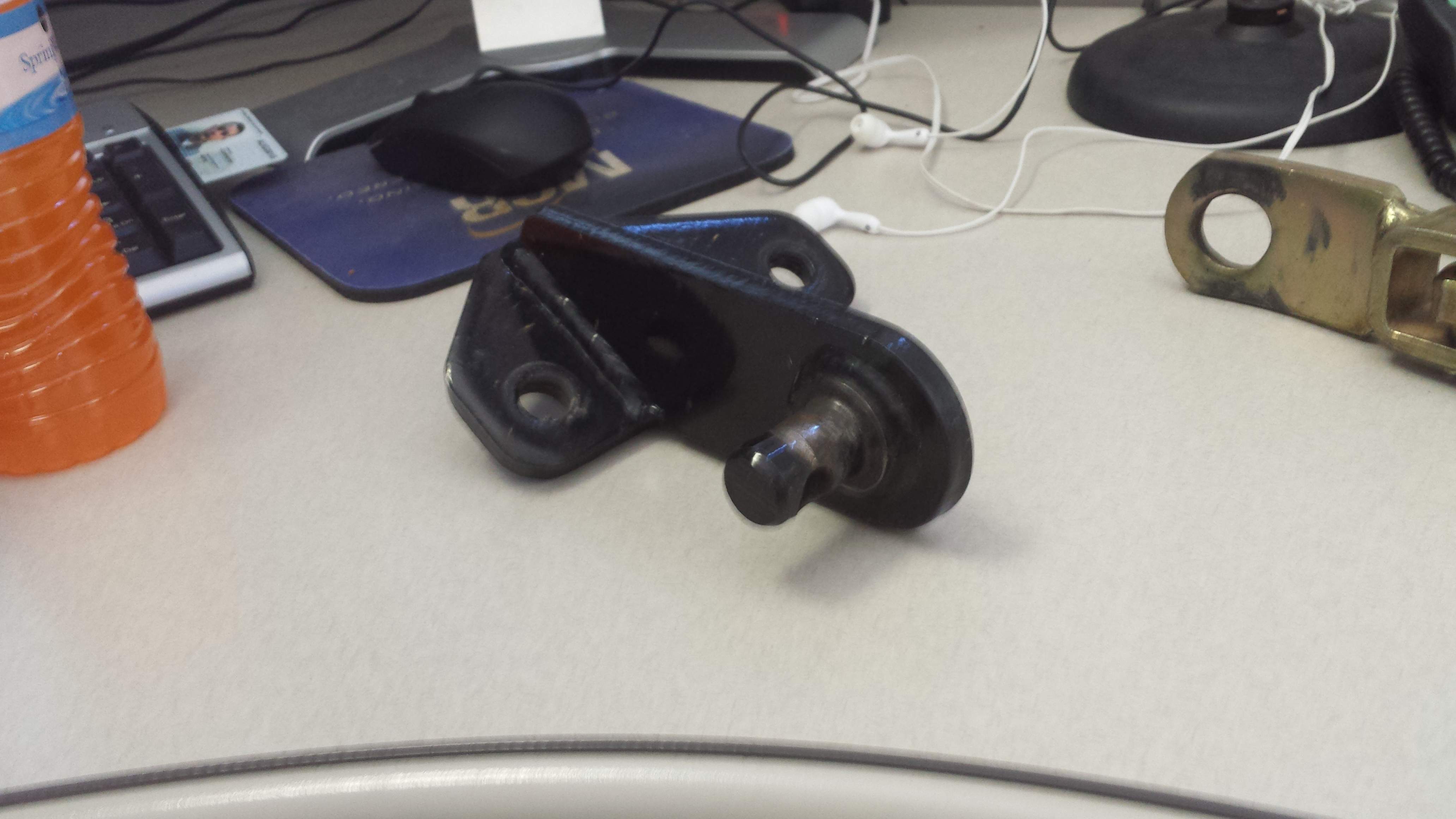

Here's the existing stabilizer bracket.

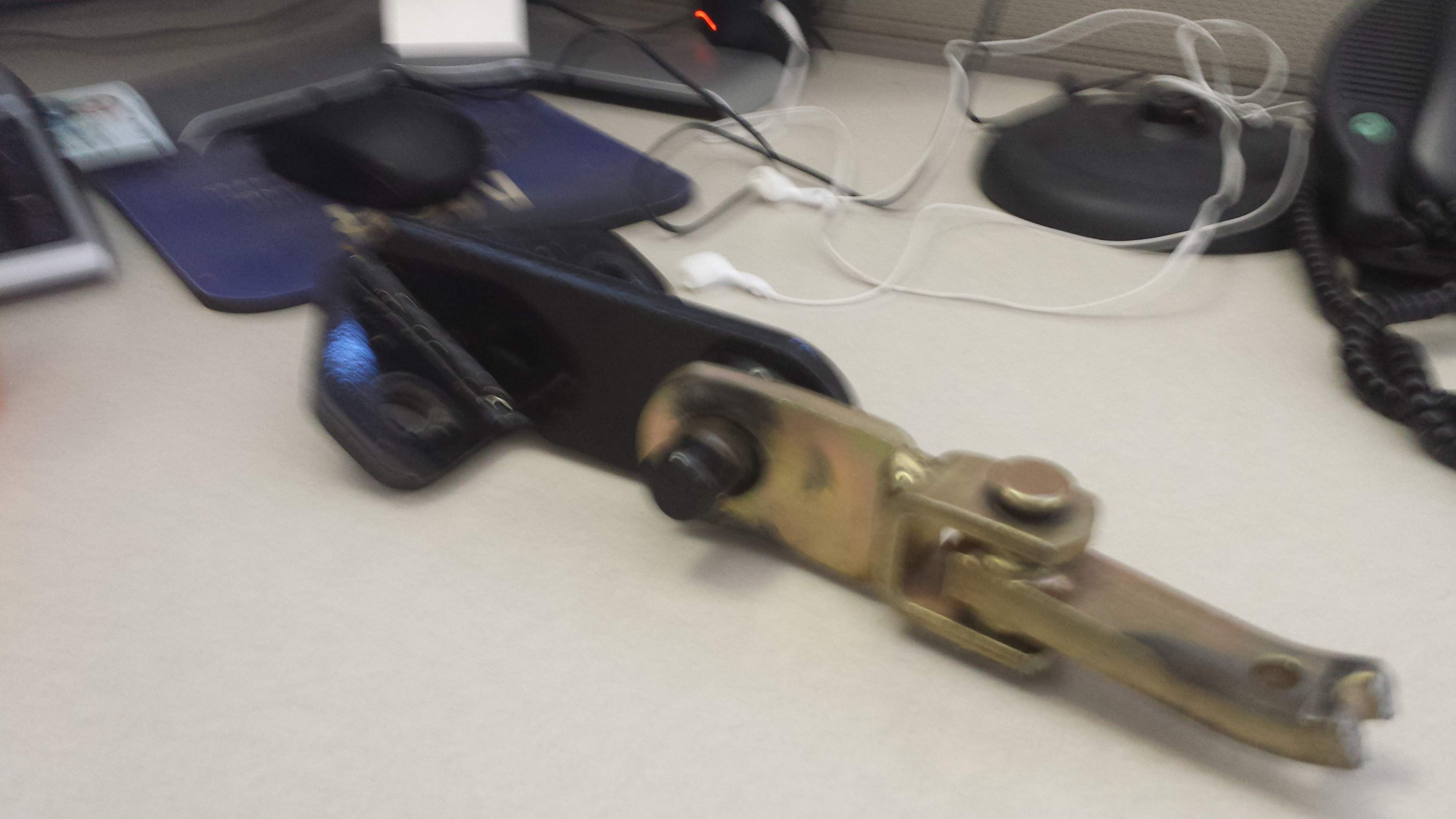

Here's the existing "pin and plate" setup that I broke.

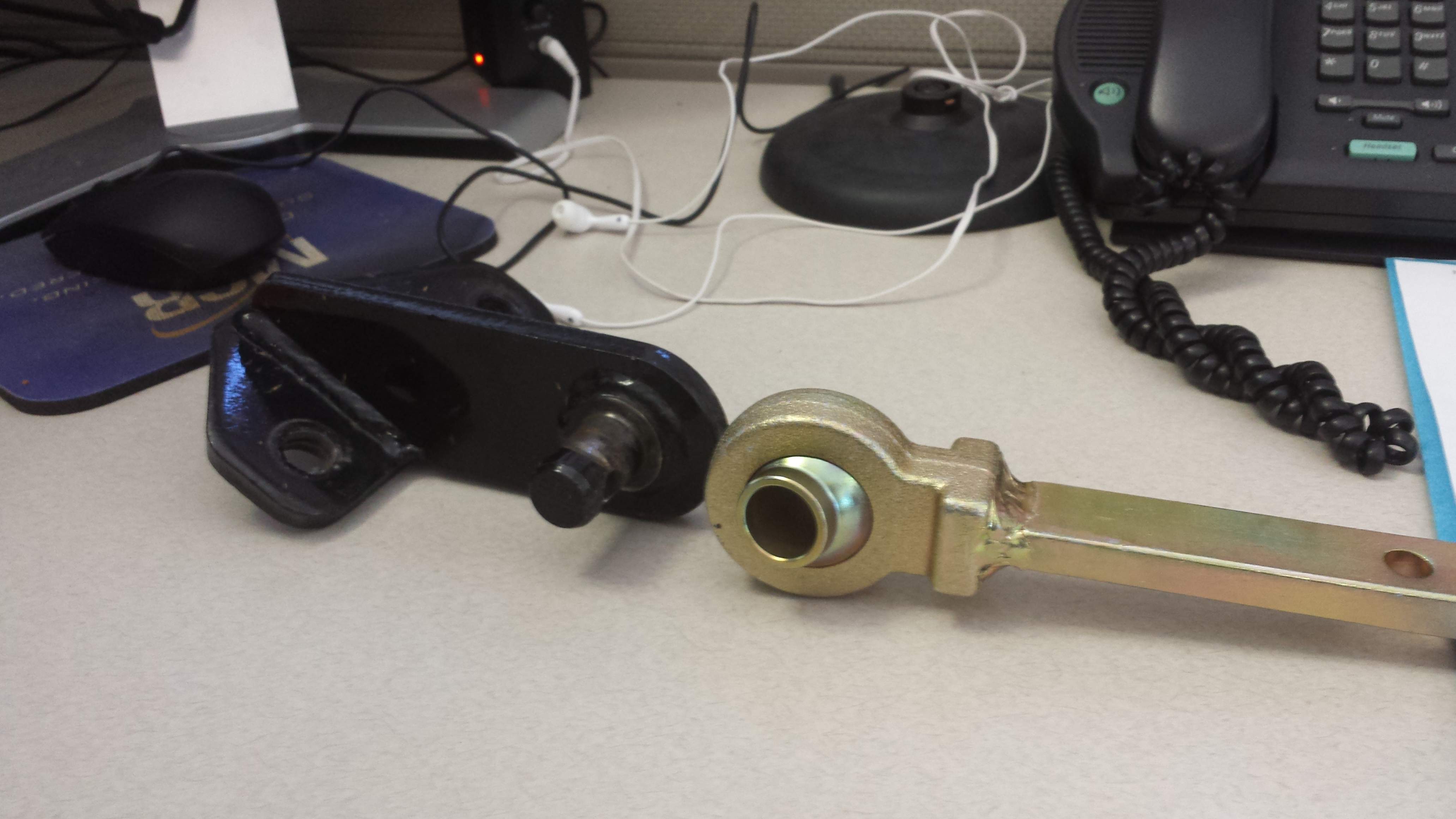

Here's the new stabilizer bar and the old bracket

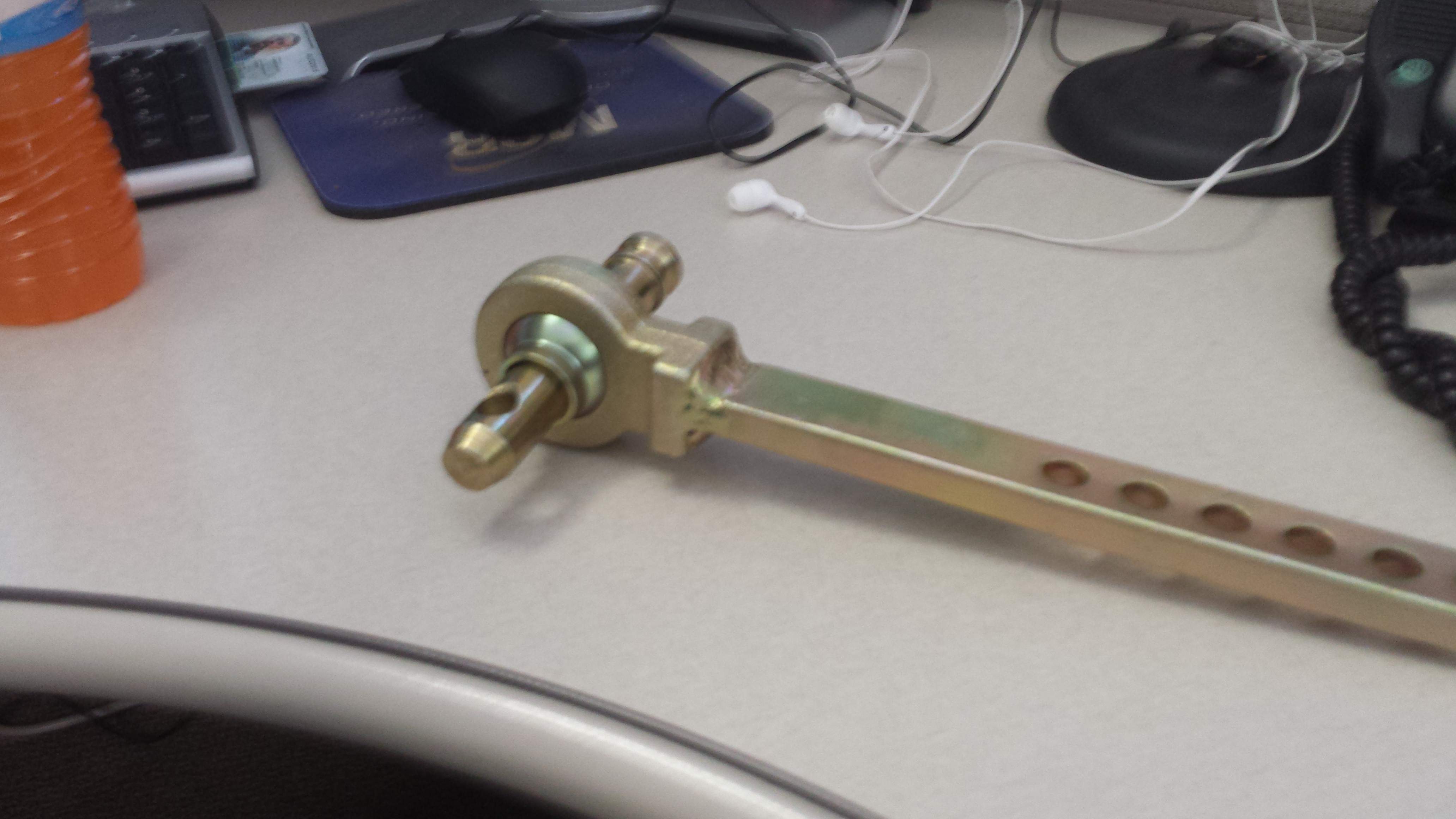

And the new stabilizer bar with a Cat 1 top link pin
The pin on the existing bracket, has too large an OD and is too short to fit the new stabilizer bar. I was hoping that I could cut off and drill out the existing pin and replace it with a either a Cat 0 or Cat 1 bolt in draw pin, but the ODs are wrong for both.
The working plan at the moment is to cut and drill the existing pin and weld in the Cat 1 top link pin, which has the right OD of 3/4". I thought about just getting a 3/4" bolt but it's a bit kludgy for my taste.

I have used bolts on that type ball end before. I like the fact that it makes it solid, no sliding on the pin, no pressure on the lynch pin.
I agree with your plan to cut and drill the existing pin, but I would bolt it. Just my :2cents:.
It is bound to be better than before! :thumbsup:
