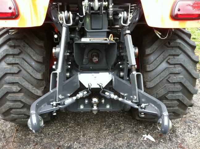

I disagree with some of the adjustment methods here. I cannot see how a pair of rigid stabilizer links can both be set so that both sides will be in tension rather than compression. It looks to me that when the implement is loaded from the side, the stabilizer link on that side will be in tension and if the other side will either be too loose or in compression....probably too loose so that the second side isn't in compression. But if that is so, what happens when the load is shifted to the other side? Then that first stabilizer bar has to be in serious compression.
I suppose one could very carefully set both stabilizers up for nearly zero side play of the implement. Then the inevitable compressive loads on a side wouldn't be enough to fail that stabilizer before the tension ability of the other side came into play.
The solution would seem to be to use sway-reducing chains instead of rigid bars.
luck, rScotty
Both sides, either in tension or compression are fighting each other. IOT not fight you must allow a little side sway. Depending on which side of the lift arm the telescopic sway links act on will determine the strategy.
... If, as on my 7520, they act on the outside, for tension you would set the arms a little wide so that the linch pin on one implement pin would come into play before the other lift arm hit the shoulder on the other implement pin.
... If, as on a BX, they act on the inside, for tension you would set the arms a little narrow so that the shoulders come into play alternately as the implement sways. The linch pins are never loaded in this case.
,,,larry

Does the BX have it's sway link pivots coincident with the lower arm pivots? IF so, then there are no tight or loose spots in the lift motion.
Sorta-kinda coincident. Photo below borrowed from another thread.
Hitch modification thread photo came from.
http://www.tractorbynet.com/forums/kubota-owning-operating/243273-bx25-3pt-modifications-2.html
Bruce
