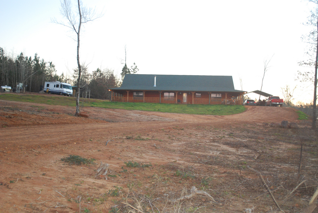

Eddie:
We purchsed hulled seeds. I did not have a soil sample done, the rye we planted came in pretty thick in the areas that we watered really well.
Do you think that I need one?
The front yard is really thick and green, the side is already starting to brown and die off.
We are planning on starting this the 3rd weekend of May..
Attached photo shows the front yard..

I'm in the same situation and I think with all of the transplants coming to Texas there will create a lot of seed and sod sales this year. I had to do a lot of dirt work around our house and shop and I had to hurry and get grass growing as I have a lot of runoff areas. I spread both annual and perennial rye as well as transplanted some bermuda ryzomes. The rye did great. I have the greenest grass in Ben Wheeler LOL. Bermuda seed is crazy expensive. $85 for a 5lb bag.

I planted 10 acres of bermuda when we built our house. I used a cheap pasture grass that germinates in like 4 days to hold the soil and broadcast the bermuda at the same time, and then use a spike too harrow (upside down with spikes up) just to put a minimal amount of soil over the seed. Bermuda can take 3-5 weeks to come up, depending on rain patterns.
In your case, I would disk it LIGHTLY just scraping the soil to loosen it up enough to cover the seed when you drag it. The seed has to be covered in order to germinate. But if you bury the seed too deep it won't come up at all. (ask me how I know). You already have the rye grass established to hold the soil, but now it's compacted and you need to loosen it up a little.
And if you can, plant the bermuda right before several days of off and on light rain.
