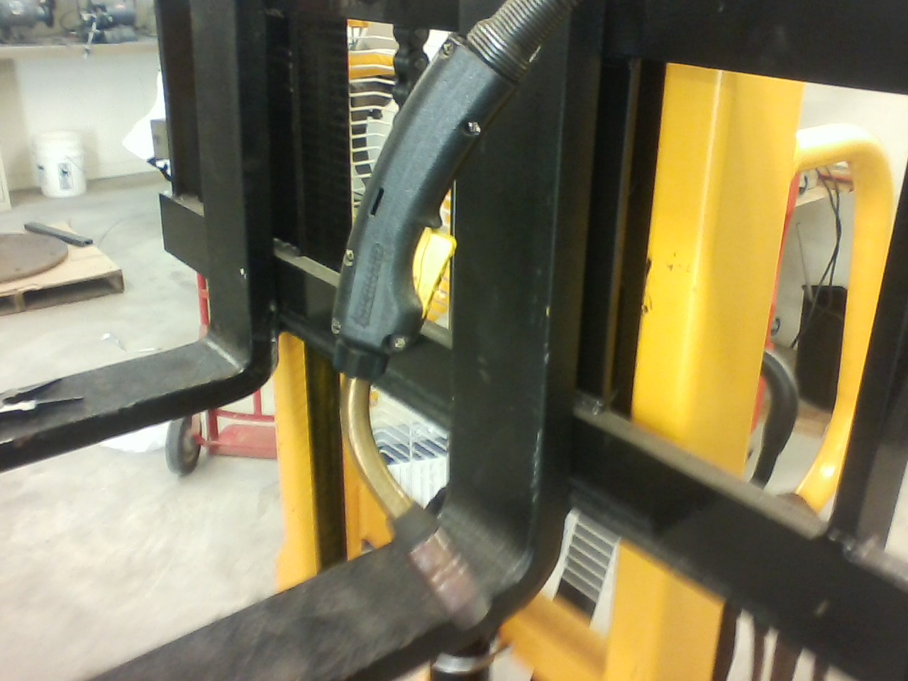

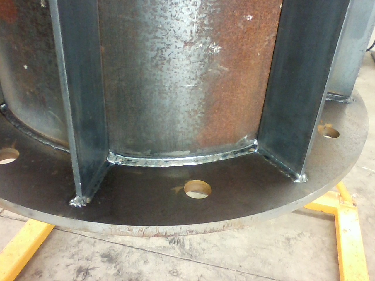

Finally got around to setting up the flux core on my dual feeder. I got this Bernard whip with some other stuff that I bought and thought I might as well give it a try. So far so good, but before I buy a bag of tips and some nozzles I thought I'd get some opinions from some other users.

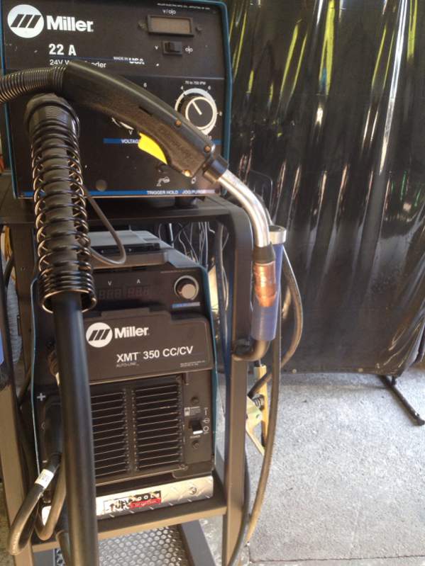

Mysfyt. Wish I had a dual feeder!
I have two 400 amp Bernard's with Centerfire tips. Just started using one lately with ."045 Lincoln Outershield. I like the gun but don't have enough experience to notice any drawbacks.
For smaller, lighter gauge projects and tacking I'll use another machine with with a smaller gun.

I know its not a very good picture, but can you take a guess at what amperage this gun might be?

If I had to guess I'd say 350-400 amp. Bernard doesn't make any obvious markings as to determine amperage ( that I've noticed).
BTW nice looking weld!! Are you using gas shielded flux core? Wire size ? Amps? Volts?

Thanks! I would think that amperage would hold up for a while.
These are the specs: Kiswell 71TM .052 flux core/straight Co2/27 volts/ Miller XMT 304

Looks just like my Bernard Q-300 250amps. Have two of them and they are flawless.
