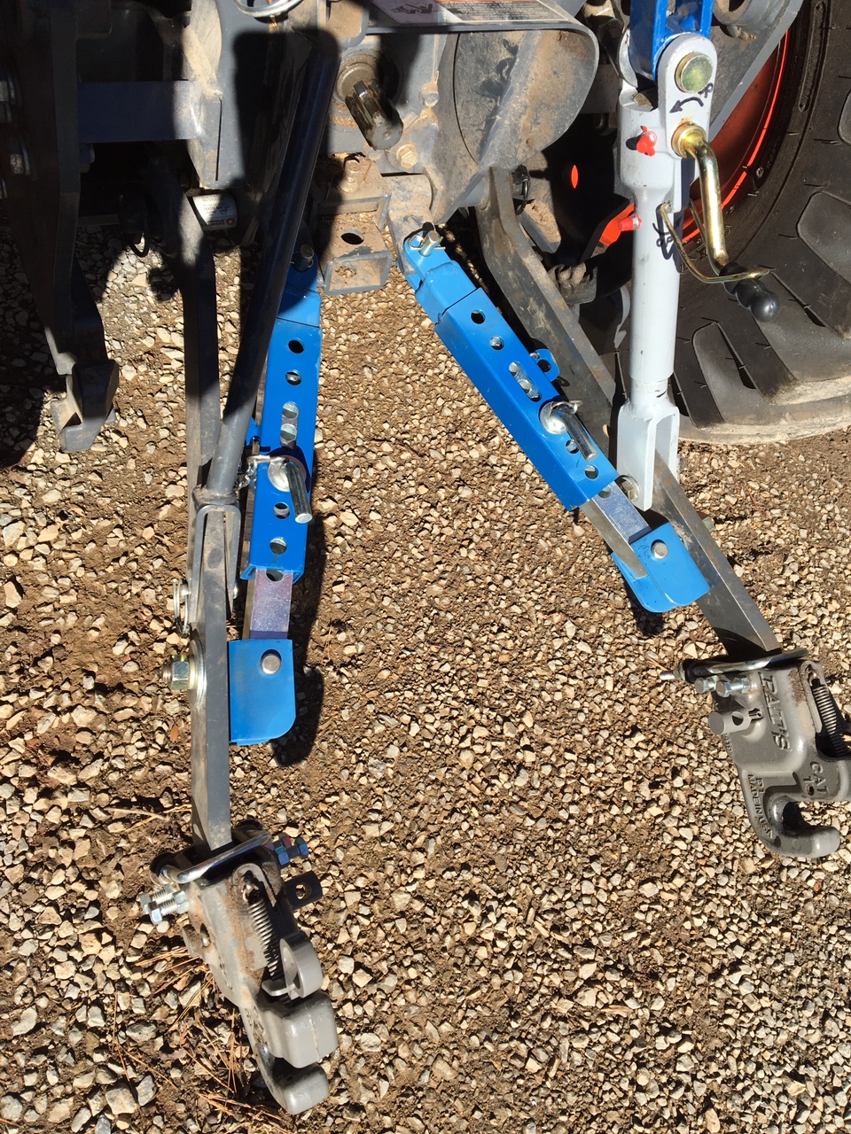

The quick attach adapters in your url appear to be for a front bucket or other implement. Unless you want to put a quick attach implement onto your three point you are probably seeking a quick hitch which is far less expensive than what you seem to be looking at. I use Pat's Quick Hitch on my three point as it can adjust for a wide variety of implement widths. i did get a new drive line for my mower as the original was too short. Actually it was too short for my last tractor, too, I just didn't know it. I also purchased a longer top link. With those two changes I'm quite happy with Pat's.

Some of B-ag tractors may have better 3pt hitch hardware than my B26. Short arms and weak turnbuckles made for poor service and time consuming adjustments. Pat’s Quick hitch fits my older equipment fine and the added length is nice. Pin sway bars and gear leveling box.
