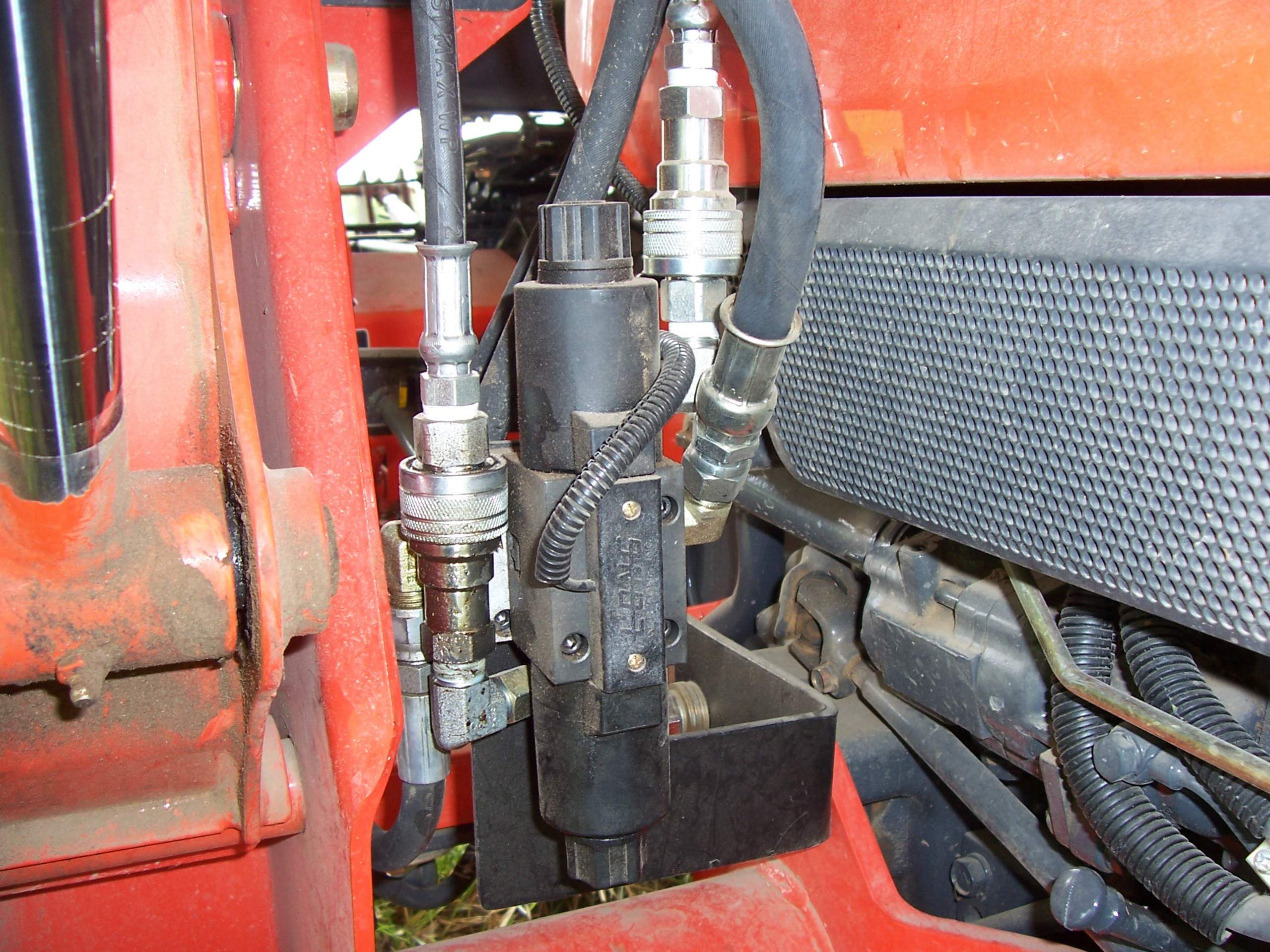

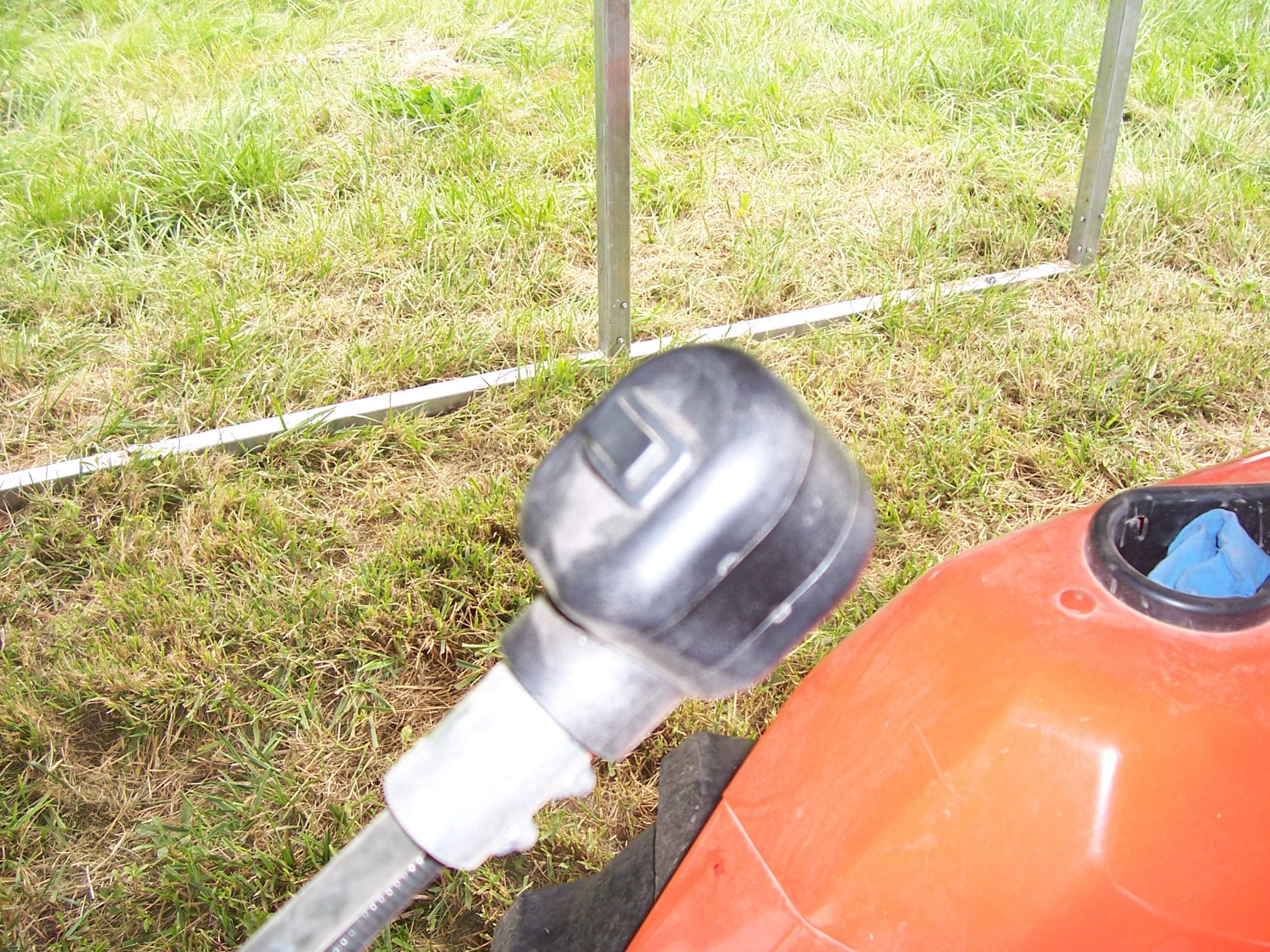

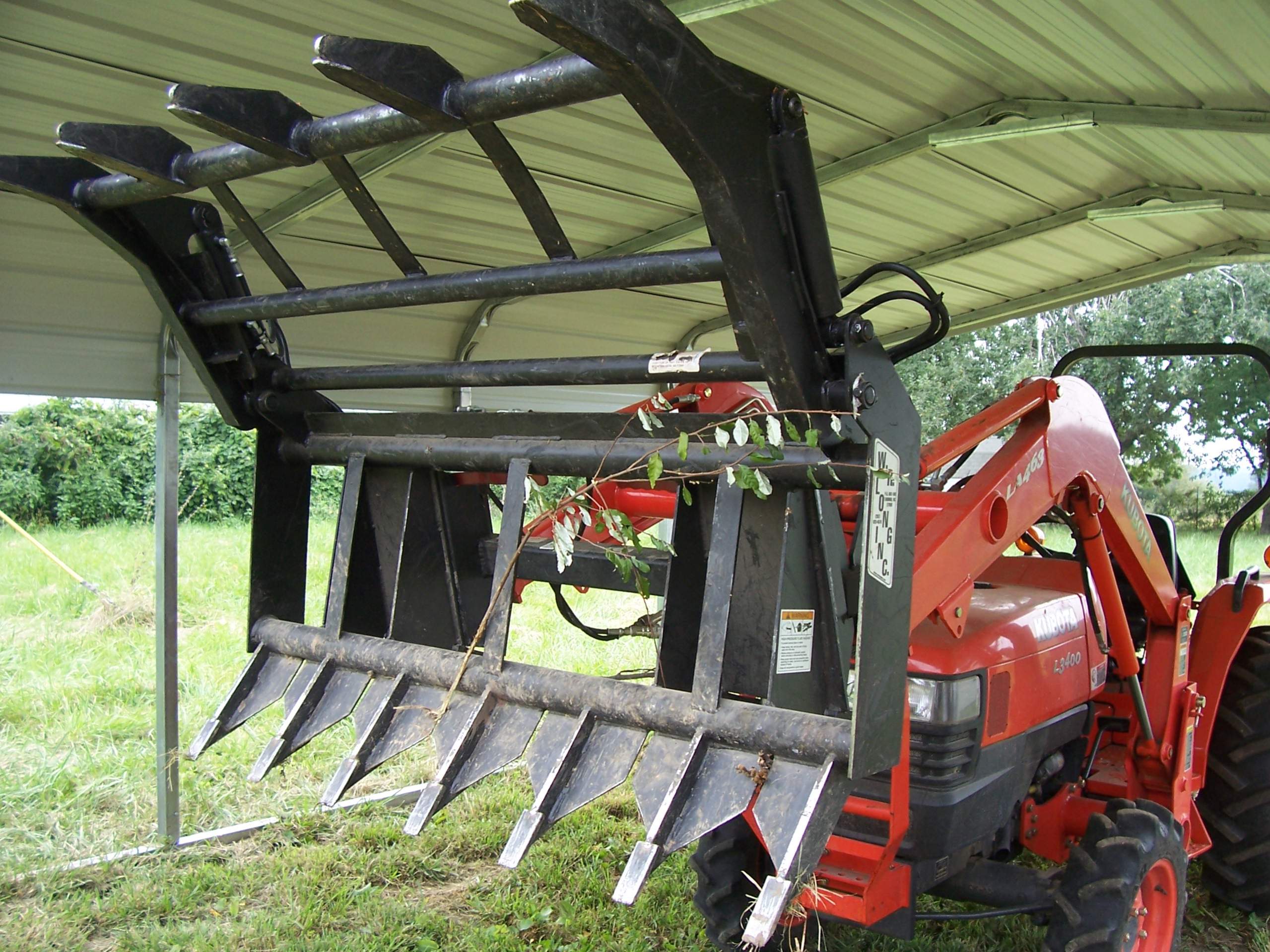

I bought my grapple, valve and replacement joy handle switch from WR Long. Pretty much plug and play.

I have just ordered a WL Long grapple with 3rd function kit. Switch is on the stick and is thumb operated. My Kubota dealer will install it. As I have no plains have any rear operated equipment.......yet!

WOW...Milton, Great setup and a great tractor. :thumbsup::thumbsup:
