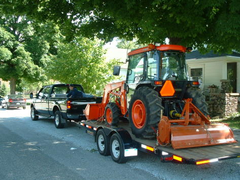

I have a L4330 HSTC and a CCM tiller one size smaller (about 5' ) It has worked great in clay soil. It doesn't seem to load the engine at all. Tilling 5 acres is a snap with mine. It does create alot of dust when it is dry out, a cab really helps clean you clean though.
If I did custom tilling I might get a commercial grade tiller but for 5-10 acres the CCM is fine.

I love my L4330 HSTC! The climate controlled cab is heaven! The hydro is also a blessing. I have owned 17 gear drive tractors, and 2 shuttle shift. I would not trade the hydro for any of them. I do alot of loader work so the LA853 loader comes in handy. The only thing that I would do different is get the 5030 for more HP. I don't have the extra button on the joystick, I currently do not need a grapple. I bought the 5' foot CCM a few years ago when I had a narrower tractor. While this tiller is a few inches narrower than my tread it chews up the dirt a little wider and covers my tracks barely. I can also offset a few inches if I really need too.
