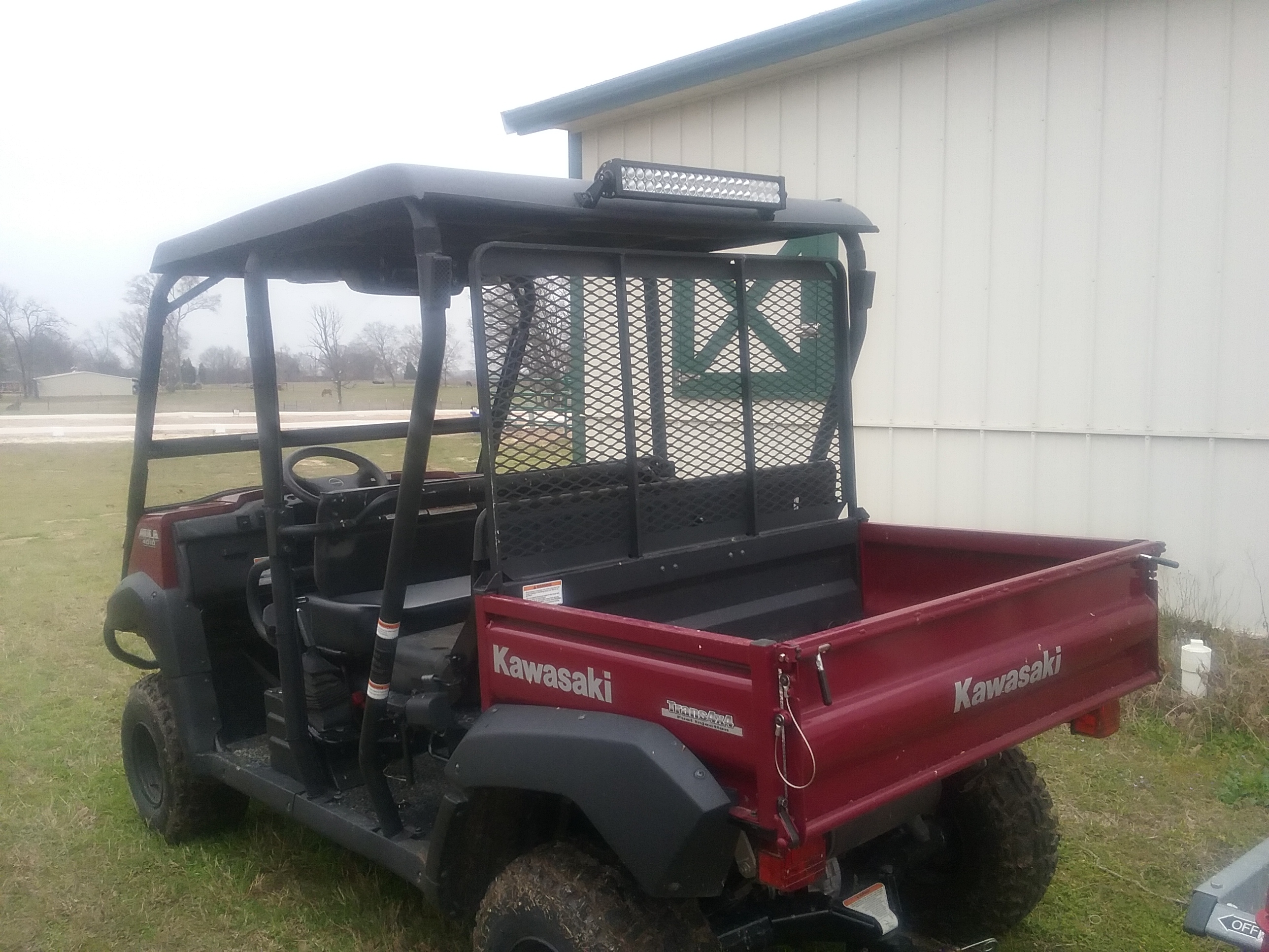

Have a headache rack on both my machines. Well worth the money!View attachment 884674

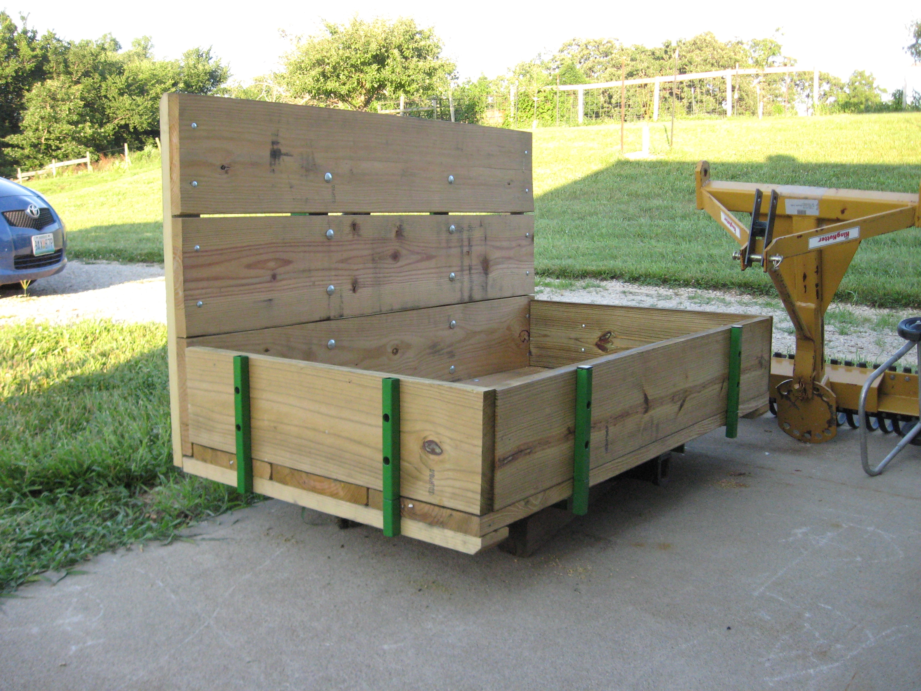

Code54, I notice that the ends of the screws for your tool holders are protruding on the inside of your rack, which can be painful if you accidentally hit them. The way I avoided exposed bolts on my carryall was by drilling holes in the exposed side that are big enough to get a socket into the right size for the nut and then use shorter bolts.
That way, the bolts are inside the tube and not a hazard. The holes aren't really big enough to affect the structural integrity that much. Just a suggestion, but sure has saved my shins and pant legs.
