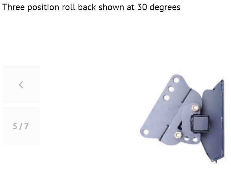

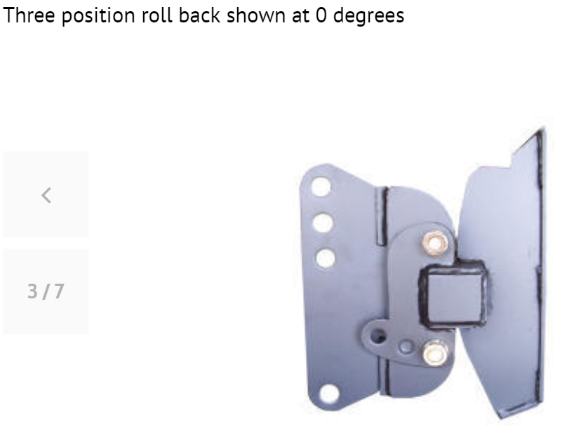

   / Best adapter to convert FEL to quick hitch? #4
This may be more heavy duty than you need, first one I have seen with adjustable rollback: Universal Skid Steer Hitch Adapter w/3 Position Rollback 8297

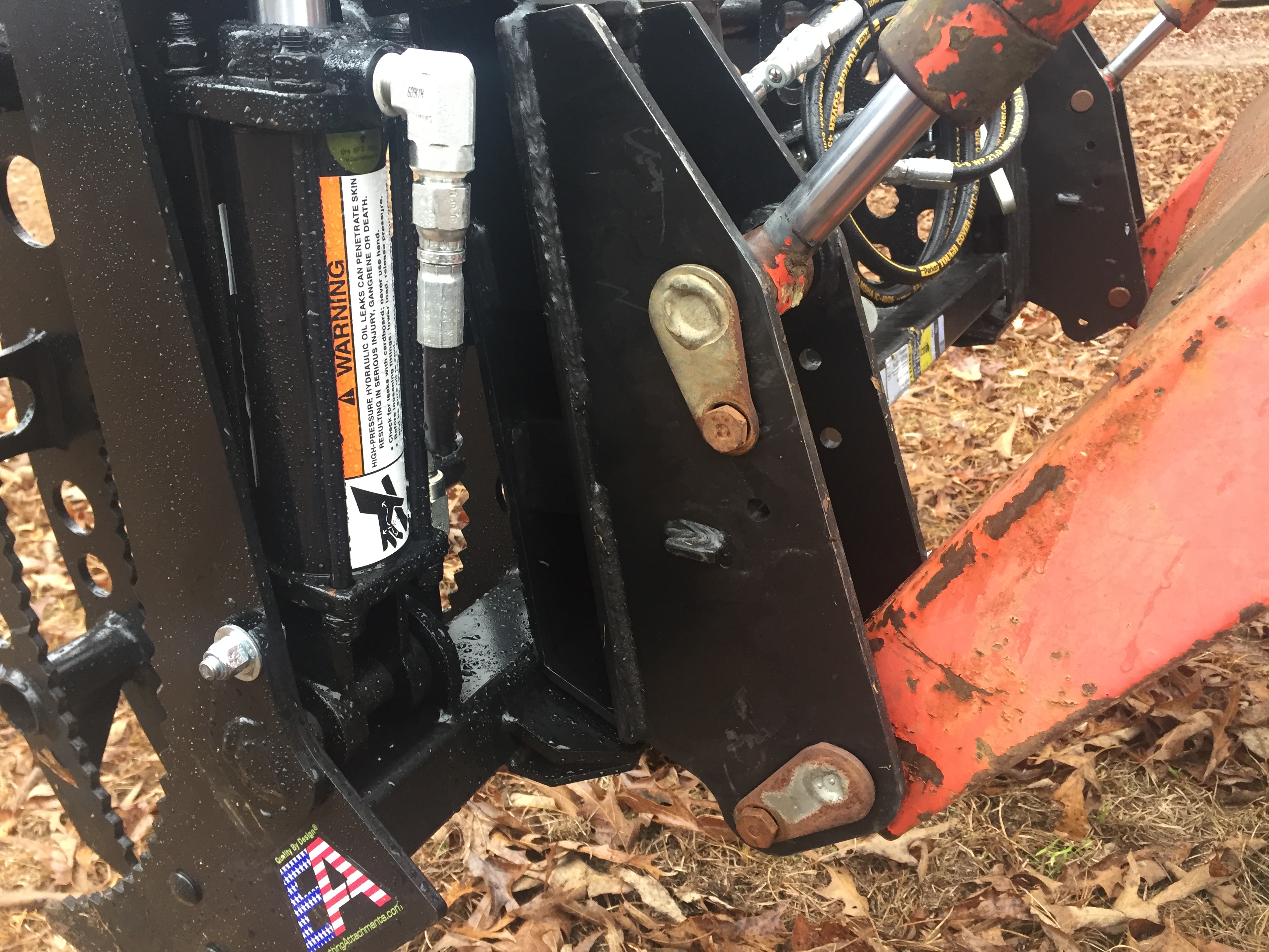

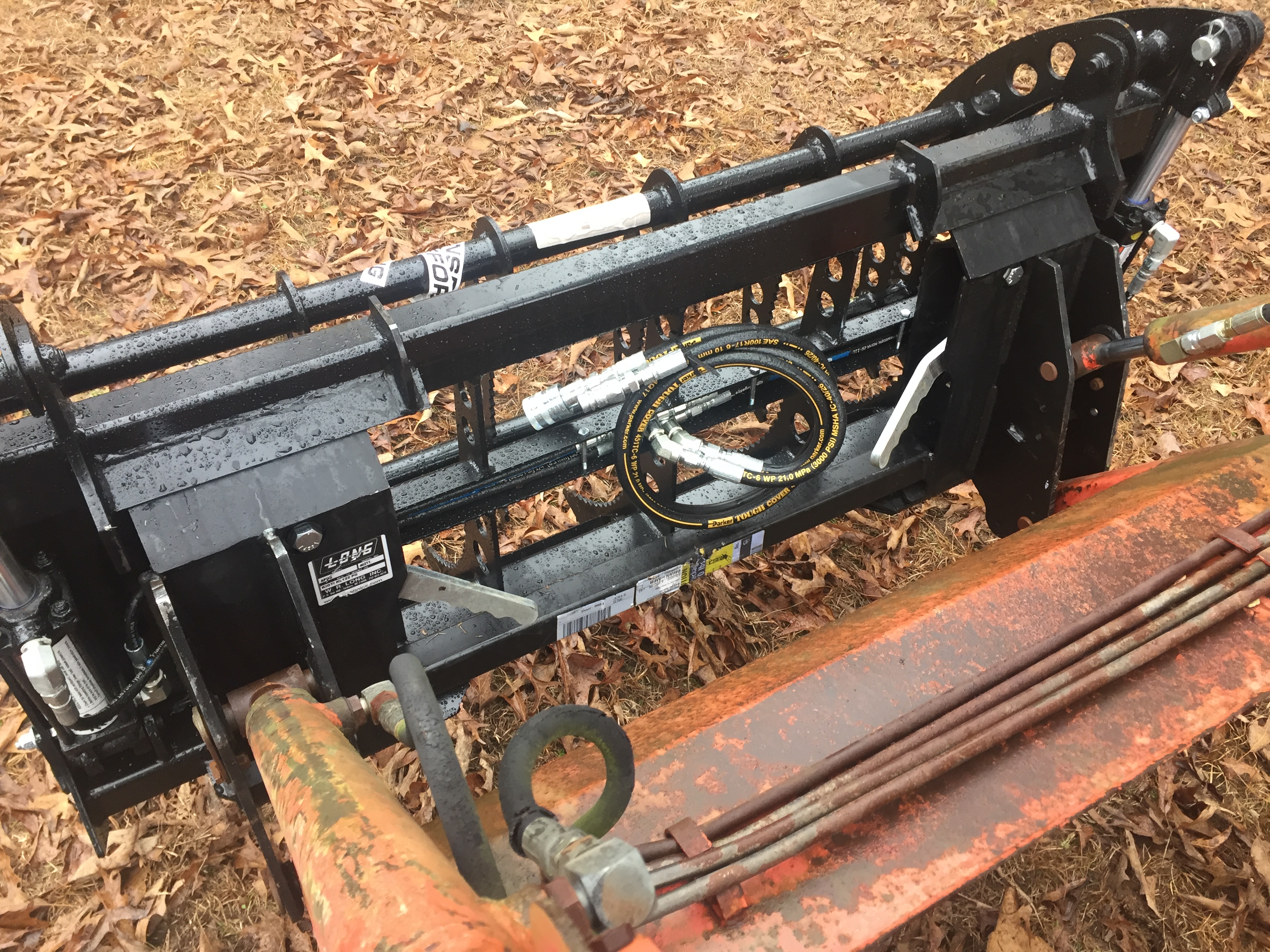

   / Best adapter to convert FEL to quick hitch? #10
I highly recommend the W.R. Long Pin on Tractor Loader Bucket to Universal Quick Attach Adapter. I ordered from Everything Attachments. It took all of 15 minutes to install, perfect fit.
